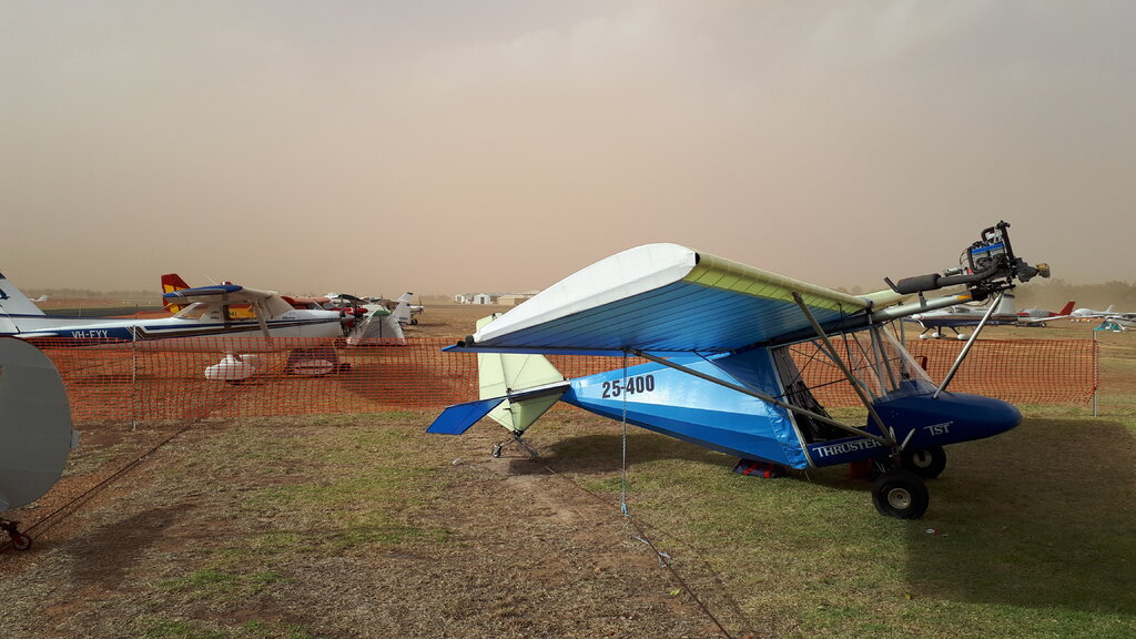

Thruster88 Posted December 26, 2019 Posted December 26, 2019 At Narromine this year I was thankful I had my tail into wind and the cable otherwise I would have been very concerned.
