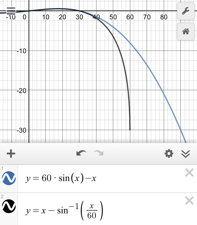

APenNameAndThatA Posted January 3, 2020 Posted January 3, 2020 As you know, the one in 60 rule is that you are off course one degree for every nautical mile you would by off course if you had travelled 60 miles. So, for example, if you are off course one mine after flying 10 miles, you are off course six degrees (6 x 10 = 60). I wondered how accurate the rule is. As far as I can tell, very accurate up until you are 40 degrees off course. Below is what I hope is the graph of the error of the one in sixty rule. The y-axis (up and down axis) is is error. There is no error at zero and thirty degrees. The x-axis is the course. The black line what the one in 60 rule says is how far off course you. The blue line is how far off course you actually are. As you can see, when you are 90 degrees off course, the one in 60 rule says that you are only 60 degrees off course. At about 17 degrees off course, the rule overestimates by about 0.5 degrees. At 40 degrees, it underestimates by only one degree. Amazingly accurate for something that is supposed to be a rule of thumb.

APenNameAndThatA Posted January 3, 2020 Author Posted January 3, 2020 This article needs proof-reading, Ian. The first couple of sentences don't make sense, due to missing and mis-spelt words. As you know, the one in 60 rule is that you are off course one degree for every nautical mile you would BE off course if you had travelled 60 miles. So, for example, if you are off course one MILE after flying 10 miles, you are off course six degrees (6 x 10 = 60). I wondered how accurate the rule is. As far as I can tell, very accurate up until you are 40 degrees off course. Below is what I hope is the graph of the error of the one in sixty rule. The y-axis (up and down axis) is is error. There is no error at zero and thirty degrees. The x-axis is the course. The black line what the one in 60 rule says is how far off course you ARE. The blue line is how far off course you actually are. As you can see, when you are 90 degrees off course, the one in 60 rule says that you are only 60 degrees off course. At about 17 degrees off course, the rule overestimates by about 0.5 degrees. At 40 degrees, it underestimates by only one degree. Amazingly accurate for something that is supposed to be a rule of thumb. 1 1

old man emu Posted January 4, 2020 Posted January 4, 2020 Please post a link to the article that contains this graph /monthly_2020_01/1in60.thumb.jpg.f0269e0e7e609fa29a062baa9bdc4ffc.jpg
Bruce Tuncks Posted January 4, 2020 Posted January 4, 2020 The 1 in 60 rule is only appropriate for small deviations off track. It is good to see this proved mathematically.

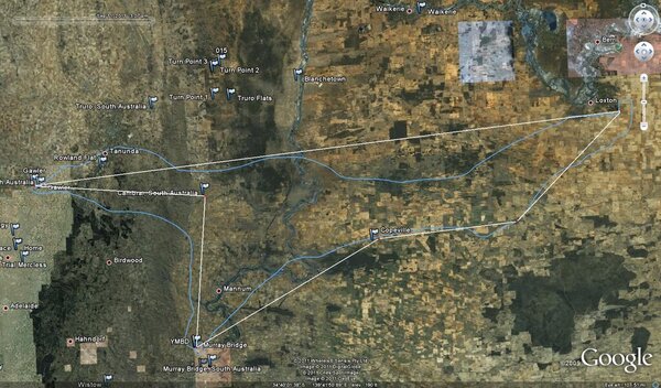

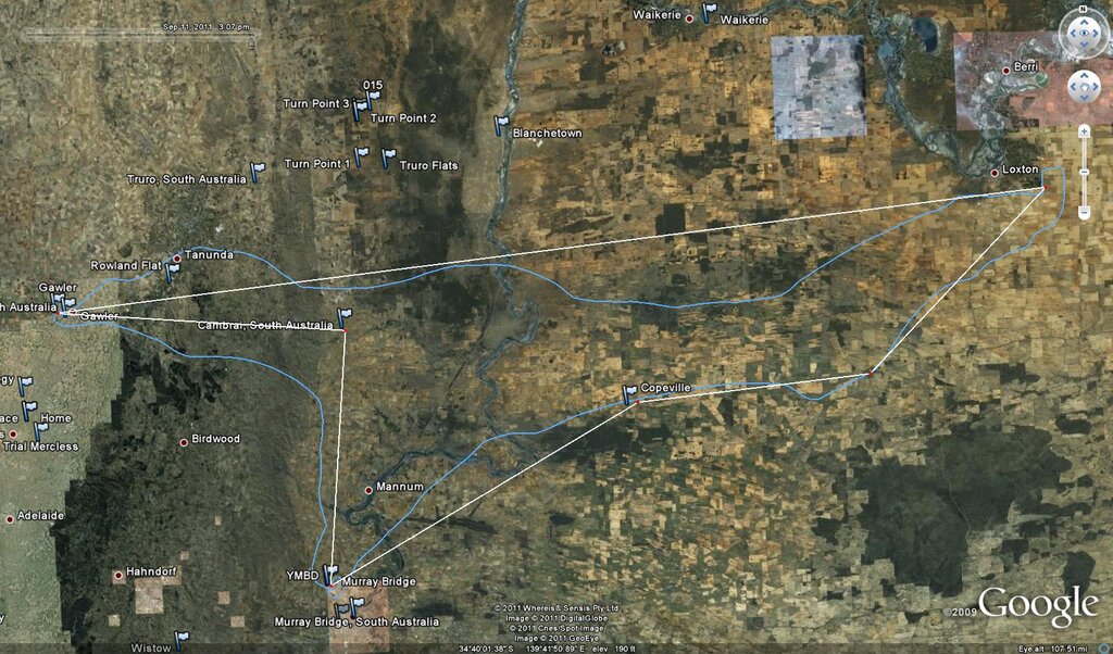

Jabiru7252 Posted January 4, 2020 Posted January 4, 2020 I didn't bother with 1 nm measurements. To fly better than about plus/minus 3 degrees over 60 nm is doing pretty good. Also, without decent ground features to identify the 1 in 60 technique is hard to apply. Here's a track I flew on a wet and windy day. Dodging rain showers made things interesting. The GPS was just logging my track, no display available. Maybe there is no link to the graph, the dude who posted it may have created it himself. I'd like to know what he used as Excel is crap. I use Python for stuff like that.

APenNameAndThatA Posted January 4, 2020 Author Posted January 4, 2020 Please post a link to the article that contains this graph /monthly_2020_01/1in60.thumb.jpg.f0269e0e7e609fa29a062baa9bdc4ffc.jpg The graphic came from an iPhone app called Desmos. It is a cropped screenshot from my iPhone.
APenNameAndThatA Posted January 4, 2020 Author Posted January 4, 2020 The 1 in 60 rule is only appropriate for small deviations off track. It is good to see this proved mathematically. What amazes me is that if you are off track by 40 degrees, the one in 60 rule is still less than one degree inaccurate. 40 degrees off course is a lot. 1
