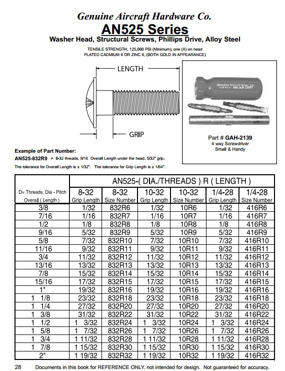

old man emu Posted January 18, 2020 Posted January 18, 2020 I can see 5 threads not into the nut before it has bottomed out. /monthly_2020_01/20200117_103235.thumb.jpg.5003b9018896ddb1ab5748fe624c6176.jpg That's 5/32" plus the grip length of 2/32. 7/32 = 0.71875" Marty says he's fastening two sheets with a total thickness of 0.065". He only needs the grip length of the AN525 to fill the hole space in the two sheets. Then he only needs a threaded length which is enough to go to the bottom of the nutplate. 10R7's are obviously too long since the threaded length is 3/8". A 10R6 has a grip length of 1/32" and a threaded length of 11/32. To use a 10R6 would mean that one thread of the threaded length would be in the hole through the back sheet. That leaves 10/32 (5/16) of thread to go through the nutplate. Until Marty can tell us the length of the threaded section in the nutplate (measured in 1000th's of an inch, none of your poofy French stuff) we can't determine the correct length for anything that he wants to screw into the nutplate successfully.
M61A1 Posted January 18, 2020 Posted January 18, 2020 I can see 5 threads not into the nut before it has bottomed out. /monthly_2020_01/20200117_103235.thumb.jpg.5003b9018896ddb1ab5748fe624c6176.jpg That's 5/32" plus the grip length of 2/32. 7/32 = 0.71875" Marty says he's fastening two sheets with a total thickness of 0.065". He only needs the grip length of the AN525 to fill the hole space in the two sheets. Then he only needs a threaded length which is enough to go to the bottom of the nutplate. 10R7's are obviously too long since the threaded length is 3/8". A 10R6 has a grip length of 1/32" and a threaded length of 11/32. To use a 10R6 would mean that one thread of the threaded length would be in the hole through the back sheet. That leaves 10/32 (5/16) of thread to go through the nutplate. Until Marty can tell us the length of the threaded section in the nutplate (measured in 1000th's of an inch, none of your poofy French stuff) we can't determine the correct length for anything that he wants to screw into the nutplate successfully. Unless he specifically ordered the nutplates with a closed bottom, (and the one pictured isn't) any length screw can be used until it runs out of thread. The screw in the pic is not shanked out and should screw right through. BTW, grip lengths are not measured in thousandths of an inch, but the far more masculine 1/16 or 1/8 This thread is starting to sound like the "How many forum posters does it take to change a lightbulb" thread. 3

old man emu Posted January 18, 2020 Posted January 18, 2020 BTW, grip lengths are not measured in thousandths of an inch, but the far more masculine 1/16 or 1/8 Or even 30tooths. I just used the decimals for easier computation.

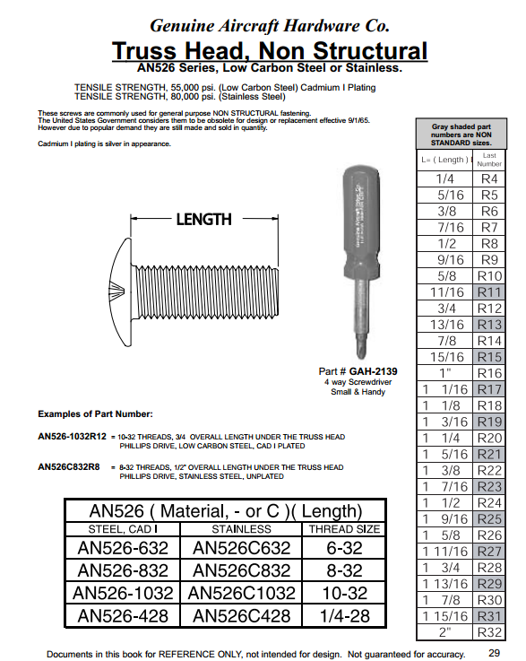

old man emu Posted January 18, 2020 Posted January 18, 2020 This thread is starting to sound like the "How many forum posters does it take to change a lightbulb" thread. I refuse to be LED into that enquiry. Here's the data on the two types of fasteners:

old man emu Posted January 18, 2020 Posted January 18, 2020 Did you mean "LEAD" or "LED", as in Light Emitting Diode? I just can't resist being punny. when the panel is tightened up the screws protrude a good 5mm beyond the end of the nut plate. A good 5 mm is 3/16", or so. That means that you have nearly as much thread gone through the nut and out the other side as is inside the nut doing the work. The nuts might be open-ended, but they are also oval so that the nut gets a good grip on the screw. By running the screw as far as you have done, you are rounding the oval and reducing the holding ability of the nut. You are giving the screw the chance to loosen with vibration, although in this location you will notice it and can access it easily for re-tightening. If a 10R7 has an overall length of 7/16", and you have about 3/16" protruding from the bottom of the nutplate, then I suggest you buy some AN526-1032R4, or even R5 screws to use with those nutplates. Length of R4 is 1/4" and R5 is 5/16" AND PLEASE STOP USING THE METRIC SYSTEM WHEN MEASURING AN, MS, or NAS HARDWARE. ?
M61A1 Posted January 18, 2020 Posted January 18, 2020 By running the screw as far as you have done, you are rounding the oval and reducing the holding ability of the nut. That's what they are designed to do. That is how they lock. Generally it is accepted that a screw is "in safety" when at LEAST 2 threads protrude through the nut. If I was supervising/ or inspecting a job where the tradie had screws that didn't go all the way through, he would be replacing all the short ones with the correct length fastener before anything got signed. I agree that it is desirable to use one system or the other. I currently work on metric aircraft, and as far as rivets go, most of them are just standard rivet sizes but labelled in metric, but many are still imperial part numbers. it's damn annoying having a hybrid system. All the screws though are metric.
