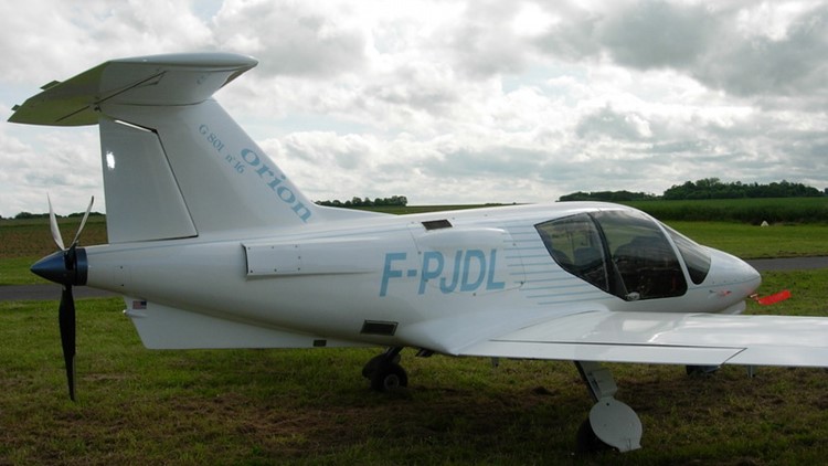

Here's another tail prop design - the Grinvald G.801 Orion.
