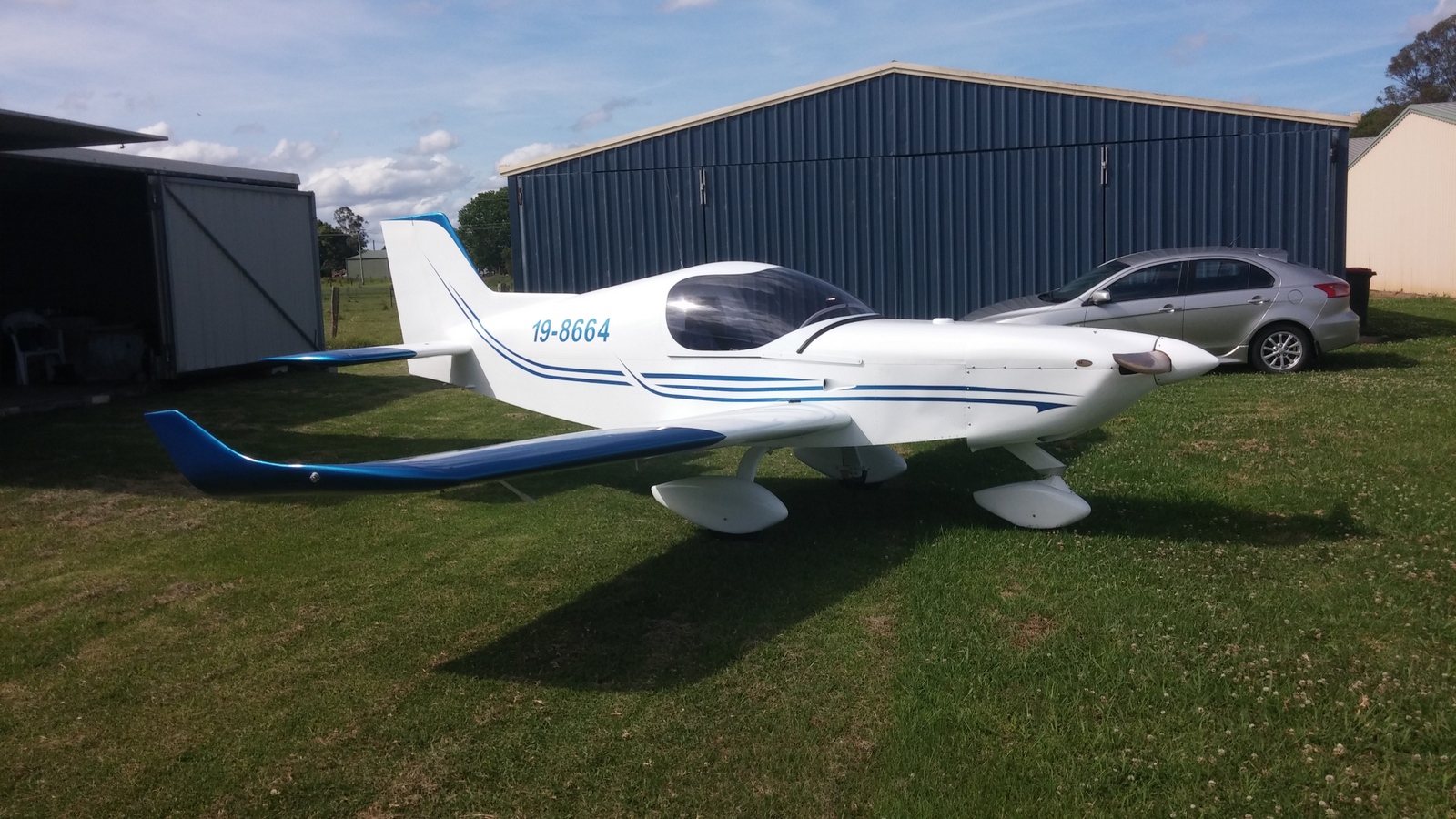

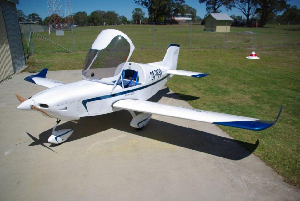

myshed2 Posted March 1, 2020 Author Posted March 1, 2020 Yeah kg you are right. The simple things. There is probably a comercial spark plug tester available but I am going to make one from an old car ignition coil. Will sure save a lot of plug lead pulling and engine starting to find a dud plug especially in your case with 12 of the mongrels. Going by your photo I believe we have the same aeroplanes albeit yours has 6 more cyclinders. Sierra's rock. Mine attached before it was registered 19-****
kgwilson Posted March 1, 2020 Posted March 1, 2020 Yeah, 12 brand new plugs & 1 is a dud. Well I hope that is the case anyway. I remember your aircraft. I flew it on 13th of April 2011 with Garry Morgan before I bought my kit & decided on the 6 cylinder engine at the end of May that year. Garry's kit was really the supply of plans and materials but that meant it was a complete build from scratch not just assembly as most kits are these days. I spent over 4 years building but also built a hangar and made lots of house alterations in that time as well. I did everything including painting & I'd never spray painted anything before. Landing took a bit to master & I broke a prop. Now I can almost land it blindfold. I love mine and its excellent performance yet its stall speed 1 up is 32 knots full flap. Similar colour scheme too. The metallic blue Dulux FX paint cost $450.00 for the minimum 4 litres & I used less than half of it. 3
