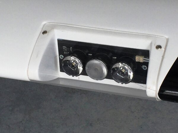

Lookup the local Aussie company Flyleds at Flyleds – Lighting kits for Van's RV aircraft I experimented with off-road LED lights and they produced intolerable radio/intercom interference. I fitted these to my Arion Lightning for a fraction of the cost of what you see coming out of the US (see attached pic). Wigwag option is available too, with about 8 patterns to choose from.
