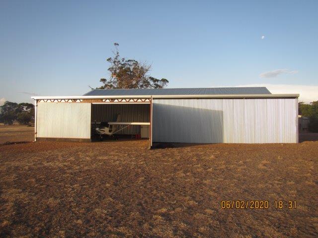

Farmpilot Posted February 5, 2020 Author Posted February 5, 2020 Thanks for the warm welcomes everyone! I am happy to post a photo or two Alan but not sure if i need to resize them before i do? I can email them to you if you are happy to pm me your email address. I dont want to slow down the site with a massive upload... Is there a instruction page for computor illiterates?? I built my hanger by extending a machinery shed and enclosing half of it. It has a dirt floor and I put some conveyer belt down wide enough for the wheels to run on. A bit rough but it works. Its a bit hot over here a the moment to fly much as I'm still a bit nervous when it gets bumpy plus I fly for fun, not to get bounced around. Monday looks a bit cooler so i will see if my instructor is free to start x country training. I love the early mornings when its silky smooth. 2
Farmpilot Posted February 6, 2020 Author Posted February 6, 2020 Hi Alan, This is a photo of my hangar, (well I hope it comes out that way when I click 'Post reply'!!!) I used 7 x 8m x 300mm Hopleys trusses, I made the front truss out of 75 x 2 SHS and 50x3 SHS, 15015 Zed purlins and 100x3 galv SHS uprights. It is 10m wide (Savannah is 9.2m) 3m high (Savannah 2.6m) at the doors and 8m deep (Savannah 6.7). Only just big enough for the Savannah but its what worked... I made the doors 5m wide and they swing out and hold open with chains welded to star pickets belted into the ground. A bit hard to open in any winds over 15 knots but that is OK as I don't want to fly then anyway.

Old Koreelah Posted February 6, 2020 Posted February 6, 2020 ... I made the doors 5m wide and they swing out and hold open with chains welded to star pickets belted into the ground. A bit hard to open in any winds over 15 knots but that is OK as I don't want to fly then anyway. Morning Dean, just catching up with your posts, which are very impressive. You seem to have a very positive attitude to this flying thing. Two points: as you've noticed, vertically-swung hangar doors don't like much wind. Even a relatively light breeze can keep many of us without sliding doors from going flying. We have bifold doors and I once opened one without checking the windsock and was thrown 5 metres. I suspect more pilots are injured by hangar doors than by aeroplanes. When you find some spare time, you might create your own personal avatar. Perhaps a pic of your plane or something unique to you or your area, even a small map. Just click on the big F above "Farmpilot" and then select "edit". You can then download the image of your choice and zoom it in or out, centre it and then set it in concrete.
Farmpilot Posted February 23, 2020 Author Posted February 23, 2020 Thanks everyone for the advice, encouragement and welcomes. red750 I hope the photo I posted was ok in size and format. Old Koreelah I was a bit lazy in not making sliding doors for my hanger, I made them for my workshop but the opening for that is 15m x 5m high and has to be opened in any weather!! I will create an avatar one day as well. Thanks for the instructions how to do it.
