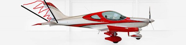

M61A1 Posted February 19, 2020 Posted February 19, 2020 They look schmick....but you can see at a glance that rudder design is likely to kill you if you make a mistake.

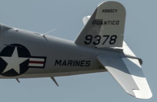

facthunter Posted February 20, 2020 Posted February 20, 2020 Only larger planes have CVR's and FDR's. Before you react IF you are the "Authority" you need to have a fair amount of good "evidence". (Generally) To digress slightly I don't think the Jabiru fiasco achieved that and they got a certain amount of egg on their faces. not before a lot of damage was done. . Regarding styled "plastic fantastic" the fin and rudders look more for style than best function. ie Look good on a desk as a model. Even the Mustang ended up with a dorsal fin as did many designs. The horizontal stab and elevators can shield the fin and rudder in a spin situation. THAT problem is not new.. Nev 2
