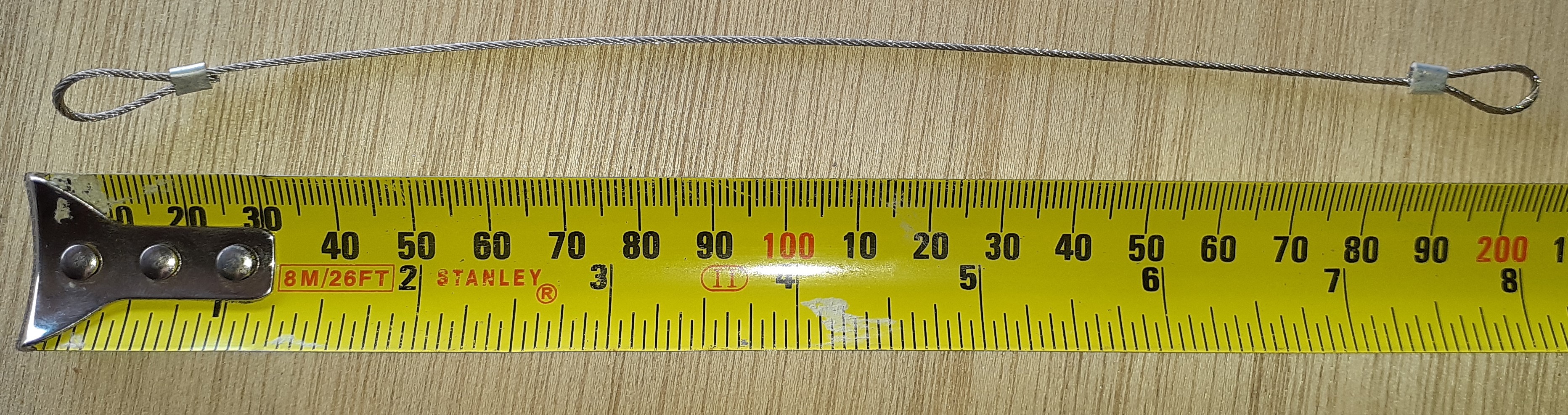

Here is another "whats this" (the cable not the tape!) found in the hangar today and have no clue what it is off.
Good thing is, that it doesn’t look used or broken. But I would always wonder until I found its home.
Looks to me like a wire saw without the finger rings.
It sure doesn't look robust enough to be any part of an aircraft.
It doesn't have to very robust to save your plane; I made up something similar and looped it around my carby, then fixed the ends to my firewall.
The theory is that if I hit a bird and my prop is damaged, it could become sufficiently unbalanced to rip the engine from its mounts faster than I could shut it down.
I've read that Rotax carbs are not clamped to their rubbers so that they are dislodged by wild engine vibrations, automatically cutting off their fuel.
