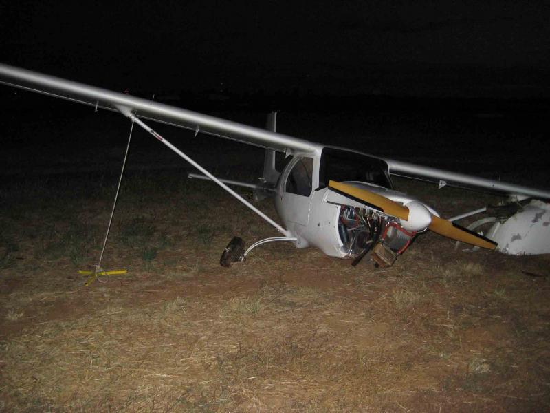

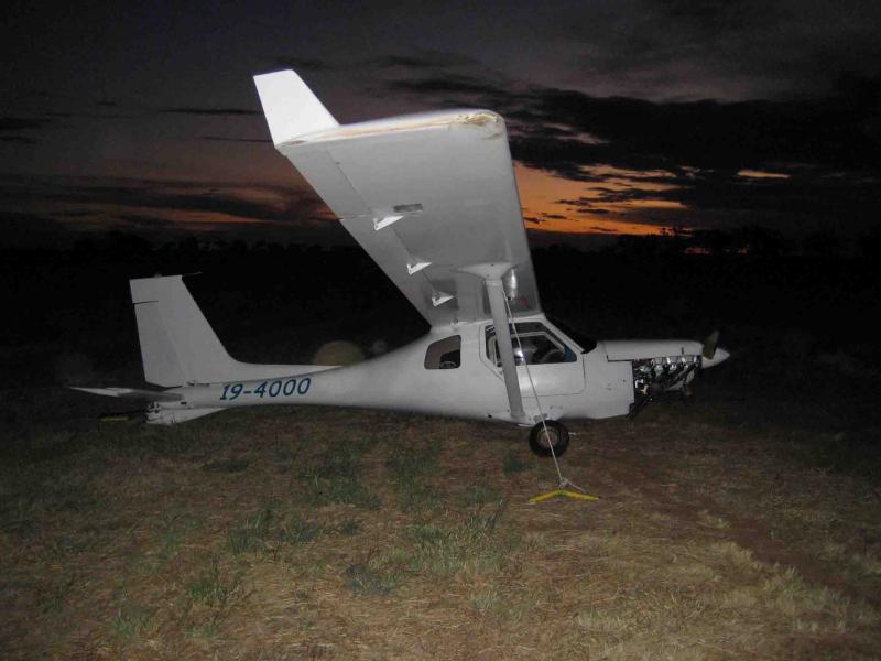

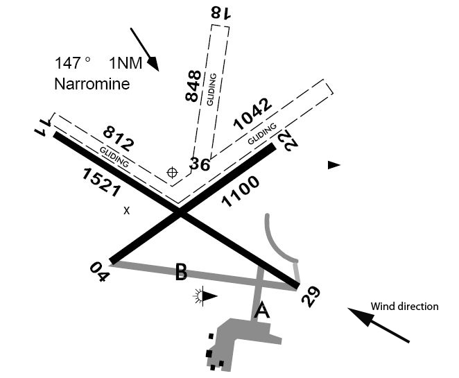

Guest airsick Posted March 27, 2008 Posted March 27, 2008 Unfortunately on the NatFly weekend just gone there was an incident involving a Jabiru (Paul Middletons I believe however cirrect me if I am wrong). I have heard a couple of descriptions as to what occurred so rather than speculate as to which is correct I will simply describe the events of the two most likely (in my mind) and let others who have more information add to it. Facts: At the time the runway in use was 11 with the wind strong but favourable for this strip. The aircraft, when I came across it, was on the south west of the intersection of runway 04 and 11 (see X on attached diagram). The damage to the aircraft is quite extensive. There is what appears to be a fracture around the tail boom (hard to see but visible near the lens flare in img_1996 attached) and some ripples along the top of the right wing. The landing gear is completely collapsed on the left side and on the right side seems to be 'splitting'. The tail wheel was separated from the aircraft. The engine cowl had been ripped off in the impact and there appeared to some damage to the engine. Interestingly the propeller appeared to be completely unscathed suggesting the engine wasn't running when the aircraft impacted. Scenario 1 The aircraft was using 11 and was past the threshold when a gust of wind caused the aircraft to roll to the right and pushed it south of the runway onto the grassed area. The right wing tip struck the ground and spun the aircraft almost 90 degrees to its intended track. The aircraft then struck the ground while travelling parallel to runway 22 and further spun to be facing a westerly direction before coming to rest in the location described above. Scenario 2 The aircraft was doing cross wind circuits on runway 22 (grass or sealed) and could not sufficiently compensate for the amount of wind present. The aircraft was pushed west and crossed the runway 11 west of the intersection. The aircraft then struck the ground, spun to the right by 90 degress and came to rest as described above. At some point the right wing tip also struck the ground. Engine failure? A third, and entirely speculative scenario, is engine failure. I noticed that the propeller escaped the incident without a scratch. If it was turning when the aircraft hit the ground then I would have expected that there would be signs of a prop strike such as dirt on the blades or something similar. Being a wooden propeller I am amazed it didn't just shatter on impact. To me this hints that it was in the horizontal position prior to impact. I want to stress that this is purely speculation based on my observations of the aircraft post accident. Observations The ground was quite soft around the runway edges and the aircraft was a considerable distance from any strip so it must have had a fair amount of momentum to keep it going after the undercarriage dug in. The location of the aircraft places it quite some way from runway 11. If landing on this runway I would have thought momentum would carry it along the runway more so than perpendicular to it. The skids marks are almost at right angles to the strip so this seems a little strange. Having said this... There was quite a bit of circuit traffic during the day and it was quite breezy so it wouldn't seem sensible to be doing cross wind circuits. Scenario 2 seems a little less likely given this. Can anyone confirm the circumstances surrounding this accident? Can someone confirm if it was Paul Middletons plane? The rego is 19-4000 so this shouldn't be too difficult.

Captain Posted March 27, 2008 Posted March 27, 2008 The facts will come out. I and another couple of blokes were watching the entire episode and within the normal limits of human recall, here is what I saw. There were 2 or 3 aircraft waiting to depart on 11 and a Jabiru was on final for 11. The wind was pretty well down that strip, it appeared to be the best strip to use and it had been the active runway for some time. As the Jabiru was about to flare, the wind changed to a good 20 - 25 knots of cross-wind and it blew like that for about 5 minutes, before going back to 11. With the wind the way it was, even that great (sky) pilot JC himself would have had a hard time landing ...... not to mention that his dad the CFI would have also been working hard to keep it under control. The timing of that wind change could not have been worse for that aircraft. It got under the wing, the pilot tried to correct & continue his landing, then he appeared to add power to try to go around and unfortunately turned downwind, almost caught it, lost it again, almost caught it again, touched a wing-tip at 60 - 70 degrees of bank and the rest is history. It was much more than a ground loop, but there but for the grace of god go all of us if a sudden & totally unexpected 90 degree wind change (the strength of which is well above the limits of the aircraft) happens while you are flaring. I have no idea whether it would have been better or worse with a trike undercarriage, but I do know that it blew bloody hard cross-wind during the incident.

Guest Ken deVos Posted March 27, 2008 Posted March 27, 2008 The wind was pretty well down that strip, it appeared to be the best strip to use and it had been the active runway for some time. As the Jabiru was about to flare, the wind changed to a good 20 - 25 knots of cross-wind and it blew like that for about 5 minutes, before going back to 11. Very unfortunate accident and thankfully no injuries. I concur with captain about the wind conditions.

vk3auu Posted March 27, 2008 Posted March 27, 2008 A friend and I went out around 10 PM and had a fairly good look at the results using torch and moonlight. I didn't notice the damage around the tail, but overall, considering the distance that it finished up from the strip, I thought it demonstrated that the construction was fairly robust. I also thought that the lack of propellor damage was remarkable, although the fact that it was a tail-dragger helped, even though the gear had collapsed on the left side. If I may make a couple of comments regarding pilots with low time on their new aeroplane. It is prudent to spent considerable time using a gravel strip, rather than a sealed strip, when learning to land your tail-dragger. Ground loops on bitumen can be very nasty, whereas on gravel, quite controlled ground loops are possible. Some tail-draggers are not actually under control until they are parked, and I believe this applies to Jabirus, even when flown by ex-airline pilots/instuctors. David

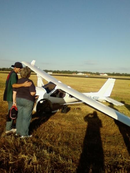

quentas Posted March 28, 2008 Posted March 28, 2008 The aircraft looks as though it could be up and flying again in no time for a few thou. Testament to the Jabs strong build and quick local turnaround of parts. Maybe we could `pass the hat around` for him to get it fixed. I have learned a lot from him over the years and have always enjoyed his writing ways, its the least I could do.
Guest airsick Posted March 30, 2008 Posted March 30, 2008 The aircraft looks as though it could be up and flying again in no time for a few thou. If you saw it first hand I think you would have a different view. The fuse was fractured around the tail boom, the wings were wrinkled, I'd imagine there would be some substantial damge to the underside. Just my opinion but I don't think it is repairable. Even if it was repaired I would have so many doubts about it that I certainly wouldn't be getting into it. Maybe we could `pass the hat around` for him to get it fixed. With all due respect why? I don't know the guy so I won't pass judgement on him but isn't this what insurance is for? I will gladly pass the hat around for those who come into some bad luck which is completely beyond their control (think illnesses such as cancer for example) but if someone has a plane and doesn't see the need to insure it then I certainly won't be there to pick up the pieces for them. I don't know whether he had insurance or not but if he didn't see the need to cover himself then I for one am not going to bear the risk for him. I extend my sympathies to him for losing his pride and joy, I hope he is well and got out of it relatively unscathed (along with any passengers), I hope he goes on to fly another day, but I also hope that he truly is a good guy and recognised that flying can be risky and was appropriately prepared.
TechMan Posted March 31, 2008 Posted March 31, 2008 If you saw it first hand I think you would have a different view. The fuse was fractured around the tail boom, the wings were wrinkled, I'd imagine there would be some substantial damge to the underside. Just my opinion but I don't think it is repairable. Even if it was repaired I would have so many doubts about it that I certainly wouldn't be getting into it. I had a look at it, and whilst there is a lot of work to be done, it is a fairly simple repair. Is it worth it? Well, it would be for someone who has just spent 4 years or more building it. Is it viable? It would be for a professional repairer if the wreck could be purchased cheap enough. As for the owner, the question of how much money to throw at it, compared to selling the aircraft as is and putting the money spent on repairs towards a second hand aircraft and just going flying as quickly as possible would come into consideration, though then you are purchasing someone else's problems which may cost more to fix in the end. As a side, the aircraft will be repaired, so I guess that answers the decision made. Chris
