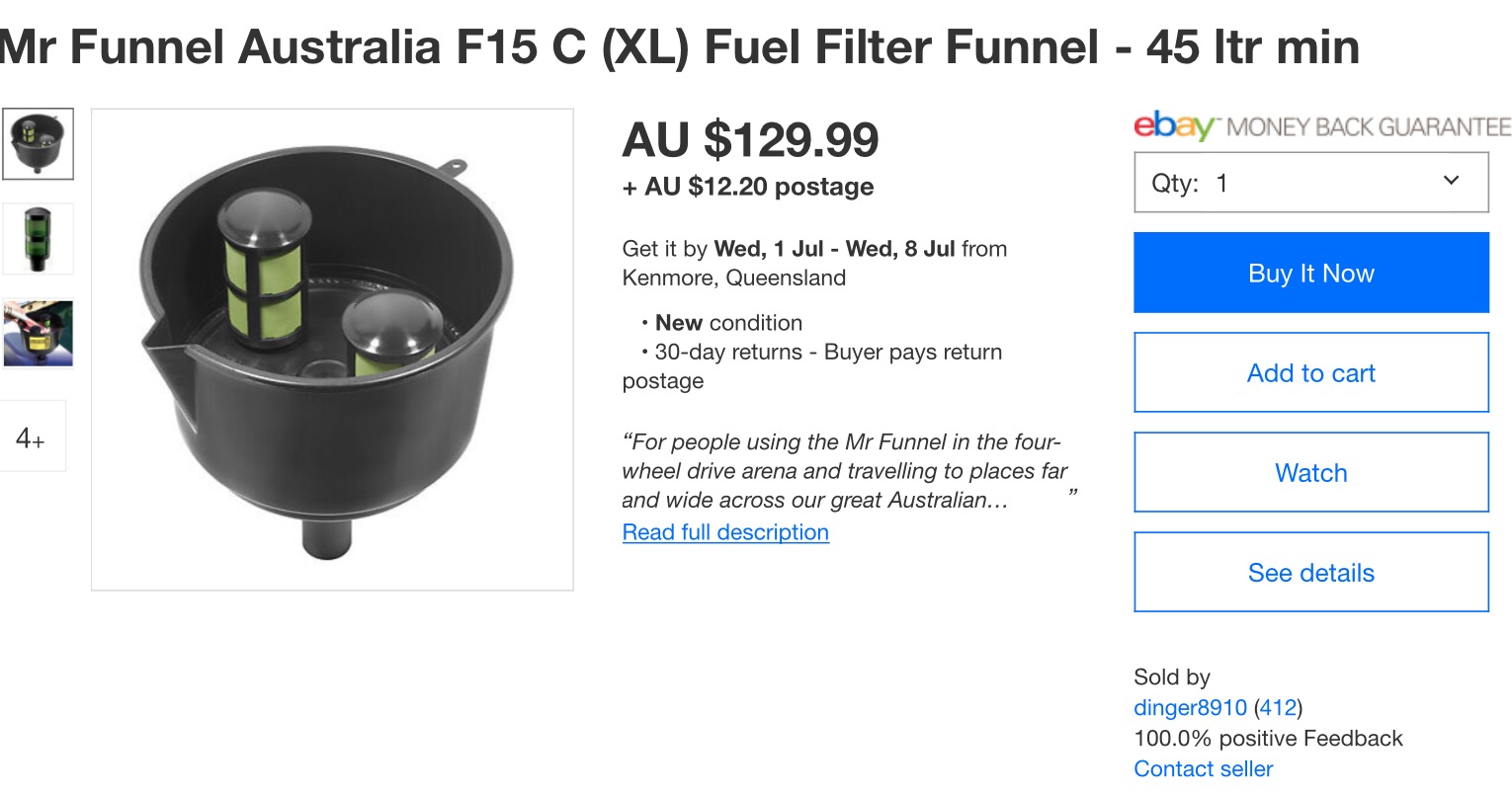

Exactly!?Combine the use of ULP AND this funnel means I sleep like a baby???

It is a matter of choice and availability. The nearest Avgas facility to me is a 40 minute flight and $15.00 landing fee. I don't like the lead or the deposits left in my engine by Avgas despite it having a measure of quality control better than Mogas. I used to use BP 95 Mogas by choice and of course availability but the availability has now disappeared with the local BP stations no longer stocking it having replaced it with an ethanol blend 94. I use 98 Premium Mogas exclusively which provides the same power at least as Avgas, is much cleaner burning with no lead and I have not had a quality issue in 5 years. I always filter it through my Mr Funnel & have never found a speck of dirt or moisture. The only possible issue as far as I know is vaporisation and that is generally confined to above 10,000 feet where I don't go & even then I have an electric fuel pump directly below the main tank which will push liquid fuel through should there ever be any vaporisation.
