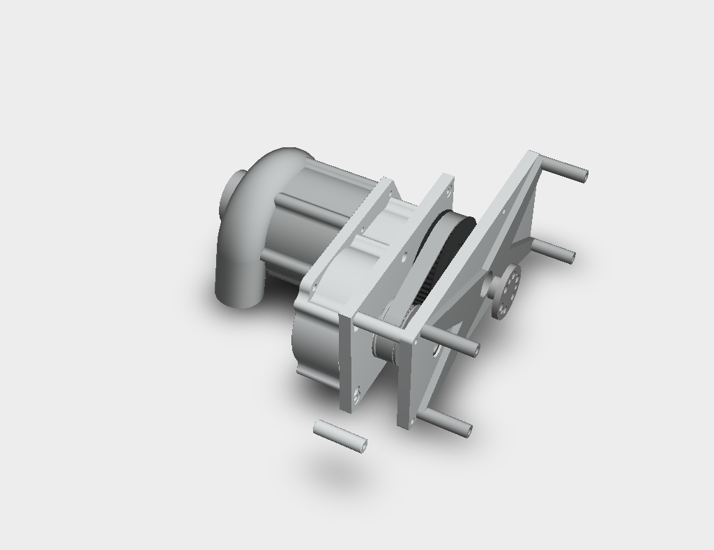

Mhalc Posted July 6, 2020 Posted July 6, 2020 Bruce Tuncks said: Be very aware of the weight of the new prop Mhalc. In addition to the weight of the CS prop, I am adding an additional 9.5lbs to the back of my Gen 4 3300. I have worked out the design, and started fabrication of a supercharger mount and drive assembly. I hope to complete the mount/drive assembly and start testing on a test stand in the next few weeks. 1

Bruce Tuncks Posted July 6, 2020 Posted July 6, 2020 Wow Mhalc, this might be the first supercharged Jabiru. It sure will be interesting to see how it goes. Good luck with the project. I know of a guy who daydreamed of just such a thing when he was at 14,500 ft and his Jabiru ran out of puff. 1

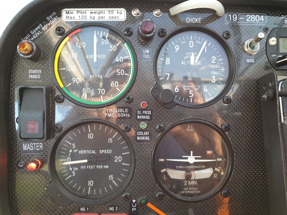

Blueadventures Posted July 6, 2020 Posted July 6, 2020 Old Koreelah said: Bruce I'll be installing an LED near my key to show when the starter is getting juice. I have an automatic battery isolator near my right knee. A weighted lever connected via a wooden rod to the battery's earth pole; any sudden forward or downward acceleration disengages the power. I have on a long flight accidentally disconnected the battery by hitting it with my knee; no drama, engine keeps going, just a few instruments drop out. Hi OK and BT this is where I mounted my LED (Towards top left of image - Amber) and its a push to test as well, worthwhile addition as if ever the starter remains engaged it will over heat (usually destroy themselves) and suck the battery dry (usually damage or destroy the battery) and therefore usually results in cost and maintenance to starter and battery etc. Rarely happens; but has and does so the LED will prevent the inconvenience and costs). 2 1
Mhalc Posted July 6, 2020 Posted July 6, 2020 Old Koreelah said: I dimly remember a videoclip from the US of a bloke installing a turbo on his 3300 Jab engine. I tossed around the turbo idea for my Gen 4 3300, but the exhaust heat added under the cowling and exhaust back pressure/heat on the valvetrain lost out to the simpler supercharger. I did add a twist, an electrically controllable blow-off-valve and small controller to provide variable (user defined) boost profiles. Very much like a turbo-normalized engine without the excess hear under the bonnet.
Mhalc Posted July 6, 2020 Posted July 6, 2020 Bruce Tuncks said: Wow Mhalc, this might be the first supercharged Jabiru. It sure will be interesting to see how it goes. Good luck with the project. I know of a guy who daydreamed of just such a thing when he was at 14,500 ft and his Jabiru ran out of puff. Thanks for the well-wishes. As an engineer I know the devil is in the details, BUT the proof is in the testing. Where I fly in the southwest US I climb to 9,000’ or more to go on any x-country to get over the mountains.

horsefeathers Posted July 23, 2020 Posted July 23, 2020 Blueadventures said: Hi OK and BT this is where I mounted my LED (Towards top left of image - Amber) and its a push to test as well, worthwhile addition as if ever the starter remains engaged it will over heat (usually destroy themselves) and suck the battery dry (usually damage or destroy the battery) and therefore usually results in cost and maintenance to starter and battery etc. Rarely happens; but has and does so the LED will prevent the inconvenience and costs). Hey Bluead Any chance of posting a simple mudmap (hand drawn would be fine) of your led circuit please?
dlegg Posted July 26, 2020 Posted July 26, 2020 Mhalc said: I tossed around the turbo idea for my Gen 4 3300, but the exhaust heat added under the cowling and exhaust back pressure/heat on the valvetrain lost out to the simpler supercharger. I did add a twist, an electrically controllable blow-off-valve and small controller to provide variable (user defined) boost profiles. Very much like a turbo-normalized engine without the excess hear under the bonnet. If going down the blown engine route you will need to entertain the idea of fuel injection. That bing simply won't do the job. Then of course you will have excess heat to take care of. Your electrical system will have to reflect the changes, Rotec make an alternator mount and pulley for the jab. I wish you well on your endeavour.
Blueadventures Posted July 26, 2020 Posted July 26, 2020 horsefeathers said: Hey Bluead Any chance of posting a simple mudmap (hand drawn would be fine) of your led circuit please? Connect the LED positive wire the solenoid terminal that supplies power to starter. Other to ground. That way one when starter circuit energised it will be lit. If you use a push to test type lamp same plus the push to test connect is wired to a 12 volt source. Cheers
Mhalc Posted July 26, 2020 Posted July 26, 2020 dlegg said: If going down the blown engine route you will need to entertain the idea of fuel injection. That bing simply won't do the job. Then of course you will have excess heat to take care of. Your electrical system will have to reflect the changes, Rotec make an alternator mount and pulley for the jab. I wish you well on your endeavour. As for the fuel injection/electronic ignition I wanted to preserve the Jabiru’s traditional aircraft engine approach with fixed timing simplified fuel delivery. I do have an AeroCarb and Rotec TBI which I plan to test with in addition to the Bing. The AeroCarb being only 35mm will be the least likely to keep up with the ~220CFM boosted flow rate, but the Rotec and Bing being 40mm should be fine at this modest boost rate. The boost control computer and electrically controllable boost regulator valve require less than 2A’s, that combined with my current power load, keeps the total well below 20A’s, not sure why I need a bigger alternator. As for heat, flight tests will tell the tail, but my gen 4 is running well below the continuous limits now and thermodynamic calculations keep me below these limits as well as well below the knock limit. The devil is in the details, but the proof is in the TESTING :). 1
