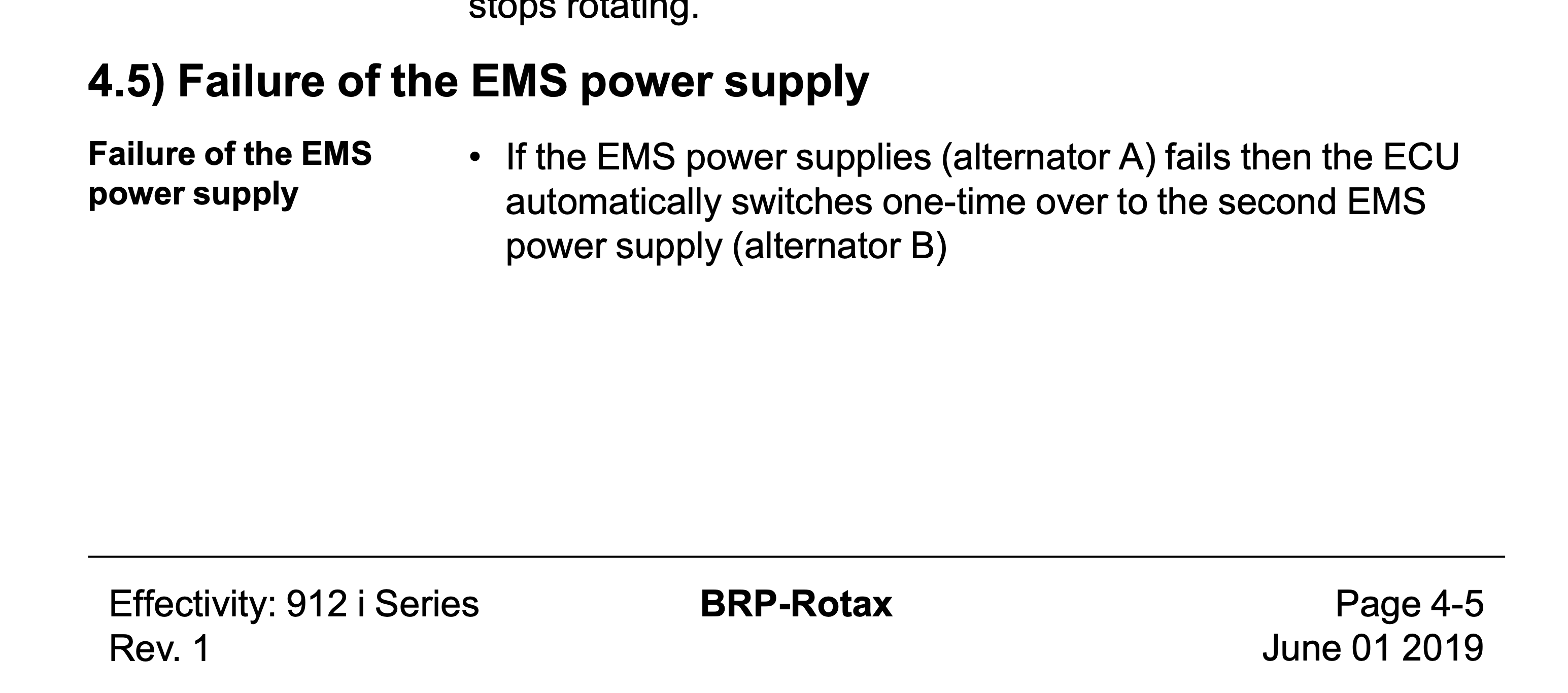

Thruster88 Posted March 15, 2020 Posted March 15, 2020 If correct terminology was used in the vid this has to be a fuel injected Rotax, would this aircraft not have multiple warning lights for alternator operation and low battery voltage ? Or was it a carburetor type with a failed charging/magneto system?

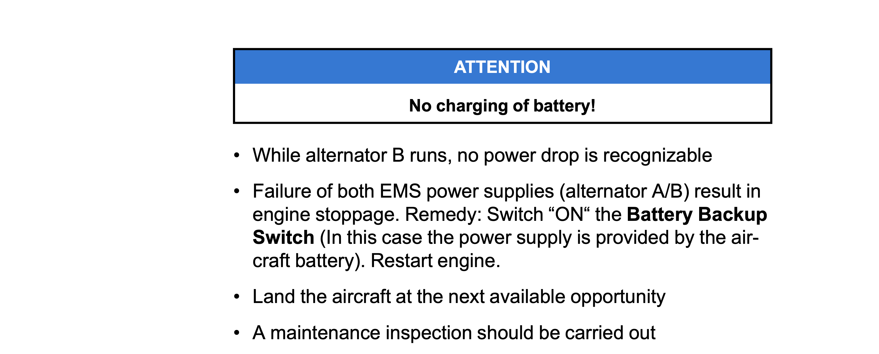

walrus Posted May 27, 2020 Posted May 27, 2020 (edited) Great video! Well done Kyle! Dunno what happened to the electrical system. If it was an injected engine, The engine shouldn’t have been running on battery at all unless the emergency power switch is selected on - which is also your cue to head home PDQ.The falling battery voltage should also have given the game away. I’d like to know what failed beyond the comment on the video : “alternator and battery”. Reference? Pages 4-5 and 4-6 of engine operators manual. Edited May 27, 2020 by walrus

Keenaviator Posted May 29, 2020 Posted May 29, 2020 Don't 912's have an ignition system independent of the alternator/battery? Some form of magneto which is self exciting...
Thruster88 Posted May 29, 2020 Posted May 29, 2020 Don't 912's have an ignition system independent of the alternator/battery? Some form of magneto which is self exciting... Yes they all have magneto ignition. We are discussing a 912is which is electronic fuel injected, hence the need for continuous supply of electricity. 1

Thruster88 Posted June 1, 2020 Posted June 1, 2020 I would like to know how this failure happened. Have read the POH for the Sling2 with 912is. Alternator failure will show on the lane a or b warning lights and the airplane should be landed asap, then there is the second alternator and then the battery. The odds of all three failing would be many millions to one. 1
