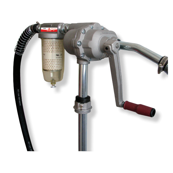

Thruster88 Posted March 26, 2020 Posted March 26, 2020 I use one of these filters. It will stop all crap and water.
