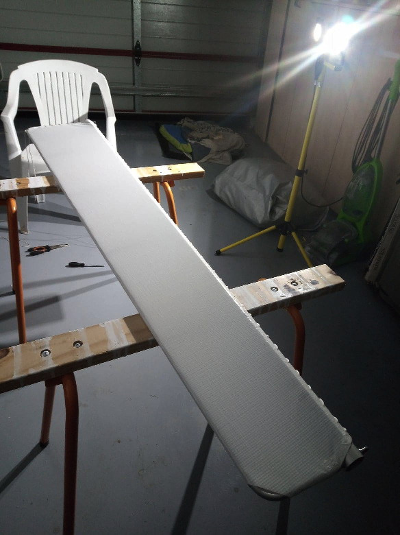

danny_galaga Posted April 5, 2020 Author Posted April 5, 2020 Just so you don't think I'm JUST sitting around whinging, just finished an aileron while the better half watched Married at First Sight. That show is good for SOMETHING at least :D 5 1
M61A1 Posted April 5, 2020 Posted April 5, 2020 Just so you don't think I'm JUST sitting around whinging, just finished an aileron while the better half watched Married at First Sight. That show is good for SOMETHING at least :D If that's how the whole aircraft goes together, you should have it finished by this coming Friday.... 2

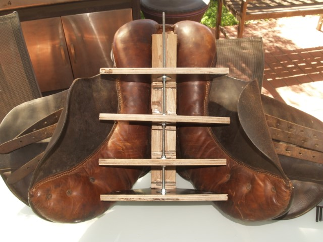

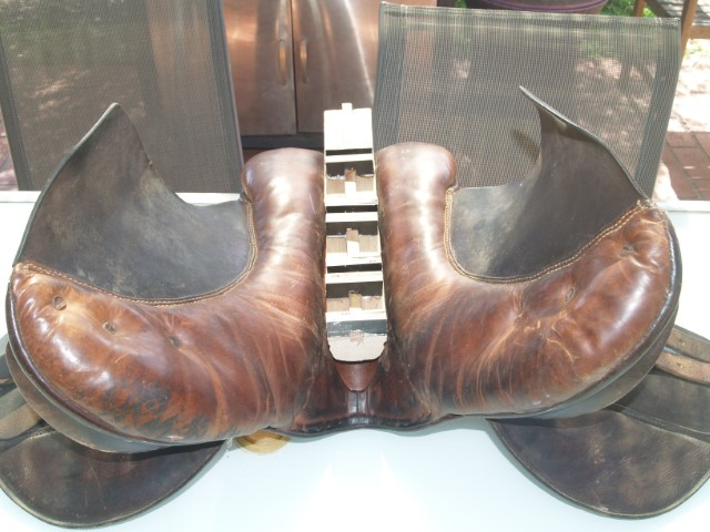

old man emu Posted April 6, 2020 Posted April 6, 2020 I mentioned that Danny's post kicked me into action to get on with making a saddle seat office chair. I've been doing a bit each day for the past few days, and here is where I am up to. Here's a picture of the spine of the mount, looking from front to rear. The spine is a length of banister rail with transverse blocks into which the formers will go. Here's a picture of the spine and formers in place. When sat upon, the saddle will force itself down onto the spine and the formers will act like a horse's ribs. The threaded rod, penny washers and nuts are to keep the formers in their relative positions, and to remove some flex if present. At the moment, the formers are clamped down while the glue sets. After that, the bottoms of the formers will be attached to a rectangular piece of ply that will secure them. The base plate will then be attached to the metal seat base which has the gas strut in it. A bit of paint and people will think it's a bought one. 2
Geoff13 Posted April 6, 2020 Posted April 6, 2020 That looks like a genuine Cavalry Saddle, could you show a photo of the other side please. Circa early 1900's If it is what I think it is then it is truly a collectors item. I have actually ridden on one, a truly uncomfortable piece of equipment if ever there was one.
old man emu Posted April 6, 2020 Posted April 6, 2020 could you show a photo of the other side please. I'll post a picture tomorrow. It is in pretty good nick, but I don't think it's that old.
