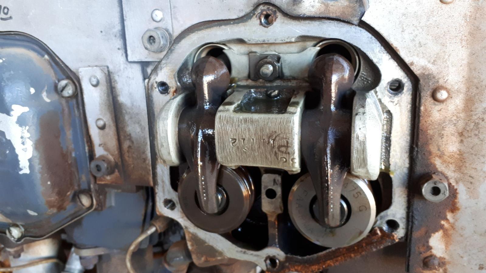

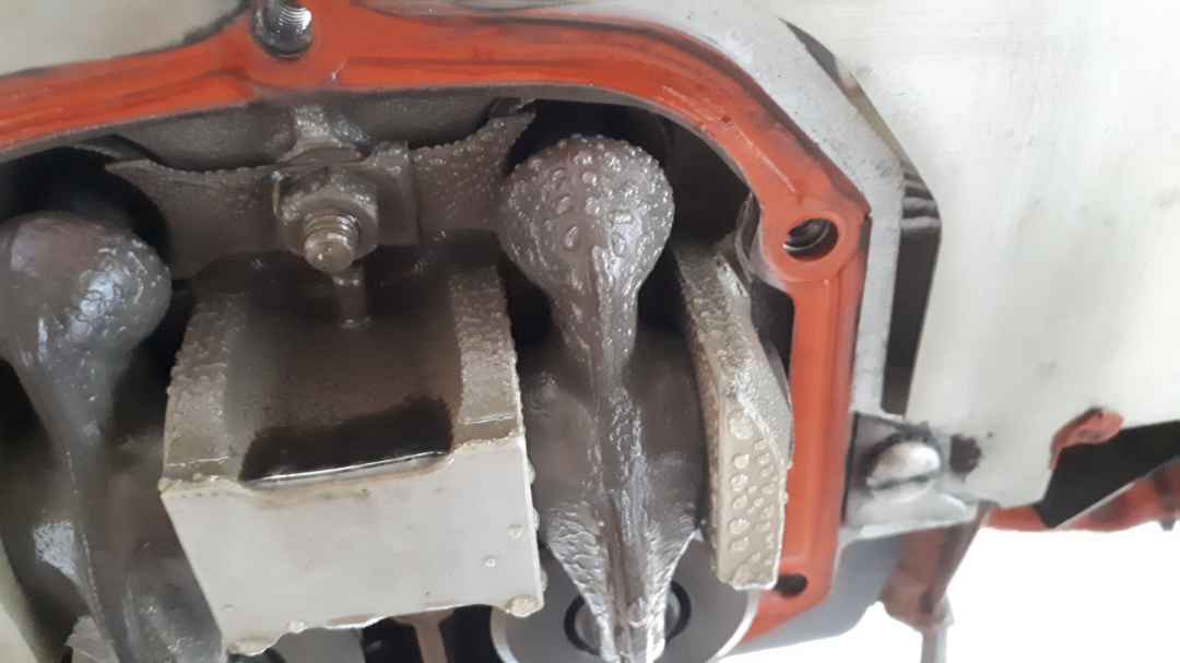

I have posted this info before but given the current circumstances I feel it is relevant. For the last year I have worked part time as an ame just because I love all aircraft?, I have learned a lot. The engine in the first pic had a ground run prior to a 100hourly, I removed the rocker cover 24 hours later, the water comes from the combustion process and wasn't burned off due to not reaching operating temperature for long enough. The second pic is my engine taken 24 hours after FLIGHT, about a week after the first pic and similar weather, it was completely dry. One can imagine the water droplets being evenly distributed throughout the crankcase and bores below the piston, not good. I will not be ground running my engine.Resized_20190712_082839_6570.thumb.jpeg.8b69bc2e4c0958cf9677744f57de2f19.jpegResized_20190720_151601_9159.thumb.jpg.0f91604cb3229d00754cff937b0739e1.jpg

I've been trying to make that point for ages. For each litre of fuel burned more than a litre of water is formed. The worst thing you can do is run the engine and not get it warm enough to expel the water . I've tried always to not FLY less than 45 minutes if I fire up the engine. NEVER just taxi from the clubhouse to your hangar. Nev

It’s posts like this make it all (forum wise) worthwhile. Noted! ??

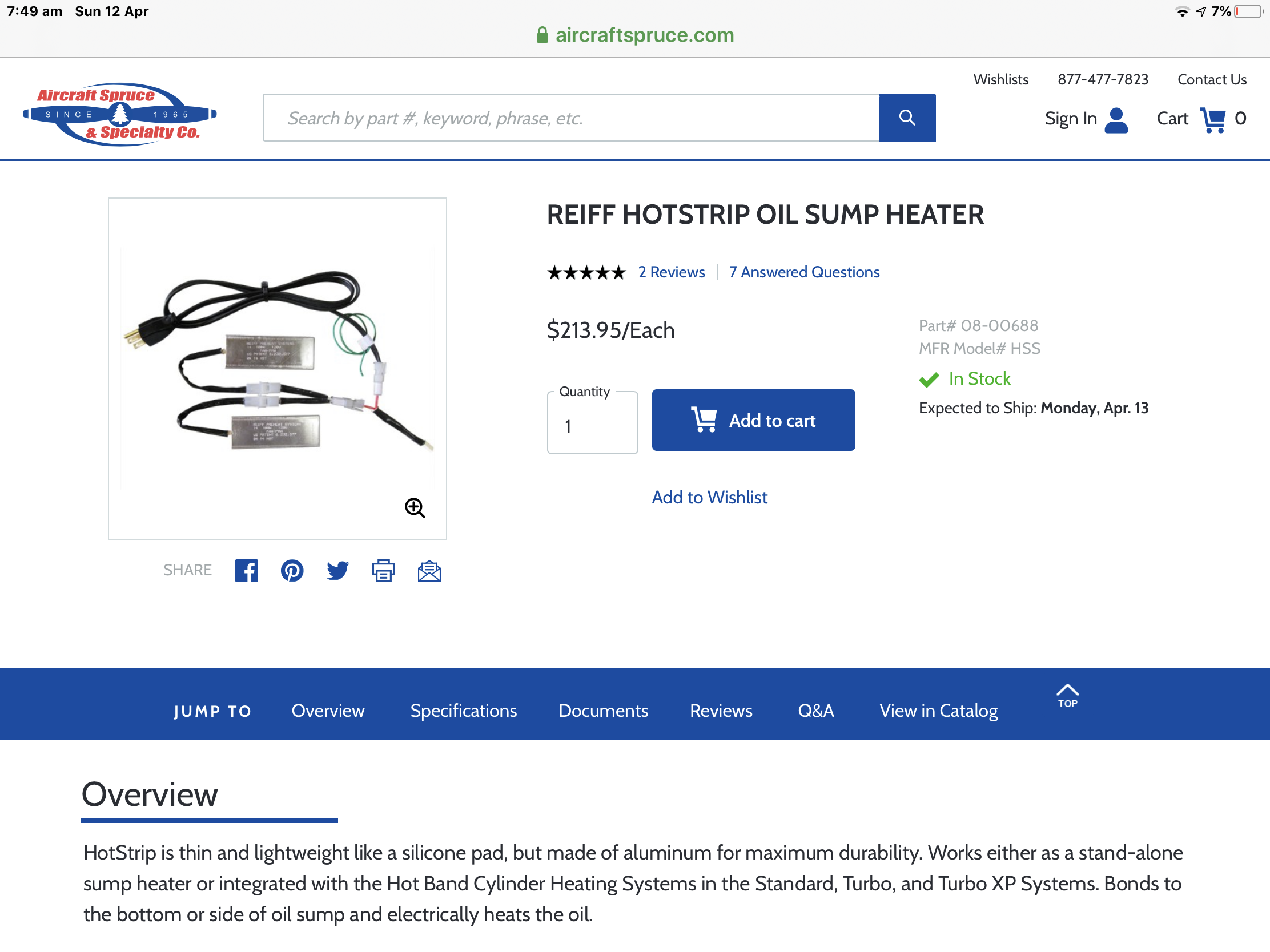

I will be ground running my engine but will fit one of these first.
