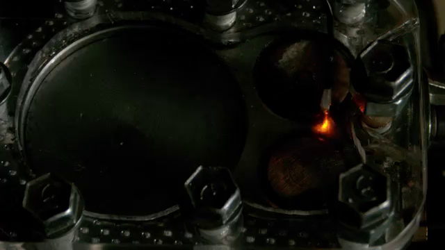

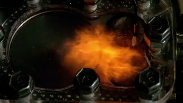

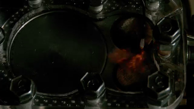

old man emu Posted April 12, 2020 Posted April 12, 2020 We all know that one of the pre-flight checks we always do is the magneto operation check. "Both - check revs; Left - check revs; Both; Right - check revs." We know that if the difference between the revs at "Both" and those at "Left" or "Right" is about 50 RPM, then the magnetos are working. But why do the revs drop when we go to only one magneto? It's all to do with the combustion of the fuel/air mixture. For too long, people have been taught that the events in the Otto 4-stroke cycle are: Suck; Squeeze; Bang; Blow. But that is wrong. When the fuel/air mixture goes we have detonation, and that is bad for the engine. It's about time people were taught: Suck; Squeeze; BURN; Blow. We have all seen movies where a flame front travels down a stream of petrol, or along a gun powder trail. More recently we have seen fire fronts moving into unburnt bush. That is exactly how the fuel/air mixture burns in a combustion chamber. The flame is initiated at the spark plug electrode and moves across the combustion chamber, igniting the fresh fuel/air mixture as it reaches it. Here are pictures of the combustion of fuel/air in a combustion chamber. The engine happens to be a side valve engine with the valves located to the right of the right of the picture and the piston to the left. 1. The spark is initiated at the spark plug electrode. 2. The flame front begins to develop near the spark plug electrode. Note the piston is before TDC 3. The flame front moves across the combustion chamber. The piston is at TDC 4. The flame front reaches the other side of the combustion chamber and the piston is moving down. The speed of the flame from can be calculated by the engine design boffins, with the speed of the flame front being one of the variables in the calculation. So, aero-engines have two spark plugs per cylinder for: Even combustion. With spark plugs on opposite sides of the combustion chamber, two flame fronts are generated and there is a quicker and more complete burn of the fuel/air mixture. More power. The combustion of the fuel/air mixture produces pressure which acts on the crown of the piston. Pressure is a force. The application of this force to the piston changes the Momentum of the piston The speed with which the momentum of an object changes is called Impluse. The speed at which the fuel/air mixture burning increases the pressure in the combustion chamber affects the speed at which the force from the pressure increases the momentum of the piston, which then becomes the torque force applied to the crankshaft, which ultimately is the source of the engine's horse-power. Therefore two spark plugs mean faster burn, hence more power. Reliability. A bonus arising from having two spark plugs per cylinder is redundancy. If one magneto, or HT lead, or spark plug fails, there is still one to carry on. However, if you lose the benefits described above, you lose power. If you are flying with a 4-cylinder engine, you could lose up to 25% of the rated power of the engine if one spark generating system fails. So why do you get at rev drop when you go from "Both" to one? Slower burn of the fuel/air mixture A lower rate of change of momentum of the piston, resulting in the generation of less torque at the crankshaft. Less torque = less horse power. Less horse power means a slower turning crankshaft, indicated by lower revs. Note: The stills were taken from a gif file that was too large to load. Each still is about 250 -300 Kb, so it you want the full set of 18 stills, or the gif, PM me with your email address and I'll send what you want. 4 2

old man emu Posted April 19, 2020 Author Posted April 19, 2020 There's a difference between "detonation" and flame front intersection. During a normal combustion cycle, the flame front expands from the point of ignition out towards the cylinder walls and piston crown, this burn process can take up to 90 degrees of crankshaft rotation to completely burn. Detonation is identified as any spontaneous combustion occurring after the burn process has already begun, and is independent of the initial flame front. This uncontrolled event can originate from anywhere within the chamber and is usually caused by high cylinder temperatures or an incandescent ash deposit. High temperatures can be caused by a over lean mixture where there is more than enough oxygen in the fuel/air mixture for the fuel to burn too rapidly Air-fuel ratio (AF or AFR) is the ratio between the mass of air ma and mass fuel mf, used by the engine when running: AFR=ma x mf The ideal (theoretical) air-fuel ratio, for a complete combustion, is called stoichiometric air-fuel ratio. For a gasoline (petrol) engine, the stoichiometric air-fuel ratio is around 14.7:1. The combustion is possible even is the AFR is different than stoichiometric. For the combustion process to take place in a petrol engine, the minimum AFR is around 6:1 and the maximum can go up to 20:1. When the air-fuel ratio is higher than the stoichiometric ratio, the air-fuel mixture is called lean. When the air-fuel ratio is lower than the stoichiometric ratio, the air-fuel mixture is called rich. For a perol engine, an AFR of 16.5:1 is lean and 13.7:1 is rich. The AFR affects the torque an engine can produce. Example of air-fuel ratio (AFR) function of engine speed and torque for a car engine, but the principle is the same for aero engines.

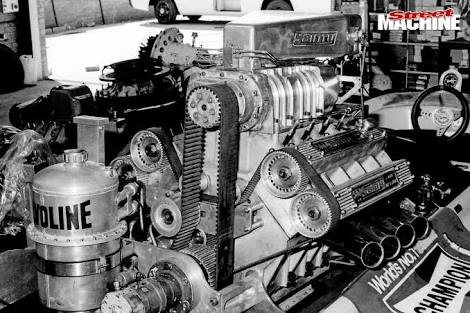

spacesailor Posted April 19, 2020 Posted April 19, 2020 The Sainty V8 vibrates too, ,now running 3 seconds. spacesailor
