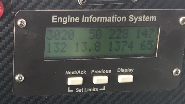

dewilcox Posted April 19, 2020 Posted April 19, 2020 Has anyone experience wilth Rotec aerosport water cooled heads for Jabiru 2200? Installed in Savannah VG ? Seeking consumer reports after seeing the ad in EAA Sport Aviation Magazine. I’m flying a Rotec conversion in Arizona. I have 20+ hours on my 2200 with the liquid cooled heads. I flew today, photo attached. OAT 50f, Water temp 132f, CHT 228f. This is in a Jabiru SP. RPM OAT CHT OT H2O VLTS EGT OP 1
