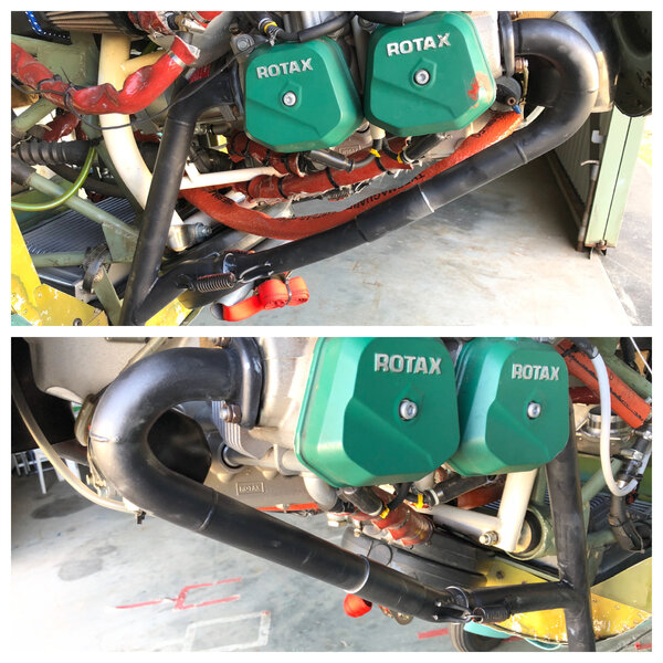

ozzietriker Posted May 5, 2020 Author Posted May 5, 2020 I had my exhausts coated in the highest heat resistance. I did it to keep heat down under cowl. It didn’t make a scrap of difference and I have had to wrap them again. If you are going for looks it’s good and will preserve the pipes but don’t bother if you are primarily going for heat reduction Thanks for the reply and pictures - looking great. Yes the idea to get mine done is purely for looks and surface protection - mine is looking a little sad.

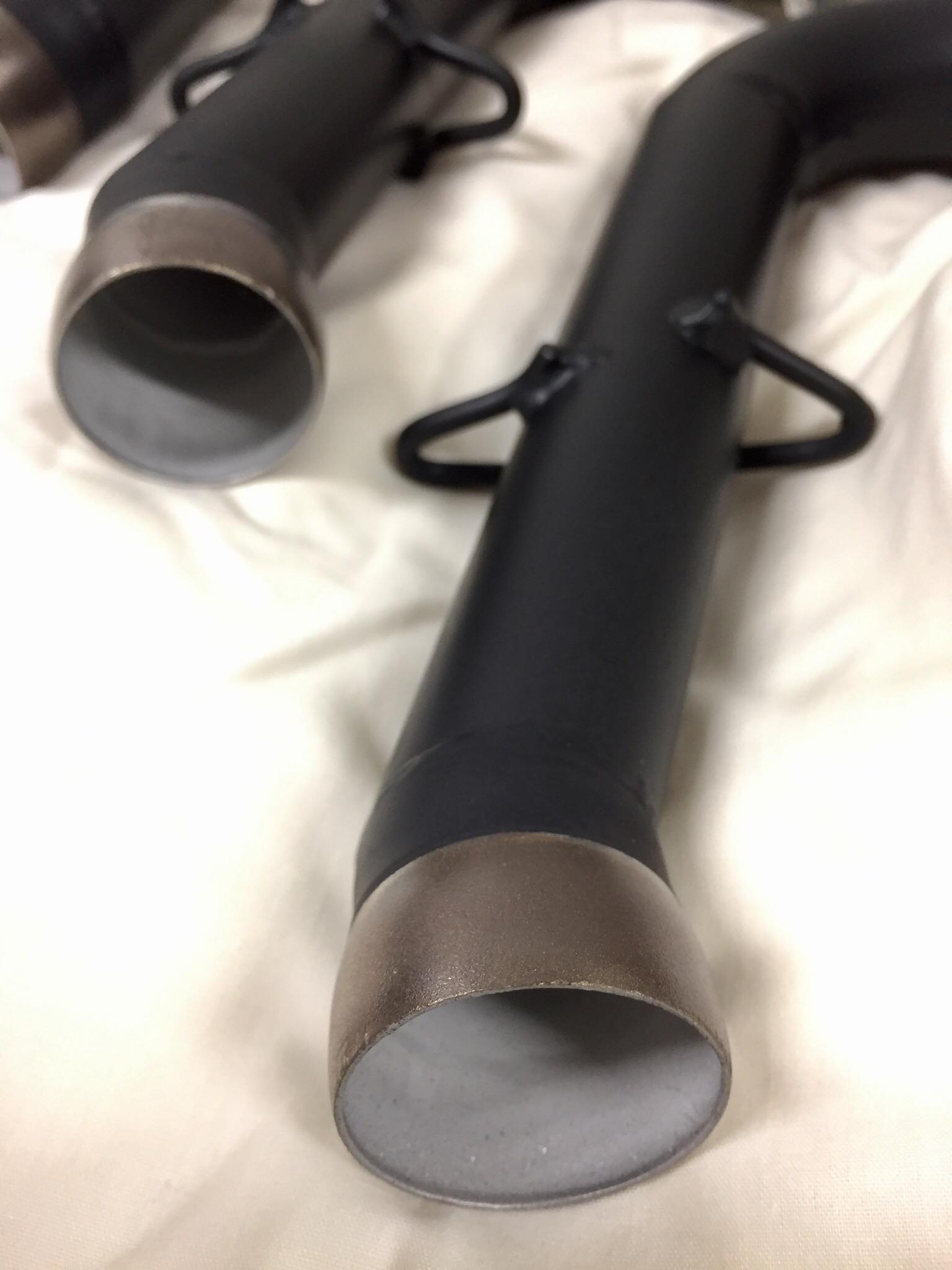

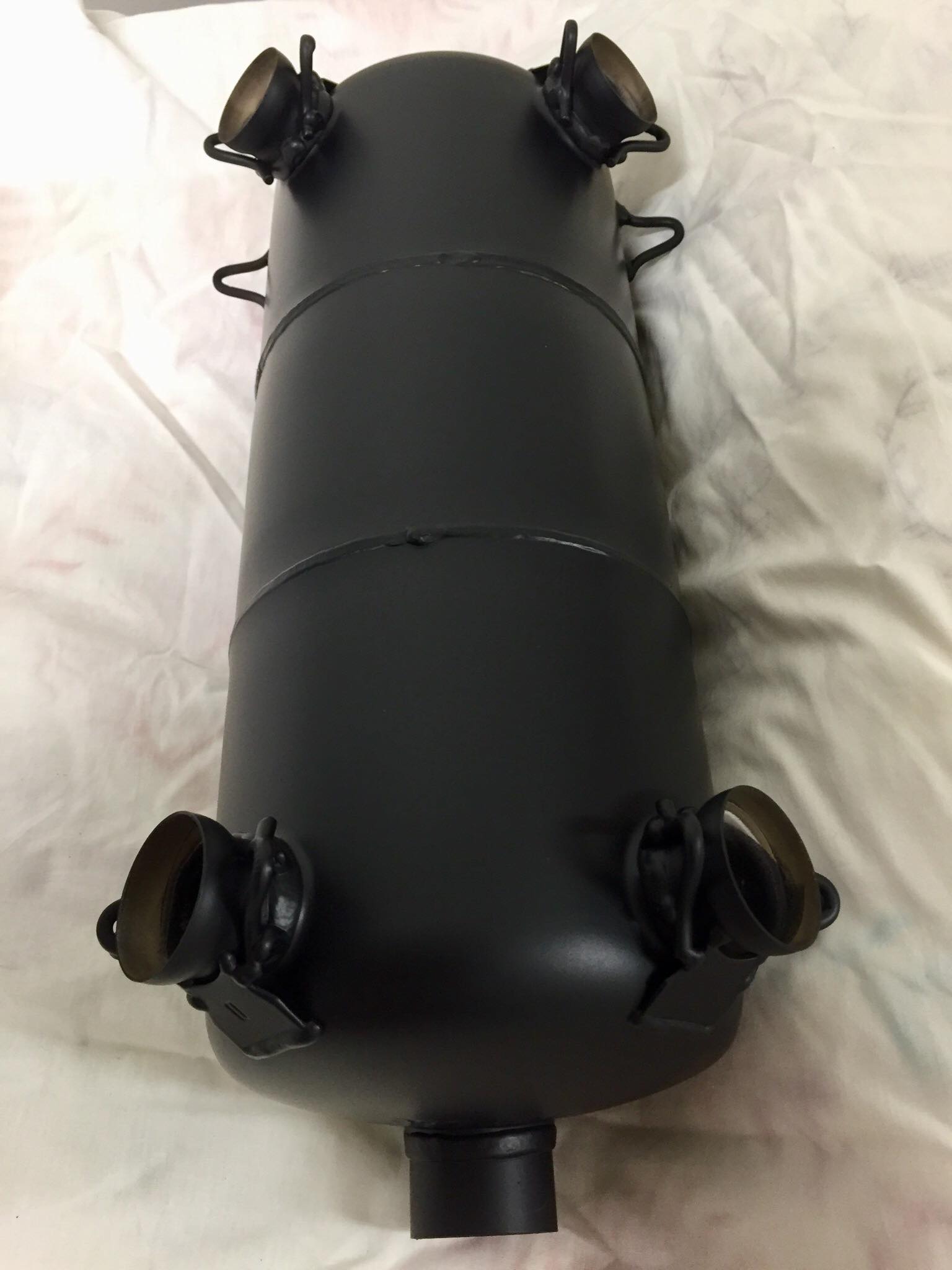

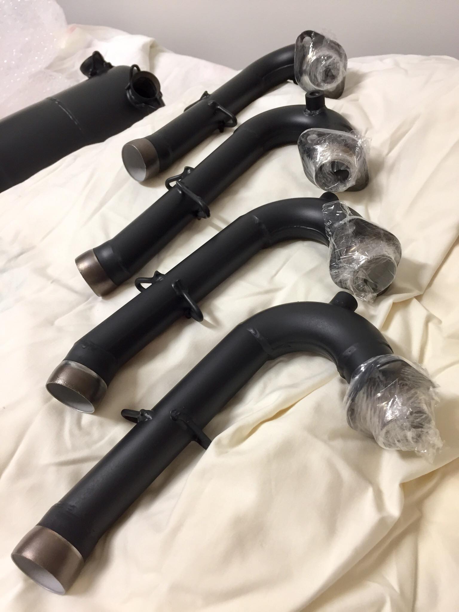

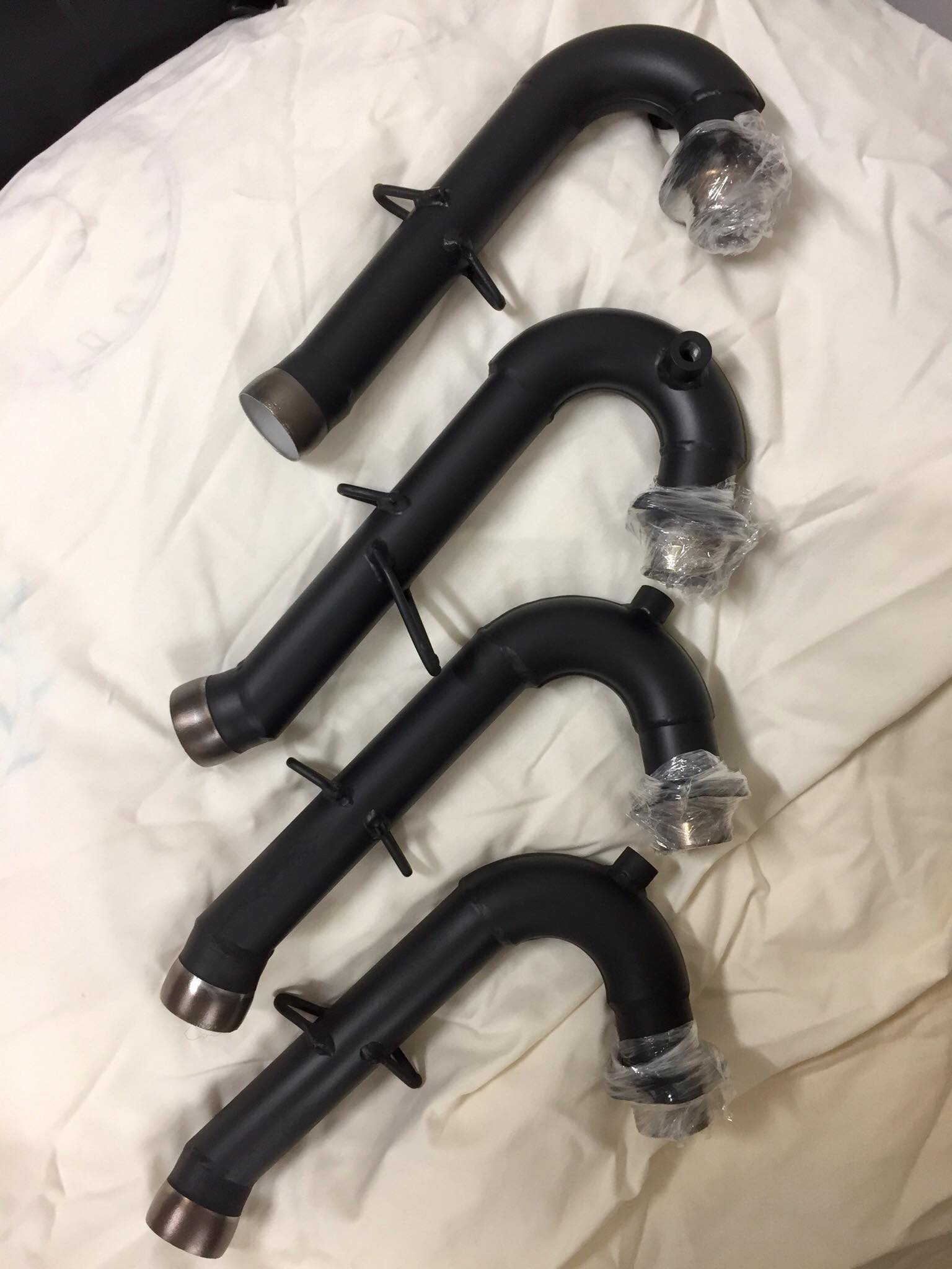

ozzietriker Posted May 27, 2020 Author Posted May 27, 2020 Just had my 912 exhaust system ceramic coated yesterday in Turbo-Black colour at Competition Coatings in Acherfield BNE $300 - very happy with the job (pictures attached). Thanks fellas for your advice and opinions :) cheers, Andrew 3
