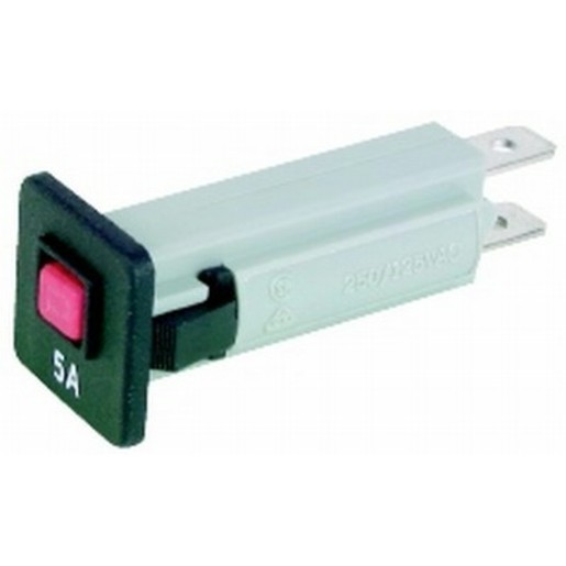

kgwilson Posted April 27, 2020 Posted April 27, 2020 I used panel mount breakers from Jaycar. They are about $10.00 each & come in varying amperages & have a bright red trip button so you can't miss it. 2

danny_galaga Posted April 28, 2020 Author Posted April 28, 2020 kgwilson said: I used panel mount breakers from Jaycar. They are about $10.00 each & come in varying amperages & have a bright red trip button so you can't miss it. [ATTACH type=full]52723[/ATTACH] I haven't had a chance to have a good look at these. Do I need to make a square hole for them as implied by the picture?

kgwilson Posted April 28, 2020 Posted April 28, 2020 The type I used say they will trip within 1 hour at 135% of rated power and within 1 minute at 200% of rated power. I tested them with a much higher rate than that & they tripped instantly. I've never had an issue which has tripped them in operation. 1
