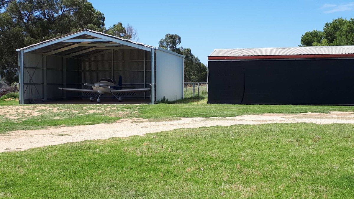

Thruster88 Posted July 14, 2020 Posted July 14, 2020 A hanger for the RV6A is underway. Might even paint the floor in this one. 3
Flightrite Posted July 14, 2020 Posted July 14, 2020 A hanger for the RV6A is underway. Might even paint the floor in this one. [ATTACH=full]54672[/ATTACH] Hope yr Vans is 4x4 capable!? Be very careful Thruster, I've seen a few A's on their lids!
Thruster88 Posted July 14, 2020 Posted July 14, 2020 Hope yr Vans is 4x4 capable!? Be very careful Thruster, I've seen a few A's on their lids! Thankyou for the reminder Flightrite, I am operating from the big strip in town whilst getting familiar with the RV. Finding it to be an obedient and pleasant aircraft to fly and land. A good many Thrusters have had their U/C bent and busted and some end upside down, is it a fault with the aircraft, perhaps not.

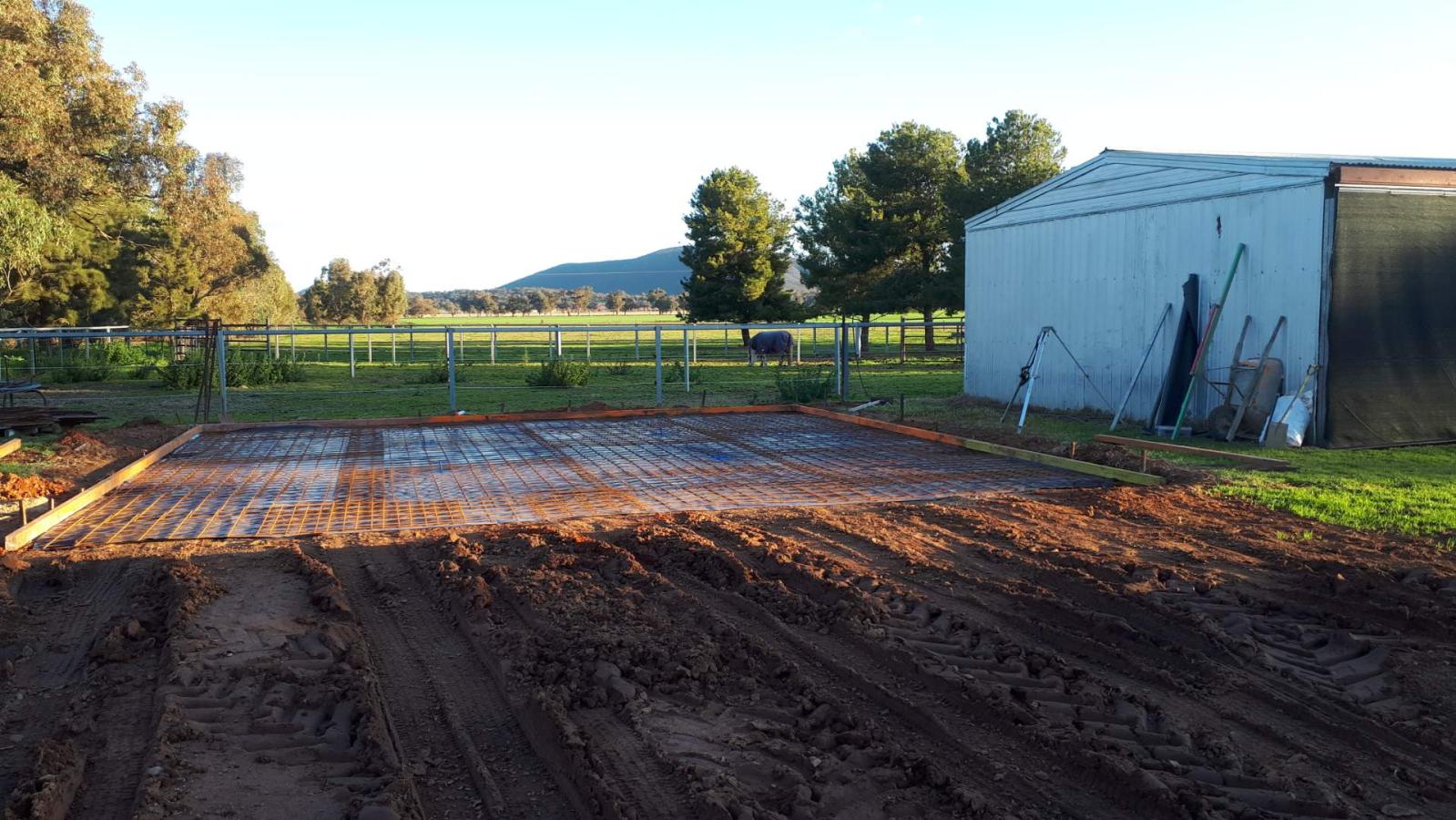

Thruster88 Posted December 7, 2020 Posted December 7, 2020 Doors are coming but the view is so nice from the house.😍😍 7 2 1

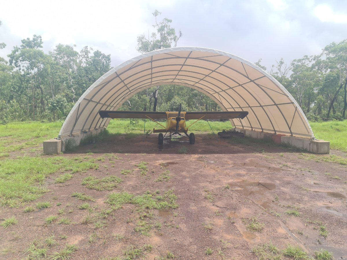

NT5224 Posted February 8, 2021 Posted February 8, 2021 Here's where mines at... still got to enclose the back... all materials and delivery for structure came in under $7000.. 14

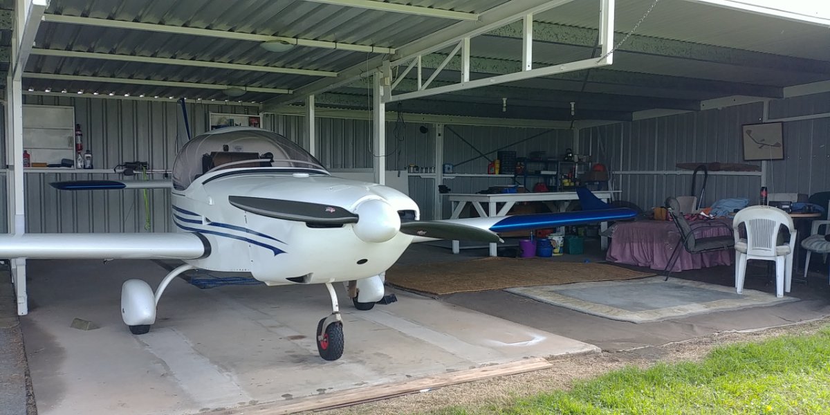

kgwilson Posted February 9, 2021 Posted February 9, 2021 (edited) In the early days of the pandemic I had plenty of spare time and 10 litres of white paint so I painted the internal framework of my hangar to smarten it up a bit. Worked out OK. Edited February 9, 2021 by kgwilson 7 2
Mike Gearon Posted February 16, 2021 Posted February 16, 2021 On 09/02/2021 at 10:23 PM, kgwilson said: In the early days of the pandemic I had plenty of spare time and 10 litres of white paint so I painted the internal framework of my hangar to smarten it up a bit. Worked out OK.ive I've purchased 2 X 250mm C purlins X 10 Metres to accomplish what you have there in those simple trusses and the 2 uprights either side of wing. Maybe the low labour input of my C purlins will balance this. I just stick them up and weld then cut out the middle support...500 dollars worth and I have to get them to french island....If I'd seen this I'd have been tempted to do similar. I'll stick pictures up as I get my workshop conversion to hangar sorted.
kgwilson Posted February 16, 2021 Posted February 16, 2021 The centre bit on the concrete was all that was left when I pulled the rest of this original T hangar down & made it full size, now with a 12.5 metre width and 7 metre depth. The steel from the original wing boxes was used for the external frame & C section purlins (unpainted) for the roof. Total cost was dilapidated T hangar 4K, purlins & house lot of hail dented colorbond, concrete footings, nuts, bolts, roof screws & welding rod, 1.5K so a complete hangar for 5.5K. 1 1

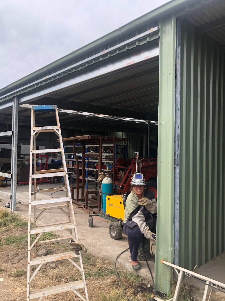

Mike Gearon Posted March 1, 2021 Posted March 1, 2021 (edited) I’ve gone from hangar greenhouse style to realization I have a huge shed and can drop out an upright with added double C purlin 250mm x 2.5mm. Easy job with extended tracks and same sheets used to make second slide door. 20 hours and 700 dollars. Have 10mm sag and will Jack up 20mm and add 20mm tensioned rods angling up and to each side. I’ll bet it unjacks to perfect. Unjack must be a word. I just used it. wife doing her first ever weld in pic. I was surprised as it was okay. May polyurethane floor and line an area of 15m x 8m and buy a rans 21. Rans is 4 hours drive from my USA home and can partially build there and bring in if as a maybe long term plan. Edited March 1, 2021 by Mike Gearon Spell check tried to correct unjack to ijack 6
Old Koreelah Posted March 2, 2021 Posted March 2, 2021 4 hours ago, Mike Gearon said: wife doing her first ever weld in pic. I was surprised as it was okay... Mike an intellectual type I once knew surprised me with his impressive welding skills. He said his mum had taught him. 2 1
