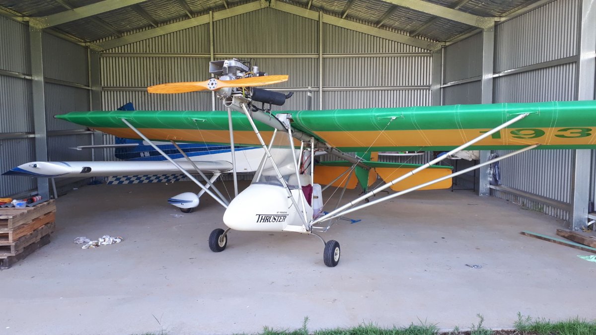

Mine was built 5-10 years ago and is 12m x 12m.
I think it cost about $7-10,000 in materials with 2nd hand iron used on walls. We used what we call crusher dust (I think crushed granite is similar) mixed with cement powder, watered, then rolled. It sets like concrete at a fraction of the cost. We were having a tennis court built at the same time so the guy who did the earthworks etc used his gear to get the floor beautifully level for me. I'm sure the crusher dust was less than $20/cu mt and I think i used 20-25 cubes, 24 bags of cement, my time and the hire of a small roller.
I opted to build bi-fold doors which were a little tricky to get exactly square but it did away with the need for outrigger framework for sliding doors, sorry I don't have a picture of them.
I can comfortably fit the Thruster and Jabiru in it along with the thruster trailer and a fridge in the corner for storage. Plan was for it to be big enough for Thruster and GA sized plane. It will be tight but i think it will work.
  • Like 3
  • Winner 1
They are called LSB (light steel beams), unfortunately no longer built here in Aus. The machine that built them and patent was sold to the US I believe. No need for bracing due to the depth of the beams and the wall iron provides strength as well, although I could have braced between the wall purlins (lazy).
  • Helpful 1
