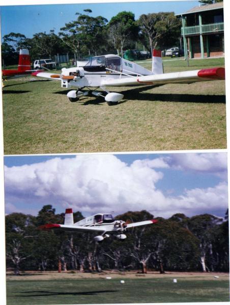

Methusala Posted April 7, 2008 Posted April 7, 2008 Don's VP-2 Dear Bob I'll try to attach these pics to this post, regards Don.
icebob Posted April 7, 2008 Author Posted April 7, 2008 Thanks for the photos Don. RLP - this is the VP2, my VP1 had the same wings as these photos. Don, I will indeed post photos but in a few weeks, I am doing a scrap book of all my photos of my aircaft as a way of saying goodbye, I am indeed proud of her and we have had a longer association than my wife and I, my aircraft was my second girl(better say that the wife is looking;)) Bob.
