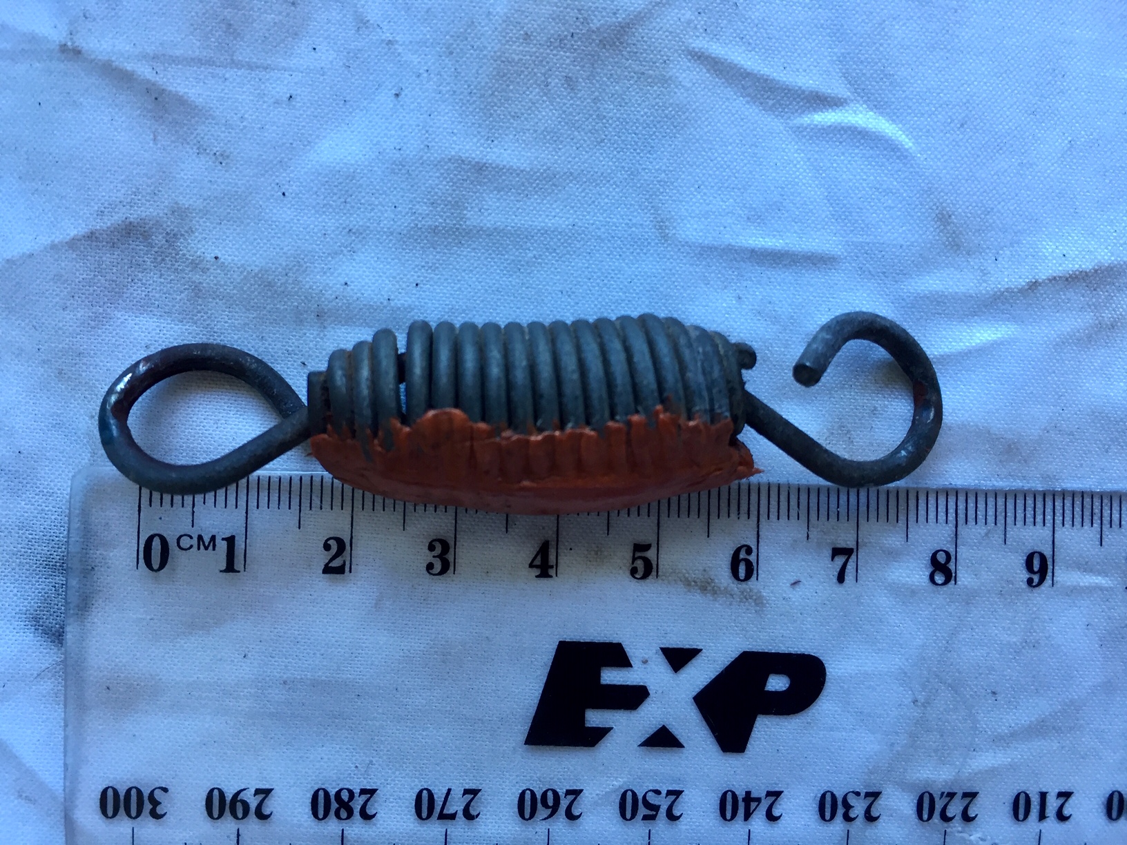

ozzietriker Posted May 12, 2020 Posted May 12, 2020 Hi All, Can someone please tell me where can I buy this exhuast spring? it is fitted to a Rotax 912ULS engine - It is not a Rotax original part however came with the new engine. They are starting to look a little sad and wanted to replace. I refuse to use the Rotax springs as they frequently snap. Thanks in advance, Andrew
facthunter Posted May 12, 2020 Posted May 12, 2020 Some Trailbike DRUM brake return springs might do it or prewar Harley. The Harley stock will probably be not NOS so check quality' Nev 1
onetrack Posted May 12, 2020 Posted May 12, 2020 Ozzietriker - Do an eBay search using "swivel end springs". You will find some go-kart springs are nearly identical. You can also get them in stainless, which may be a more durable option. You may have to modify the curl on the hook on the eBay springs, to match yours. 1

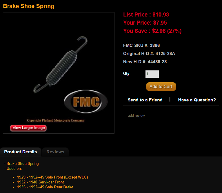

old man emu Posted May 12, 2020 Posted May 12, 2020 This is the brake spring for Harleys with a 45 cu in engine: The price is in $US, but postage is ridiculous. 1
turboplanner Posted May 12, 2020 Posted May 12, 2020 Hi All, Can someone please tell me where can I buy this exhuast spring? it is fitted to a Rotax 912ULS engine - It is not a Rotax original part however came with the new engine. They are starting to look a little sad and wanted to replace. I refuse to use the Rotax springs as they frequently snap. Thanks in advance, Andrew A second pair of eyes on your exhaust system may also produce a solution. Often the engine is vibrating at one frequency and one direction, and the exhaust needs to be free enough to do the same, but people sometimes bolt the exhaust to the frame rigidly, or in a different plane. The pipe should sit in the cylinder socket and move with the socket. Often various brackets or pipes fail if the system can't move with the engine. 2
facthunter Posted May 12, 2020 Posted May 12, 2020 When a spring stretches out it can get harmonics in it. Laying a strip of tarry looking stuff (someone will know the name) ALONG the spring will dampen the vibrations. Nev 2
Blueadventures Posted May 12, 2020 Posted May 12, 2020 Hi All, Can someone please tell me where can I buy this exhuast spring? it is fitted to a Rotax 912ULS engine - It is not a Rotax original part however came with the new engine. They are starting to look a little sad and wanted to replace. I refuse to use the Rotax springs as they frequently snap. Thanks in advance, Andrew Try looking up motor bike exhaust springs. Look at the distance between the ends and also the wire thickness. I bought some as spares for my 912uls with a CKT exhaust. Then bought 4 spares from them as always good to have spares on board when on a trip. 1
spacesailor Posted May 12, 2020 Posted May 12, 2020 Try " Lee brothers" Parramatta, ( off O,connel st ) 6 Dunlop st The nut house. spacesailor 1
mnewbery Posted May 12, 2020 Posted May 12, 2020 Laying a strip of tarry looking stuff (someone will know the name) I think its high temperature silicone glue, last I saw was reddish - JB-Weld red?
skippydiesel Posted May 12, 2020 Posted May 12, 2020 Strange - I have been operating my 912 ULS for 10 years and some 600 + hrs - I have changed my unbroken exhaust springs once only because I thought they looked a little stretched. I have never had one break but do use safety wire in case of a failure and I fill the inner void with high temp silicon to prevent harmonic damage.
facthunter Posted May 12, 2020 Posted May 12, 2020 What's strange about that? as long as the silicon doesn't go hard .Then it will make all the action be where it begins and ends. Nev
Downunder Posted May 12, 2020 Posted May 12, 2020 I use JBM springs. Over 600 hrs with no breaks. Postage is expensive, so buy 2 sets. I agree that the standard Rotax are crap....... went through a few before I worked it out. http://jbmindustries.com/SOCKET.html I see Spruce also sell SS springs. https://www.aircraftspruce.com/catalog/eppages/gplssexhaustspring.php 1
skippydiesel Posted May 13, 2020 Posted May 13, 2020 What's strange about that? as long as the silicon doesn't go hard .Then it will make all the action be where it begins and ends. Nev Strange that he is having a problem and I am not - inference -the cause is related to how the springs are attached rather than the springs themselves or some other factor. Just trying to be constructive.
facthunter Posted May 13, 2020 Posted May 13, 2020 Thanks skip. for answering I couldn't pick up a connection. I wouldn't recommend stainless unless you are on a boat. Springs need to be spring steel Too soft and there's no tension maintained. The "swivel' is a luxury but does ensure there's no twisting effect when you are installing them. Nev 1
