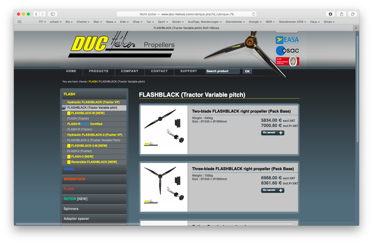

Sam the Swiss Posted May 16, 2020 Posted May 16, 2020 How about a DUC propeller, variable, light (but of course not cheap)?
Kyle Communications Posted May 16, 2020 Posted May 16, 2020 Yes looked at them today... I like that carbon hub but the price nah....out of the ballpark here..thats why Airmaster currently has the market here on IFA
