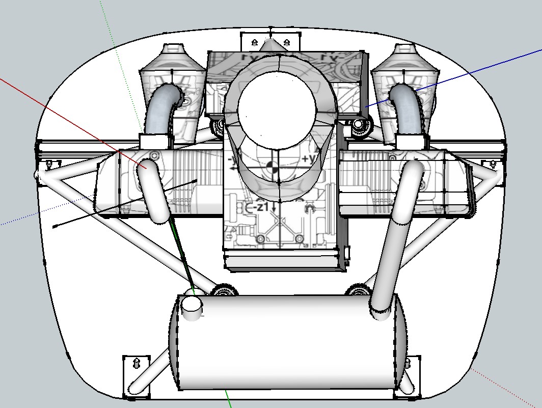

Marty_d Posted May 13, 2020 Posted May 13, 2020 Talking of this (and sorry, don't want to hijack the thread) - when I bought the second hand 912 he threw in the new muffler, donuts and pipes to make up a new system. (The motor was from a training aircraft with existing muffler in good condition - it made sense for him to keep the old one in place with the new engine). I'm planning the pipes at the moment - as the entry points in the muffler are closer together than the exhaust ports on the engine, the pipes have to angle inwards as they meet the muffler (see picture attached). I know there's a ball-end on the pipes that allows some rotation from straight into the muffler, but am I better off putting a bend in the downward leg of the pipe so the ball end seats straight into the muffler? If you know what I mean!
skippydiesel Posted May 13, 2020 Posted May 13, 2020 Suggest you check out a number of Rotax 912 installations to get the best "feel" for this. You may find that other factors will influence where and how much you "bend" eg oil filter clearance to facilitate installation /removal without having to loosed/remove the corresponding "pipe" In the end having a good "ball & socket" alignment into the muffler is more important than how much you have had to bend the pipe to achieve clearance (probably a bit of a compromise will be required)

M61A1 Posted May 14, 2020 Posted May 14, 2020 Talking of this (and sorry, don't want to hijack the thread) - when I bought the second hand 912 he threw in the new muffler, donuts and pipes to make up a new system. (The motor was from a training aircraft with existing muffler in good condition - it made sense for him to keep the old one in place with the new engine). I'm planning the pipes at the moment - as the entry points in the muffler are closer together than the exhaust ports on the engine, the pipes have to angle inwards as they meet the muffler (see picture attached). I know there's a ball-end on the pipes that allows some rotation from straight into the muffler, but am I better off putting a bend in the downward leg of the pipe so the ball end seats straight into the muffler? If you know what I mean! [ATTACH=full]53179[/ATTACH] Don’t forget to make you can still get your oil filter off and on again with regard to the front left pipe. Mine has a bend that seemS to be for no reason until you pull the oil filter. 1

Blueadventures Posted May 15, 2020 Posted May 15, 2020 Talking of this (and sorry, don't want to hijack the thread) - when I bought the second hand 912 he threw in the new muffler, donuts and pipes to make up a new system. (The motor was from a training aircraft with existing muffler in good condition - it made sense for him to keep the old one in place with the new engine). I'm planning the pipes at the moment - as the entry points in the muffler are closer together than the exhaust ports on the engine, the pipes have to angle inwards as they meet the muffler (see picture attached). I know there's a ball-end on the pipes that allows some rotation from straight into the muffler, but am I better off putting a bend in the downward leg of the pipe so the ball end seats straight into the muffler? If you know what I mean! [ATTACH type=full" alt="Muffler drawing incomplete.jpg]53179[/ATTACH] Hi Marty you will need to lube the ball ends every 100 hours so each second oil change, so not a big issue even if you had to do every oil change. 1
