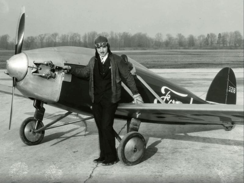

Mike Gearon Posted May 16, 2020 Posted May 16, 2020 Just about every aeroplane has wing diherdral. The only one I've really looked at that doesn't as the Ford Flivver. https://www.thetruthaboutcars.com/2014/07/henry-fords-flying-flivver-the-model-t-of-the-air/ [ATTACH type=full" alt="1589510489906.png]53202[/ATTACH] As for the Corsair, I can see that the gull wing would reduce the overhead space when the wings are folded. As for allowing the wing to join the fuselage to join the fuselage at 90 degree, neither the Corsaid not Stuka have their wings attached at 90 degrees. Look at the 3-views. from the article...Almost certainly the straight wing as making it “one of the worst aircraft he ever flew” “After Charles Lindbergh’s popularity exploded following his transatlantic flight, Henry Ford invited him to visit Ford Airport and fly the Flivver in August of 1927. Lucky Lindy didn’t share Brooks’ enthusiasm for the litte plane, later describing it as ” one of the worst aircraft he ever flew”. I guess that one man’s “think a little faster” is another man’s uncontrollably dangerous.”

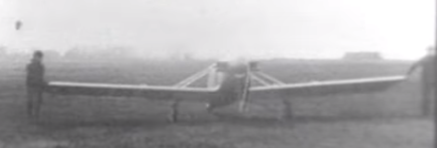

old man emu Posted May 17, 2020 Author Posted May 17, 2020 (edited) A high winged aircraft might achieve the same stability without dihedral as a low wing with it due to the pendulum effect of the airframe hanging from the wing. Almost certainly the straight wing as making it “one of the worst aircraft he ever flew” Probably no doubt about that - low wing aircraft with no dihedral, or did it have some? But Lindberg flew either the first or second protptype From the pictures in this video, there seems to be some. Flivver 2A (Flivver 3218) The third prototype was larger with a 22 ft (6.7 m) wingspan, had a fabric-covered steel frame, featured wing struts, a 50-gallon fuel tank, a dihedral increase, and a custom 143-cubic-inch (2,340 cm3)-Ford designed, horizontally opposed two-cylinder engine using Wright Whirlwind components that produced 40-horsepower (30 kW). The video shows the Flivver 2A during an attempt to win a long distance record for light planes in 440 to 880 lb (200 to 400 kg) "C" class. The race was set from Ford Field in Dearborn Michigan to Miami, Florida. The attempt was stopped by bad weather at Titusville, Florida, where the propeller was bent, but still achieved a 972 mi (1,564 km) record. The pilot placed wooden toothpicks in the vent holes on his fuel cap to prevent moist air from entering and condensing overnight. On February 25, they took off to complete the flight, circled out over the Atlantic where the motor quit and he went down off Melbourne, Florida. Investigation of the wreckage disclosed that the toothpicks had plugged the fuel cap vent holes, causing an engine stoppage. Edited May 17, 2020 by old man emu 1

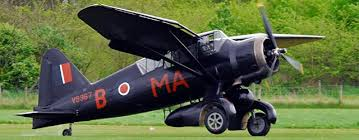

kgwilson Posted June 9, 2020 Posted June 9, 2020 That is a nice example. The Westalad Lysander wasn't one but from some angles looks like a gull wing due to it narrowing at the fuselage. 1
