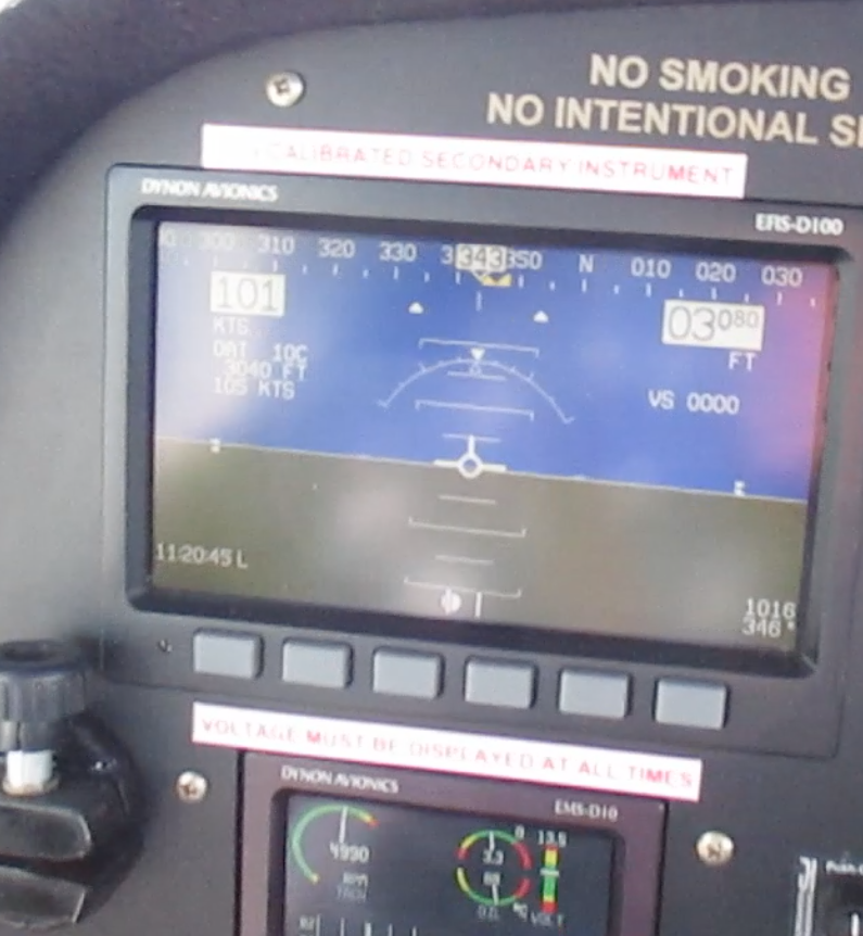

pylon500 Posted May 23, 2020 Posted May 23, 2020 For a start, you don't need to go to the expense of a 914 when cross fitting. I flew an original J230 down to have the Rotax mod done to it, a 912s was installed, it was test flown (by me), and then ferried back to it's owner. With the 912s, the performance was basically the same, it could cruise at 115kts if pushed, although I tend to be a little more casual and (as shown in attached) would sit on 105kts @ 4930rpm. Some like to push 912's harder, and they'll take it, but in the 5000 rpm range they only drink around 16Lph. This aircraft would also climb at 1200fpm @ 70kts with no risk of overheating. I can't remember if the battery was moved down the back for CofG reasons, but remember, 230's are nose-heavy two up, but nice solo. If you're used to the sound of the old Jab six, the Rotax 'buzz' can take a bit to get used to, but you're not listening to every valve movement waiting for something to happen. [ATTACH=full]53405[/ATTACH] [ATTACH=full]53407[/ATTACH] Well that's annoying, wrote this a couple of days ago, but forgot to hit the post button! DOH!
pylon500 Posted May 23, 2020 Posted May 23, 2020 Anyone else see my attachments? I just get the oops message... As for J3300 vs R912s weights, the totally installed and running weight of the 912s is probably just a little higher than the 3300 after you add two radiators, coolant and an oil tank. Obviously a 914 would be heavier again. I know there's been a few '100' series Jabs with 912's fitted, and balance was a problem, but the length of a J230 hardly notices it. Going to repost the attachments just in case... (I think last time I must have hit Preview instead of Post) 3 1
