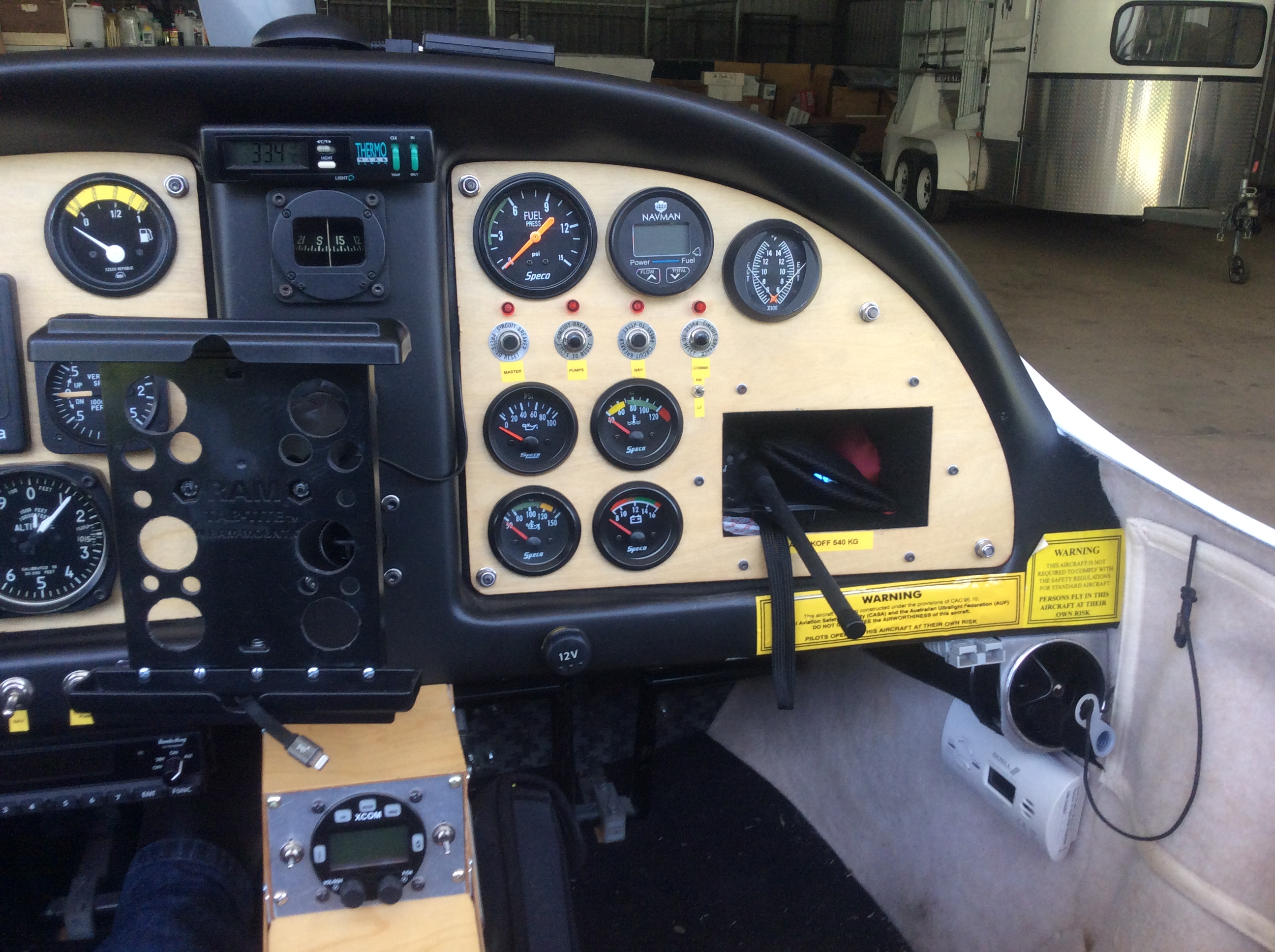

skippydiesel Posted May 31, 2020 Posted May 31, 2020 I have had two over temp shut downs with my iPad mini (both in very bright sunlight) - came up with three fixes which seem to have solved the problem. Drilled out the back of my Ram mount to allow more air to circulate. Punched holes in the rubber iPad cover - same as above Installed a dedicated small eyeball vent behind iPad mount. Can just see it in the pic My iPad is on charge at all times while running OzRwys- definitely contributes to heat build up
