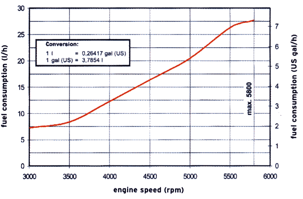

M61A1 Posted June 9, 2020 Posted June 9, 2020 Airframe won't make any diff, the engine doesn't know if it's strapped to an airboat of billy cart, I'm not after performance. Somebody out there operating a 100 gee gee's carby Rotax must know what they are getting at 5200 rpm? A good point, perhaps what I should have said is that just 5200 rpm isn’t enough information. Whereas 5200 at a specific manifold pressure will get some data. Did you look at the Rotax graph?

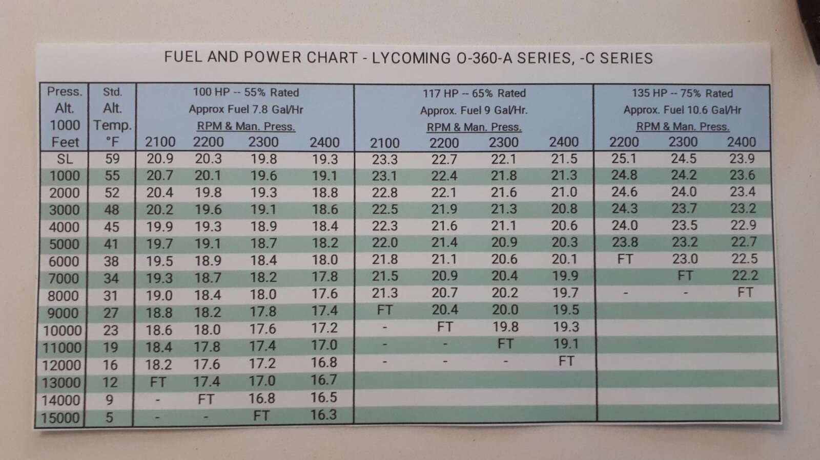

Thruster88 Posted June 19, 2020 Posted June 19, 2020 An example of a power chart, note there is no mention of propeller or aircraft type. If we are flying at 5000', 2300rpm and 19 inches manifold pressure the engine is producing 100hp and burning 7.8us gal or 29.6 litres per hour. A Rotax 912 burns 28.5 lph at 100hp.
Downunder Posted June 19, 2020 Posted June 19, 2020 How would that relate to prop pitch settings? A Rotax ground adjustable prop set super fine would pull 5800 easily....... And going the opposite, lets say WOT at cruise pulls 5200 max rpm. (Rotax's minimum WOT spec). If the "fine" engine pulls throttle back to 5200 will manifold pressure be the same? Surely manifold pressures aren't the same?
Thruster88 Posted June 19, 2020 Posted June 19, 2020 How would that relate to prop pitch settings? A Rotax ground adjustable prop set super fine would pull 5800 easily....... And going the opposite, lets say WOT at cruise pulls 5200 max rpm. (Rotax's minimum WOT spec). If the "fine" engine pulls throttle back to 5200 will manifold pressure be the same? Surely manifold pressures aren't the same? The manifold pressure has to be higher for a coarser pitch at a given rpm. You can see that in the chart, as the rpm falls with increasing propeller pitch the mp (throttle) has to be set higher to keep the same power. 5200 rpm and 22 mp is more power, fuel and airspeed than 5200 and 20 mp. Rotax have power charts available.
skippydiesel Posted June 19, 2020 Author Posted June 19, 2020 ..............................................A Rotax 912 burns 28.5 lph at 100hp. Please explain ?? A Rotax 912 ULS only puts out 100 hp at take off power (5800 rpm) max 5 minutes and in my installation this is about 22- 24 l/h. I say about because my fuel flow instruments are not calibrated and I maintain this setting for such a short time, in a high work load situation, the actual fuel flow may be +/- Also I am inclined toward Downunders statements above - fuel flow must be related to the "work" being done (prop pitch) not just rpm

Thruster88 Posted June 20, 2020 Posted June 20, 2020 Please explain ?? A Rotax 912 ULS only puts out 100 hp at take off power (5800 rpm) max 5 minutes and in my installation this is about 22- 24 l/h. I say about because my fuel flow instruments are not calibrated and I maintain this setting for such a short time, in a high work load situation, the actual fuel flow may be +/- Also I am inclined toward Downunders statements above - fuel flow must be related to the "work" being done (prop pitch) not just rpm Ok so only 27.5lph at 100hp, I don't think rotax would put out a chart showing higher than actual consumption. At cruise power consumption can be lower than shown on the chart if the propeller is not loading the engine as much as the one in the chart, ie lower manifold pressure. Rpm and manifold pressure equals work.
Downunder Posted June 20, 2020 Posted June 20, 2020 I've never seen fuel usage that high either, nor quoted figures from anyone I know. Rotax need to quote maximum outright "possible" use ...... perhaps for liability reasons... Currently sitting on 5150 at 16 lph....."real time" figures...lol.
