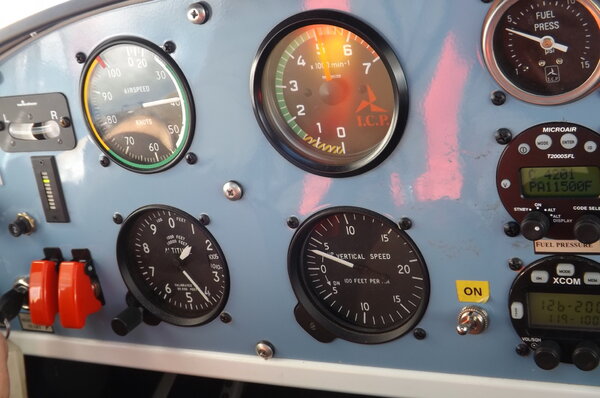

IBob Posted June 22, 2020 Posted June 22, 2020 There is another thread running here right now about VH-SGS, the Sonerai that ended up with various world records and a 24,000 ceiling. It is powered by a 912. And he had leaning. Does anyone know how he did that?????

skippydiesel Posted July 5, 2020 Author Posted July 5, 2020 Hi Ibob - forgive my ignorance - please spell out what you are trying to show in the above photo?
Bruce Robbins Posted July 5, 2020 Posted July 5, 2020 skippydiesel said: Hi Ibob - forgive my ignorance - please spell out what you are trying to show in the above photo? 11,400 feet
IBob Posted July 5, 2020 Posted July 5, 2020 Hi skippy..........nothing special.....11,400' and climbing. No doubt running very rich but no sign of rough running. Made it to 12,000 then went home.....) 1
skippydiesel Posted July 5, 2020 Author Posted July 5, 2020 Bruce Robbins said: 11,400 feet Thanks Bruce - sorry but I didn't pick that up - that's terrific - I actually already knew that a 912 ULS could keep performing, at least up into the low teens - I would however council you to be a bit circumspect, about such achievements (assuming NZ has the same altitude restrictions Au has).
IBob Posted July 5, 2020 Posted July 5, 2020 Thanks Skippy. We had obtained clearance for 12,000, which is why we stopped there. We also thought ATC would be having something of a laugh as they tracked our progress.................) 1
