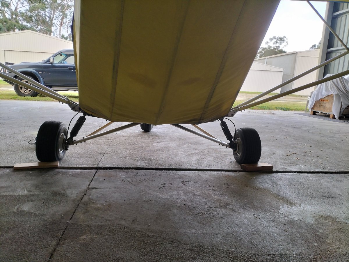

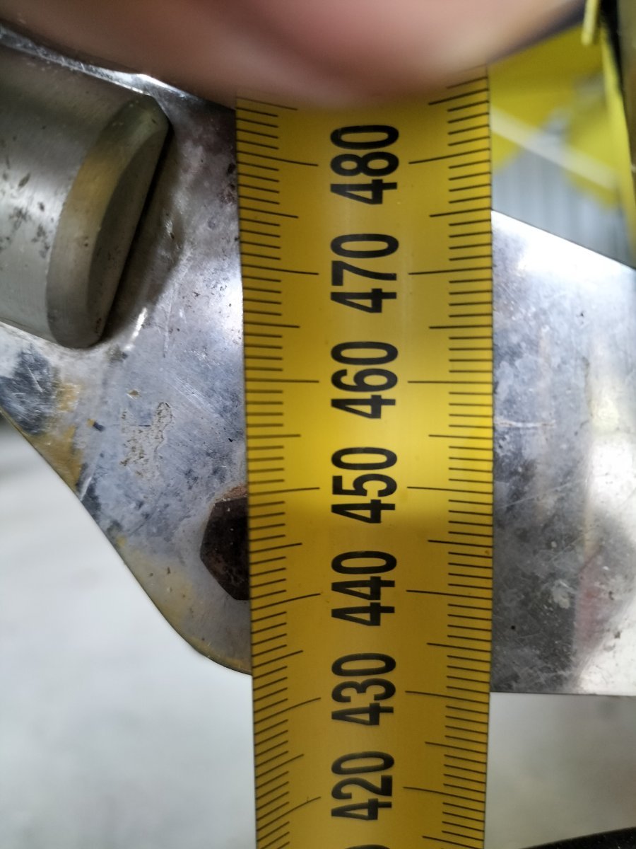

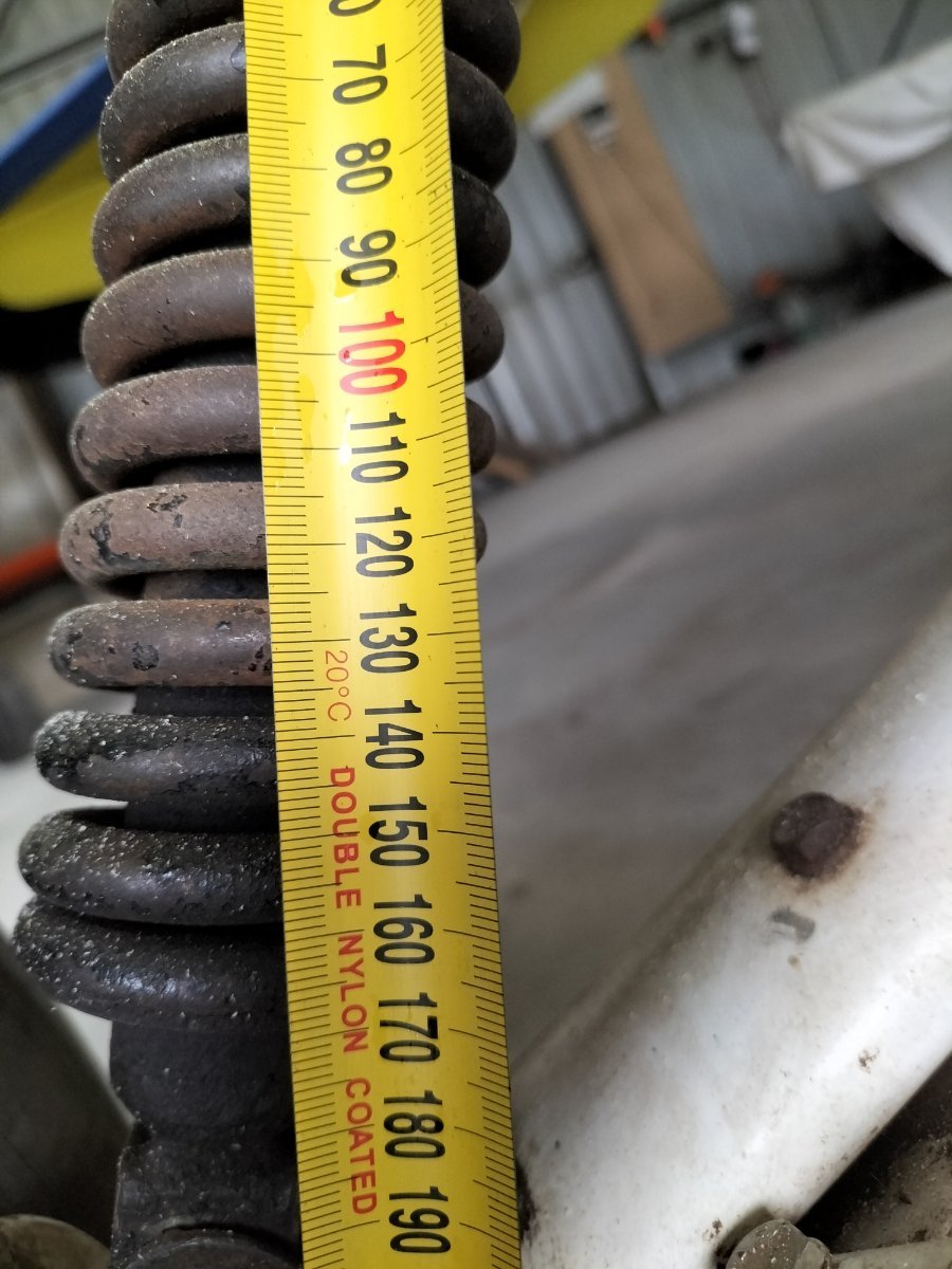

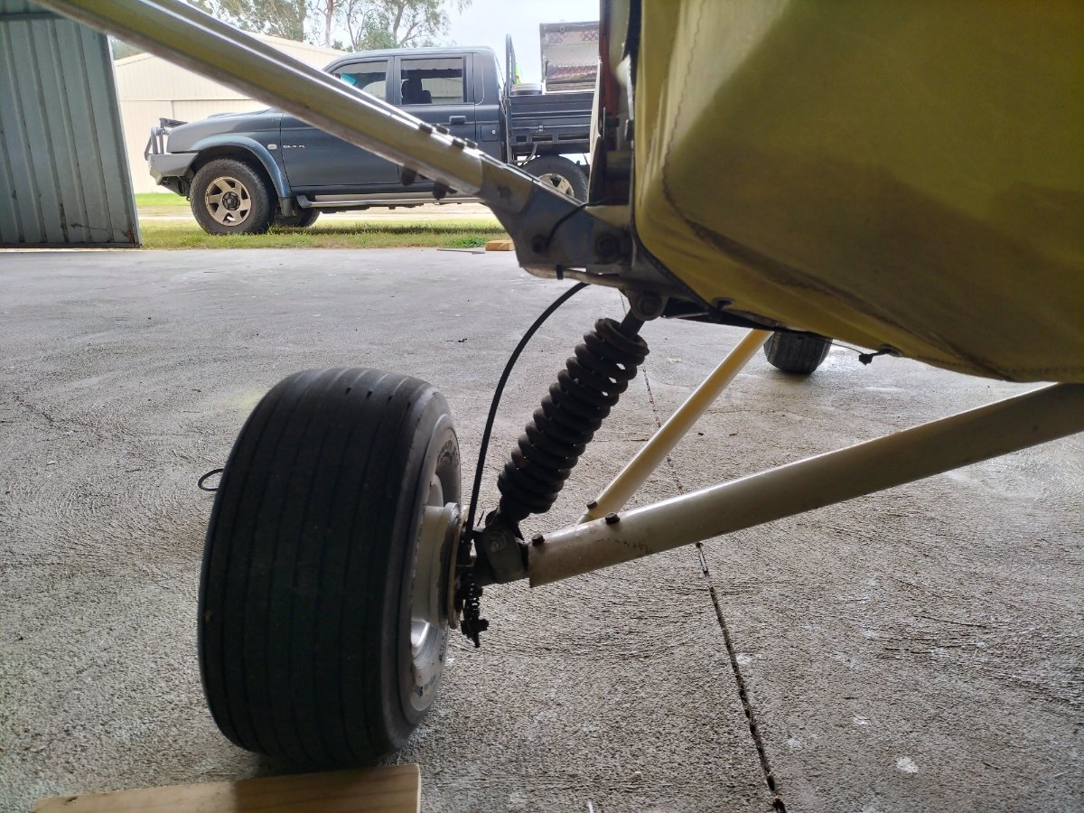

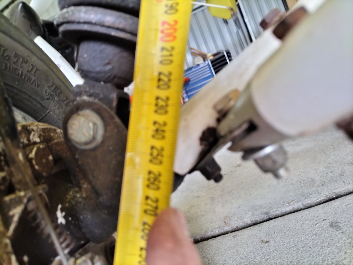

On 16/08/2023 at 5:40 PM, WinneyBuh said:
Good days for All!😇 Can I pullup this theme again? Now I 'm repairing X-air S, and have the similar problem.
Can anybody say, what is the length of main shock absorbers? I need the distance between centres of holes, when aircraft is standing on the ground.(Now  I have set of some ones, looking like from 'Honda Dio', but they have 260mm in free state. My craft is now completely disassembled and I can't measure this distance in assembly).
Another way to solve is to know the model of shock absorbers, described in upper messages or model of bike they are from.
Great thanks for any answer.🤝
IMG20230818161318.thumb.jpg.a379fce0e66f82a27311e4bf74564cab.jpgIMG20230818161242.thumb.jpg.a1c2cca343a3f44a8dc555cc9be22b1c.jpgIMG20230818161318.thumb.jpg.a379fce0e66f82a27311e4bf74564cab.jpg
Thanks!!!! I tried to recount spring stiffness whith measuring on photo- IT IS ABOUT 400 LBS/INCH. What about calculated 350 in my PDF-article? 😉
You wheels are excelent!
Now I'm starting attempts to find  anslogs.
How can I ever thank you? 😇
