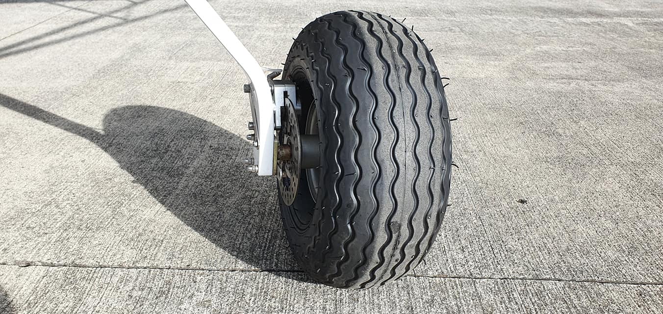

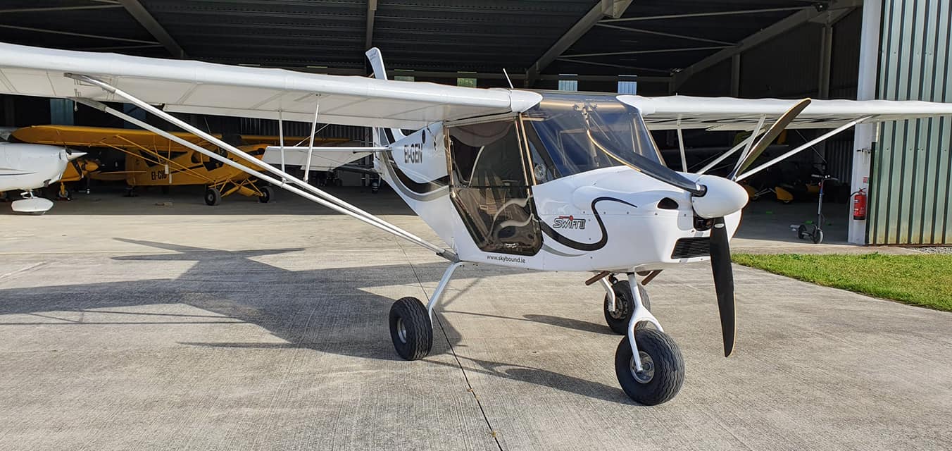

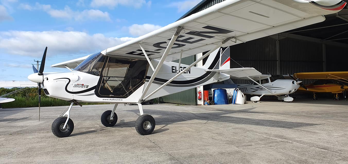

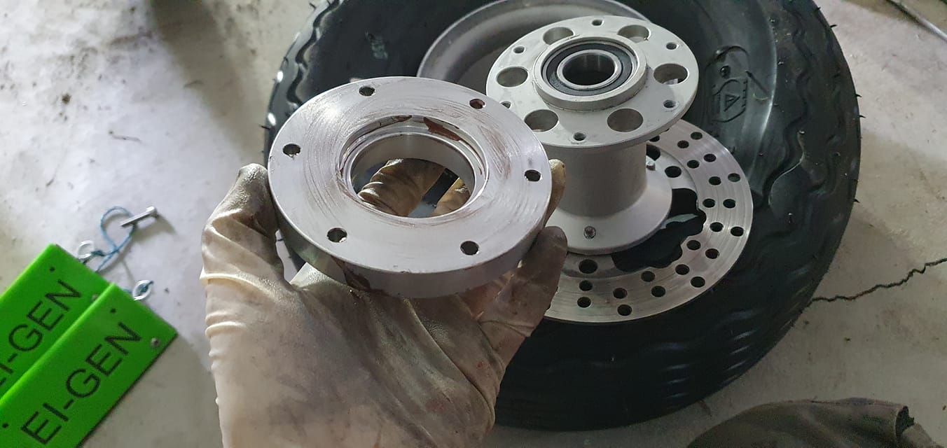

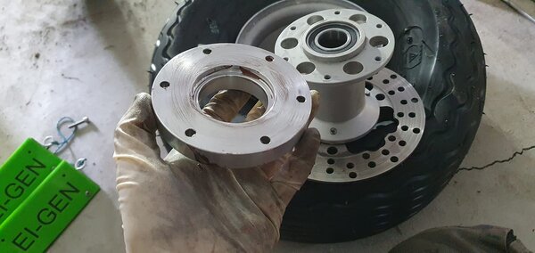

Blueadventures Posted June 7, 2020 Posted June 7, 2020 (edited) Bigger tyre kits are now available for Skyrangers. Just requires new nose fork, main wheel spacers and the rubber that fits the existing hubs. Edited June 7, 2020 by Blueadventures 2 1
Kyle Communications Posted June 7, 2020 Posted June 7, 2020 Mike..are you going to get a set of those?
Blueadventures Posted June 7, 2020 Author Posted June 7, 2020 Mike..are you going to get a set of those? Working towards it. Putting together an order with a mate to UK and the main wheel spacers are to be included, also looking at getting some of the 600kg wing bits so next wet season I can fit (need to undo wings and remove tanks to fit the bracket the front spar attaches to and fit the anchor point for the larger brace wire that is also required. Just want to have bits on hand for when the urge or opportunity arises. Don't want an upgrade to get the road of flying this good season. They are full steam ahead over in UK as just been signed off to do factory builds, developed a Swift 3 version and a new French approved design so just need the time to do the 600 kg undercarriage. getting the nose leg and fit is the easy bit. They are no doubt busy with the design, testing and loads of paperwork as they do things 100%. I might even look at making my own spacer and place a third wheel bearing in it to spread the load towards the outside, where the fastening is to hold the wheel on. Will make for better beach and rough strip operations; the reduction of speed will be good to know not that that matters. Cheers

Blueadventures Posted January 8, 2021 Author Posted January 8, 2021 On 04/01/2021 at 11:08 PM, Garfly said: A well-shod Nynja from the Alps of Provence: Thanks for posting Gary, I prefer the nose leg in my first post as it appears more beefy in the area of the fork to the leg attachment. Also the main gear legs are like those that Greg was trialling for Phillipe on his Nynja.
Blueadventures Posted January 8, 2021 Author Posted January 8, 2021 On 04/01/2021 at 7:41 AM, Dave T said: Blue adventures, Great setup!! Did you or someone else custom make the wheel spacers and nose fork? Or, can they be ordered? What size tires are you running? Hi Dave. I have not fitted these yet or purchased any kits. A mate and myself plan to buy in a set each in the very near future as soon as all parts are available. I have just made an inquiry about availability and where to purchase about half an hour ago as I was waiting until the start of the year to message them and they contacted me about 10 hours ago and said they are open again. If you like private message me your email address and I'll copy you with the detail and their contact so you can communicate direct to them. The bigger tyres will be good for off field operations. they take the Carlisle 8.00-6 4 ply tyres. Cheers.

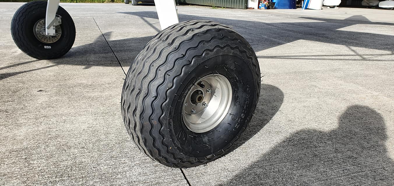

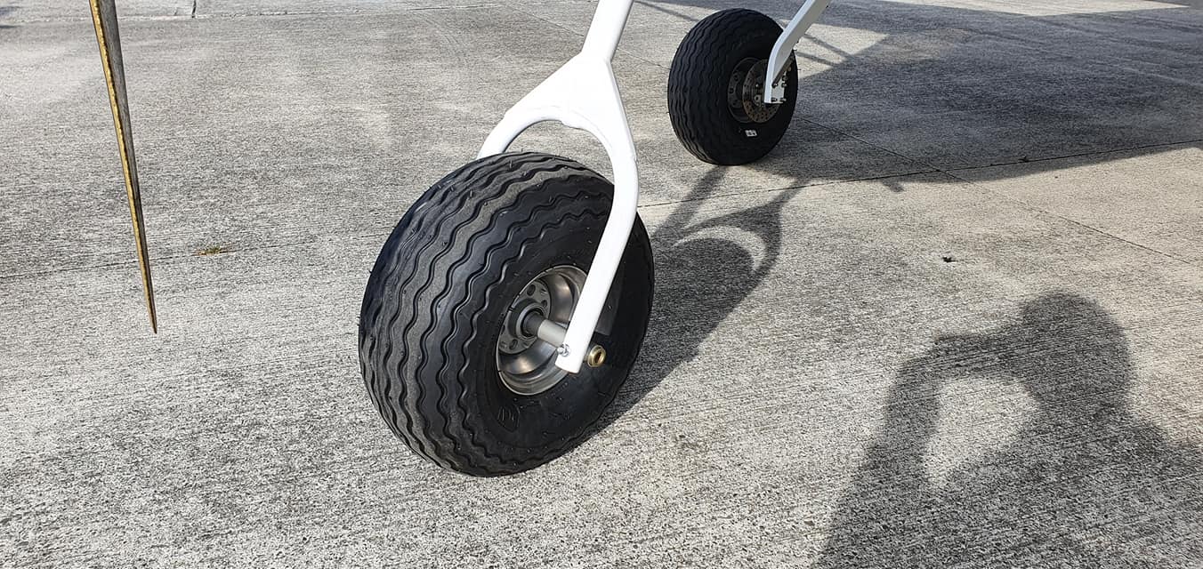

Blueadventures Posted January 15, 2022 Author Posted January 15, 2022 On 09/12/2021 at 9:36 AM, Bluecollaraviation said: Hi I've been away on a camping holiday, no phone reception so missed the question. 8 x 6". I'm fitting my mates at present, did the nose wheel this afternoon and will do mains tomorrow. Were waiting on availability of the the wider nose leg, supply chain and build quality issues so they are chasing satisfactory quality of build. 2images of the camping trip for 12 days in December.
