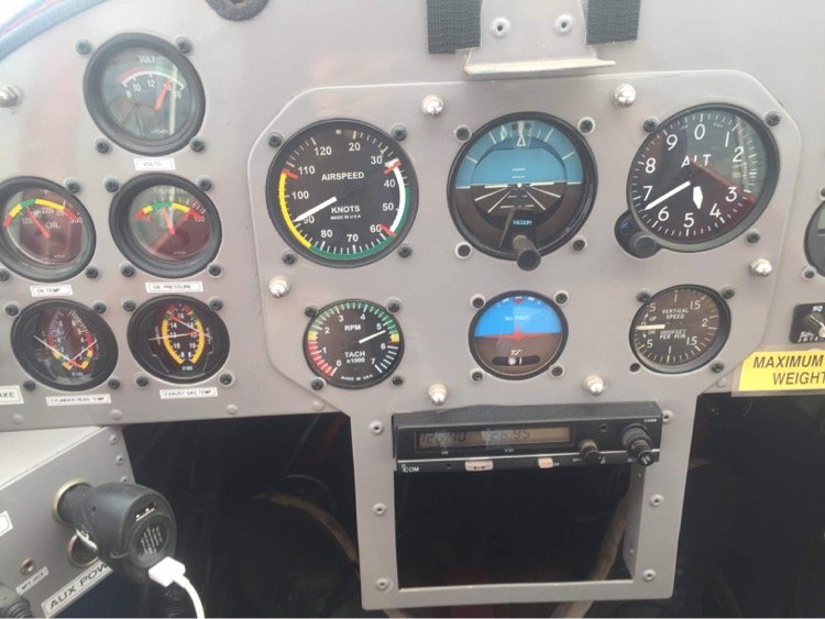

Kyle Communications Posted March 20, 2021 Posted March 20, 2021 A customer sent me some info today. He has a RANS S-7 short tail version. attached is the pic. 92kts cruise @ 5200 rpm Thats 8 kt increase in cruise speed Yes just landed. sent Today at 4:26 PM All good so far. I think the recommended setting was perfect. sent Today at 4:26 PM Bit lumpy air so I don’t have accurate figures yet. But looking like 8 Knots increase cruise. Climbing well but feels very very different. 2
Kyle Communications Posted March 20, 2021 Posted March 20, 2021 Some further info have been doing a few circuits. Climb rate is best at 70knots 1100fpm. Previously best at 50knots 1100fpm. 40knot climb is much less at around 600 fpm sent Today at 6:08 PM Pretty happy with it. Much easier to start. More responsive to throttle. Taken weights off the back for balance. Feels very different 1
