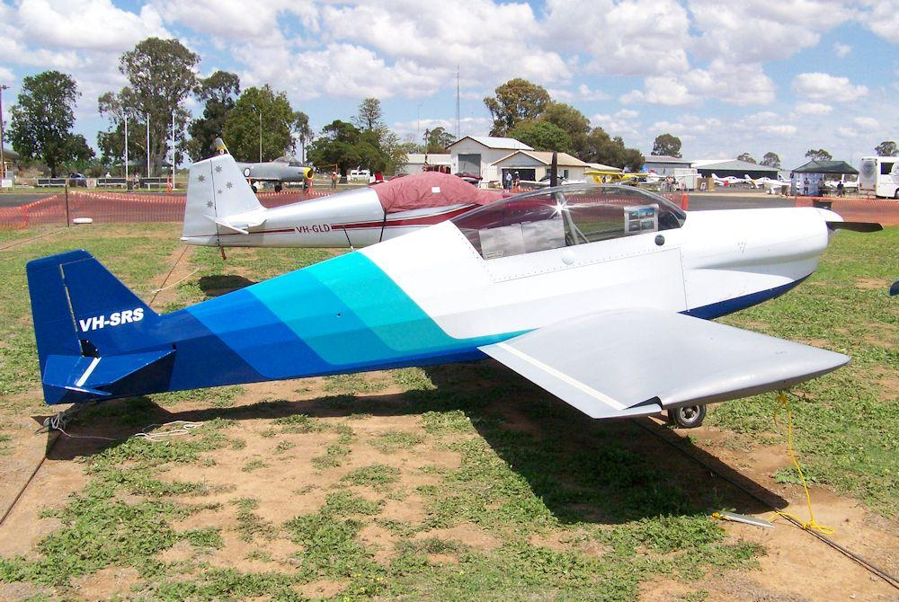

skippydiesel Posted June 22, 2020 Author Share Posted June 22, 2020 Found another photo of SRS - 2 blase prop, no wheel fairinfs and a good shot of gap seals in this pic Link to comment Share on other sites More sharing options...

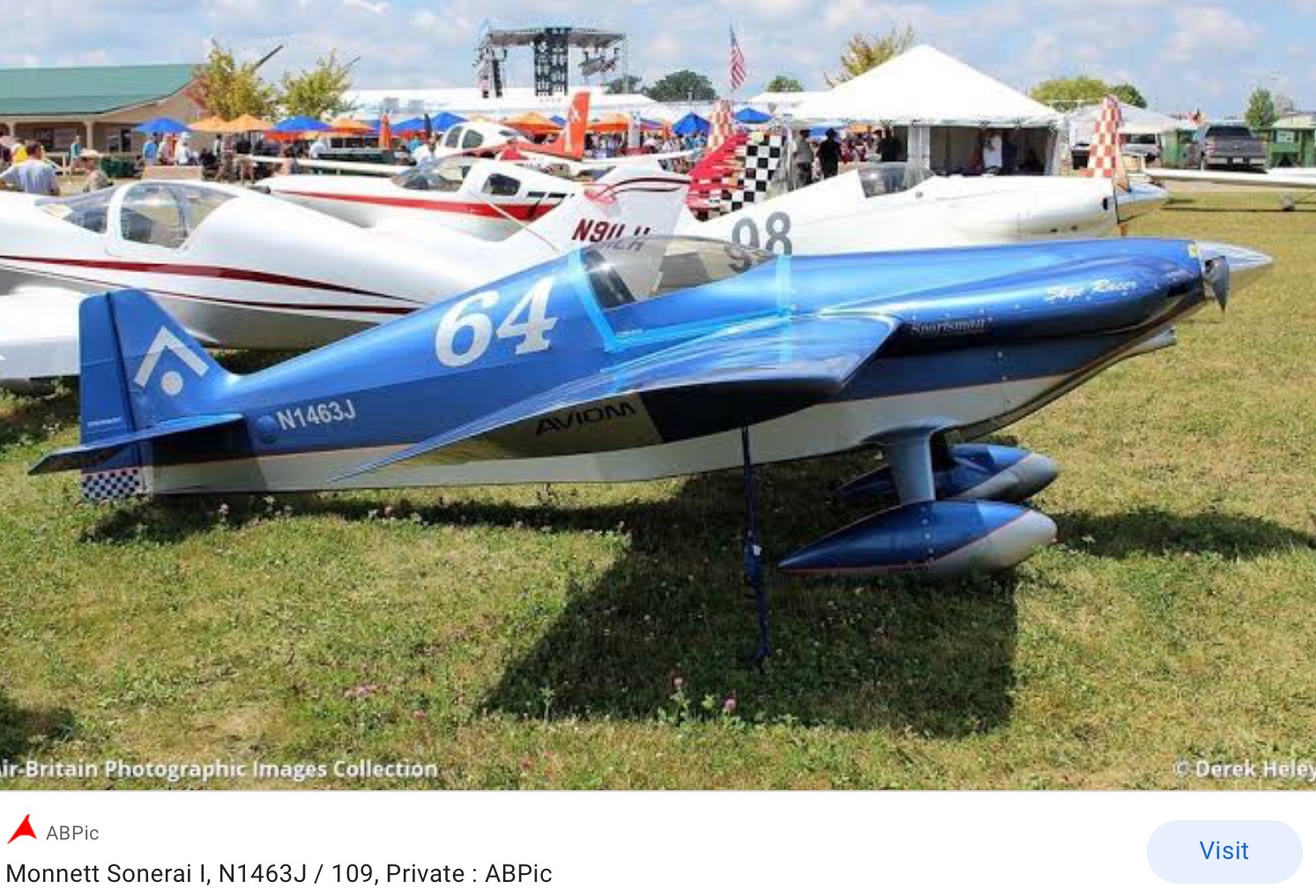

Flightrite Posted August 2, 2020 Share Posted August 2, 2020 Love the style of the Sonerai's, this is my fav, would love one of these? Link to comment Share on other sites More sharing options...
R Austin Posted August 2, 2020 Share Posted August 2, 2020 Love the style of the Sonerai's, this is my fav, would love one of these? This looks like Jeff Lange’s plane at Oshkosh. This is a really interesting and accomplished plane! Nice chap too. Very generous with his input to the sport and type. Well worth reading up on if you can find his threads. If anyone has a current contact for Jeff, I’d be really interested in touching base with him. He seems to have dropped out of the scene a few years ago. Robin Link to comment Share on other sites More sharing options...

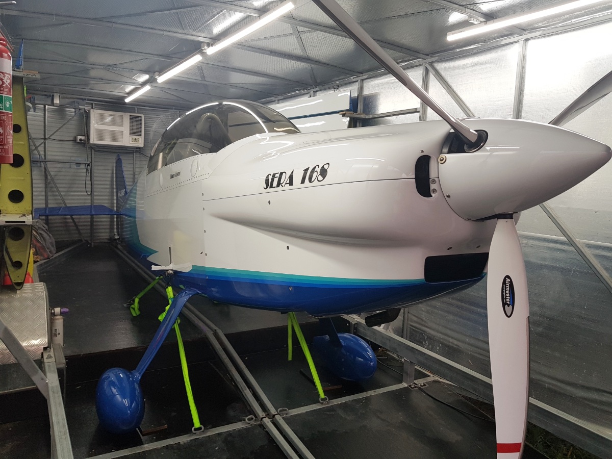

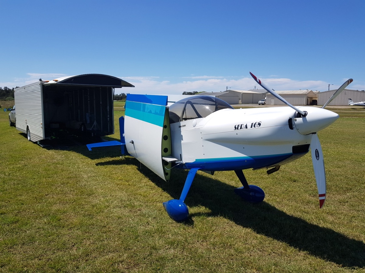

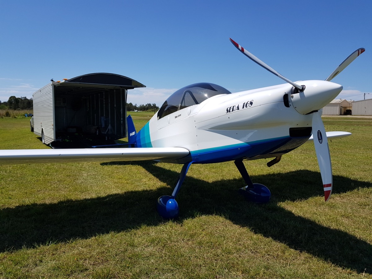

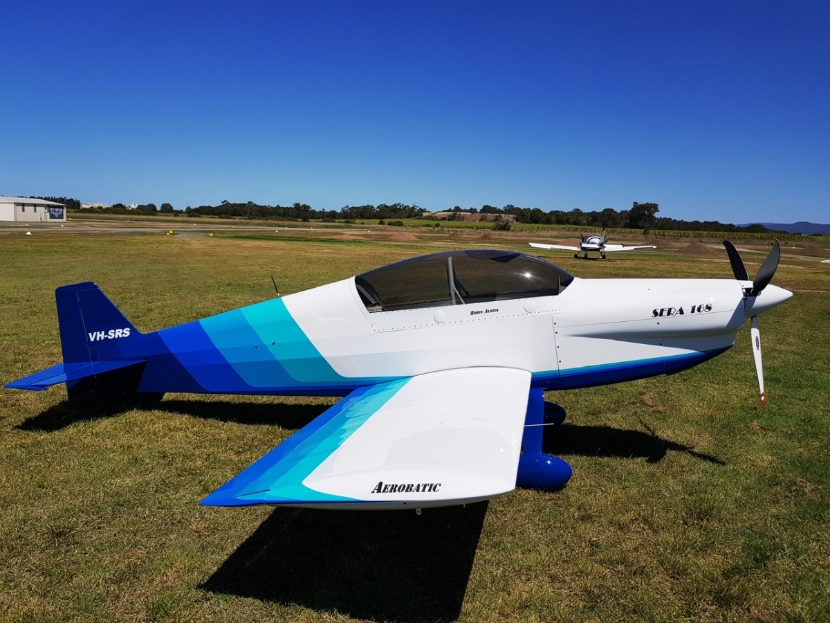

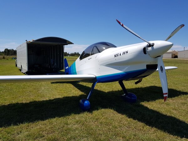

R Austin Posted October 17, 2020 Share Posted October 17, 2020 Hi. Here is the description of SRS that I promised. Apologies for the formatting. SERA-173 (VH SRS) is the 3rd aircraft in my journey of developing evolutionary aircrafts originally based on the 1970 Monnett Sonerai II design. The mission was to build the smallest most efficient 2 seat aircraft outside, with the biggest achievable cockpit inside. SRS is likely the first Rotax 912 aircraft capable of carrying 2 large adults whilst achieving genuine RV series performance. Although maintaining Sonerai heritage, SRS is considered sufficiently divergent from the original Sonerai design to warrant a new name, hence the SERA-173 (Stands for Sonerai -Evolution -Robin -Austin - 173 knots max cruise speed) Broadly speaking the SERA 173 specs and differences from a standard Sonerai 2 are as follows (all solo) Max continuous cruise speed 173 Kts All day everyday cruise speed 165 Kts (24”/4800rpm) Economy cruise - 160 Kt at 15.2 L/hr Aerobatic +6G -5G VNE 180Kts (testing included full range flutter testing up to and including 200Kts) 300Kg empty - 600KG MTOW – 300Kg payload RV10 cockpit dimensions - comfortable for 6’5” pilot, 6’2” PAX (Sonerai volume +67%) Centreline flying from front seat High strength crash resistant zone around pilot (2.5X FAR23 requirements) Airframe structural strength = Sonerai +25% Airframe efficiency = Sonerai +72% Stall speed slightly less than Sonerai II (minimum solo 39Kts) 1250 NM range at 160 Kts 1700 NM range at 100 Kts Also comfortable at 70 or 80 Kt “loitering” speed Constant speed propeller with latest Sensenich high speed blades 23” prop clearance for gravel strips Full span (30 degrees deployment) electric flaperons Horizontal Stabiliser - electric inflight adjustable Rotax 912 reliability and operating costs Although now flying for 150 hrs over 3 years, SRS is still “work in progress” hence the temporary SERA 168 logo (which was based on the target design cruise speed). SRS also features 1-person-easy-folding wings to minimize hangar space requirements, or in this case negates the need for a hangar as its current home is a custom built, generous sized, air-conditioned enclosed trailer (See photos attached) which doubles as a hangar and workshop and lives right outside my garage (I can play with my toy anytime!). The design, construct and refinement project (including trailer) has taken 8 (enjoyable) years and development continues. Robin 1 1 Link to comment Share on other sites More sharing options...
R Austin Posted October 17, 2020 Share Posted October 17, 2020 2 Link to comment Share on other sites More sharing options...
R Austin Posted October 17, 2020 Share Posted October 17, 2020 The pics are a bit grainy. I compressed them too much. I’ll try again. Link to comment Share on other sites More sharing options...
R Austin Posted October 17, 2020 Share Posted October 17, 2020 Ok, too much resolution. Won’t open now. Sorry about the false starts, but it seems I can’t delete once posting. 1 last try. 3 Link to comment Share on other sites More sharing options...
R Austin Posted October 17, 2020 Share Posted October 17, 2020 Hi Lyle. Good to hear from you! Yes, the wing fold is essentially as per original Sonerai plans, but I just refined it all the way through construction so that it is a genuine easy and fast 1 man job. I trailer it and set it up for each days flying. About 140 times so far. Keeps getting a bit quicker as I think of little refinements. 5 min to unload and 5 min to assemble and preflight. Quicker if I need to be. Typically 10 minutes from arriving at the airfield till turning the key. Might be a bit of a job retrofitting it to a finished aircraft though! Cheers Robin Link to comment Share on other sites More sharing options...
