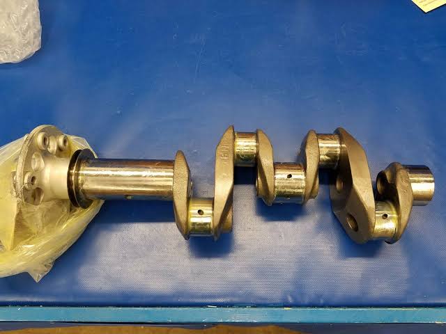

Thruster88 Posted June 29, 2020 Posted June 29, 2020 Facthunter I think you missed part of the point: I wasn't suggesting fins were heavy. What I was saying was that with liquid cooled heads (and less fin there) the cylinders can then be moved closer together...so the crankshaft gets shorter, as does the crankcase..... I personally would not like any of the meat to be removed from my crankshaft just so the cylinders can be placed closer together but each to their own, lycoming crank shown, gasp! Only three mains, what were they thinking 1
