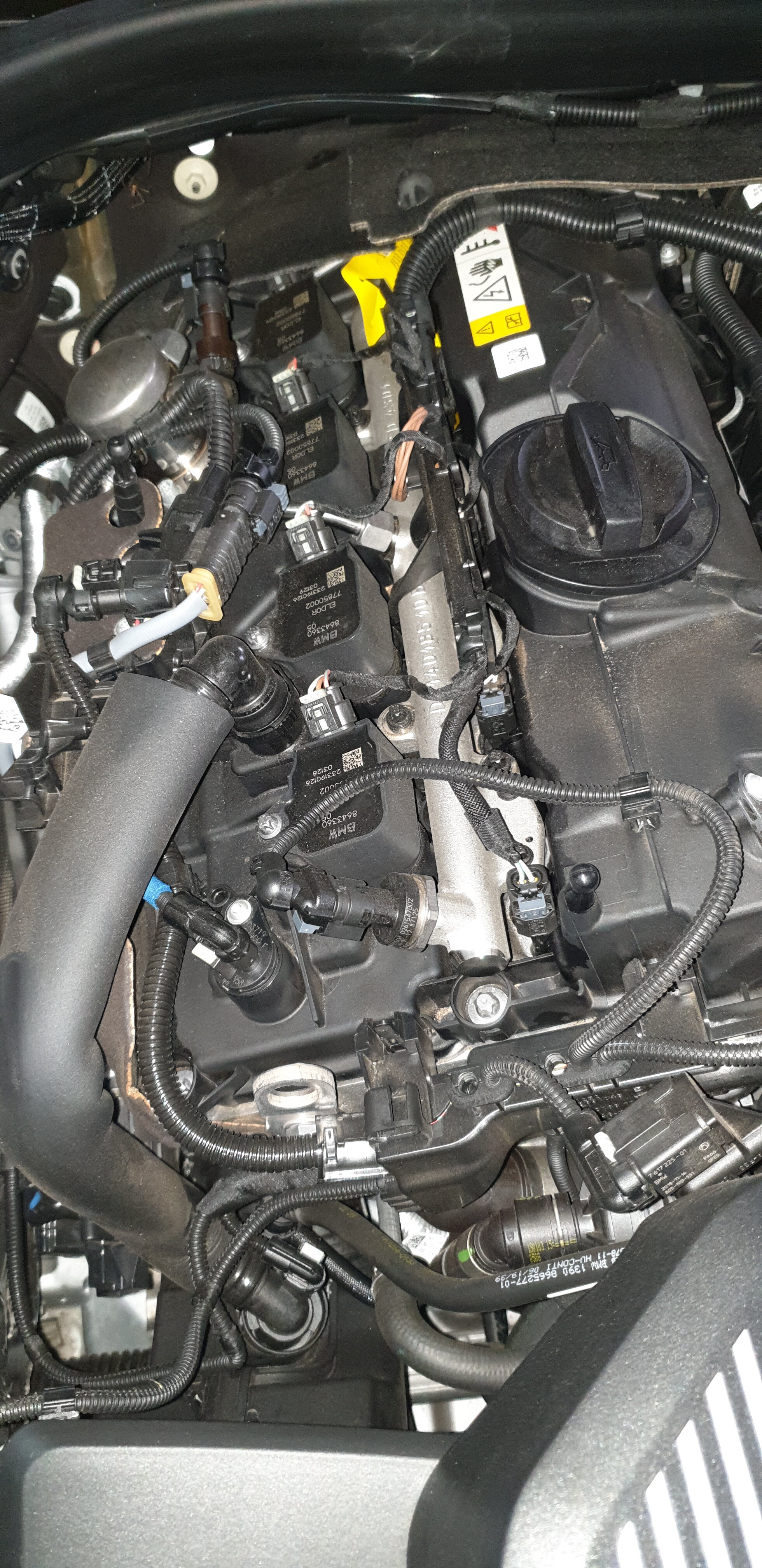

Turbo, I have heard about sparkles engine technology. I thought at one stage my vehicle may have had one. However I found spark systems. Are they for starting, what can you tell about sparkless engines. Attached images is my engine with the cover removed

The first production of these is the Mazda Skyactive-X
It's called Homogenous Charge Compression Ignition (HCCI) where the mixture auti-ignites in an exothermic process.
Spark is not used to ignite the mixture but the system has its pluses and minuses compared to Otto or diesel cycle, and Mazda uses spark plus for part of the process and call it "Spark Controlled."
There is plenty on Wikipedia for the Skyactive-X, but you'd have to go to industry sites for the latest developments.
I think I can see 3 plus a bit of another spark plug actuators on yours; that's similar to the current petrol/spark plug engine.
