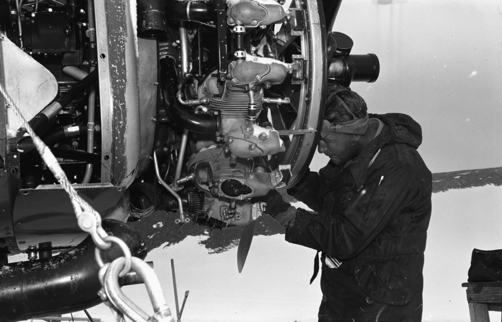

Thruster88 Posted July 4, 2020 Posted July 4, 2020 Beavers effectively have two fire walls, the first is bolted to the back of the engine. The crack was right at the cylinder head and would not have opened up pre impact. The cooling airflow would carry any leak overboard. In the pic the exhaust has been removed from the cylinder the guy is working on. The second fire wall containing the magneto access covers is on the far left. Hopefully the ATSB will provide all the methodology of the tests they conducted on the exemplar aircraft 1

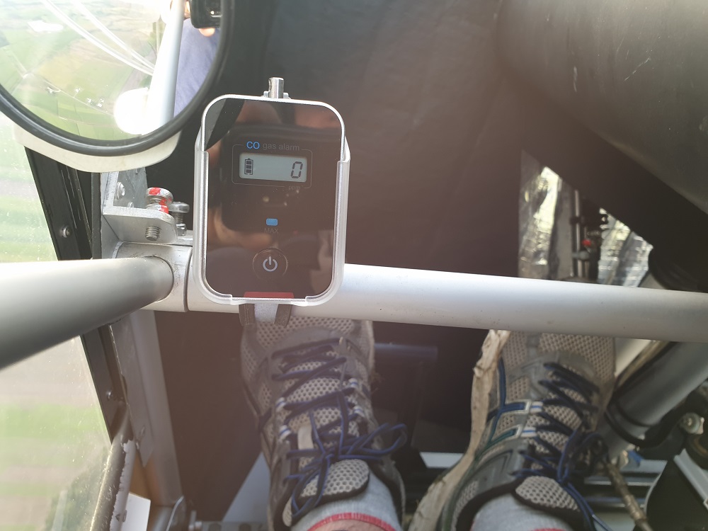

Blueadventures Posted July 5, 2020 Posted July 5, 2020 A major wake up call for me.......need to get myself a good quality detector. Hi Jack This is one I have fitted, it calibrates and gives reading and manual tells you what the effect / exposure time will have on us. $99 US from Aircraft Spruce. Was $150 AU when I got it. Only other type I would use that's cheaper is the long life Co detector card at about $26 AUD but I could not source any so got the dearer one. 1
