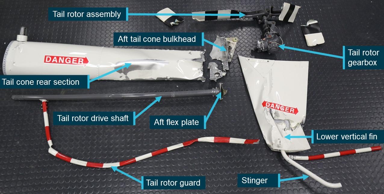

onetrack Posted July 6, 2020 Posted July 6, 2020 The ATSB Chief Commissioner, Greg Hood has been quoted as stating - "ATC provided clearance for the aircraft to become airborne about three nautical miles north of Broome airport". "[Control] observed the aircraft to climb above the treetops, when the aircraft appeared to enter a spin, and impact terrain in the industrial area just north of Broome." From the eyewitness reports, it is starting to appear like a mechanical failure in the drive to the tail rotor, or in the tail rotor itself, is going to be the focus of investigations. 1
onetrack Posted July 10, 2020 Posted July 10, 2020 Well, the crash cause is now pretty obvious. Tail rotor, gearbox and empennage separation in flight. ATSB quote: "The tail rotor gearbox assembly, tail rotor, and empennage assembly separated soon after the helicopter lifted off". A previous pilot of the chopper reported "unusual vibrations", but upon examination, ground crew are reported as having done testing, and found nothing wrong. But something was obviously very wrong, and they failed to pick it up. https://www.abc.net.au/news/2020-07-10/atsb-says-tail-rotor-separated-before-broome-helicopter-crash/12443298 1
onetrack Posted July 10, 2020 Posted July 10, 2020 The area of greatest concern with this R44 is that it was built in 2018, and had only accumulated 268 hrs, TTIS. One can only surmise the tail area must have been damaged inadvertently at some stage, and no-one picked it up. Ground-handling damage, perhaps? 1

Datson Posted September 3, 2020 Posted September 3, 2020 If the rotor gearbox, rotor and empennage separated from the aircraft then that indicates an attachment failure. Given the size and function of those components I guess that they would have been attached by several bolts to a structural part of the aircraft. So it seems strange that the cause of the attachment failure was not readily apparent upon examination eg missing/broken bolts, broken attachment points, etc. Be interesting to know the details of the attachment setup.
onetrack Posted September 3, 2020 Posted September 3, 2020 (edited) I get the impression from the photos the entire tail structure (rotor, gearbox and driveshaft) tore away from the tail boom cone. So the suggestion is the tail boom cone structure failed catastrophically. There are eyewitnesses who saw the tail rotor and gearbox fall off in flight shortly after takeoff. But the ATSB are being very careful with the investigation and obviously want to find why the structure actually failed. Bear in mind it underwent inspection and ground testing just prior to the crash, and nothing was found wrong. But both the pilots picked up kickback vibration through the pedals in previous flights, and they were obviously interested in finding out why this was happening. However, the fact that the engineers didn't carry out a hover test, with actual flight, seems to me to be a major inspection error. One always tries to replicate the appearance of a problem or problems by testing as closely as possible to the actual conditions where they appear. Then there's the possibility that cracking of the structure was overlooked in the hunt for a mechanical moving part that was being pinpointed as the potential problem. I can recall a media Jetranger crash in central Sydney in the 1970's where the tail rotor failed catastrophically. It took the investigators quite a while to find that an important washer was missing from one of the tail rotor bolts. They had to find whether the washer failed in flight and flew off, or if it was left off in recent repairs. They then went through the rubbish bins at the maintenance facility and discovered the missing washer. It had inadvertently been missed and left off, upon re-assembly. Edited September 3, 2020 by onetrack

Jase T Posted September 3, 2020 Posted September 3, 2020 It could (and i am being an armchair investigator here) be as simple a shedding one tail rotor blade. The vibrations from that would probably remove the TR gearbox from the aircraft. The weight shift combined with fuse rotation probably did the rest!!
