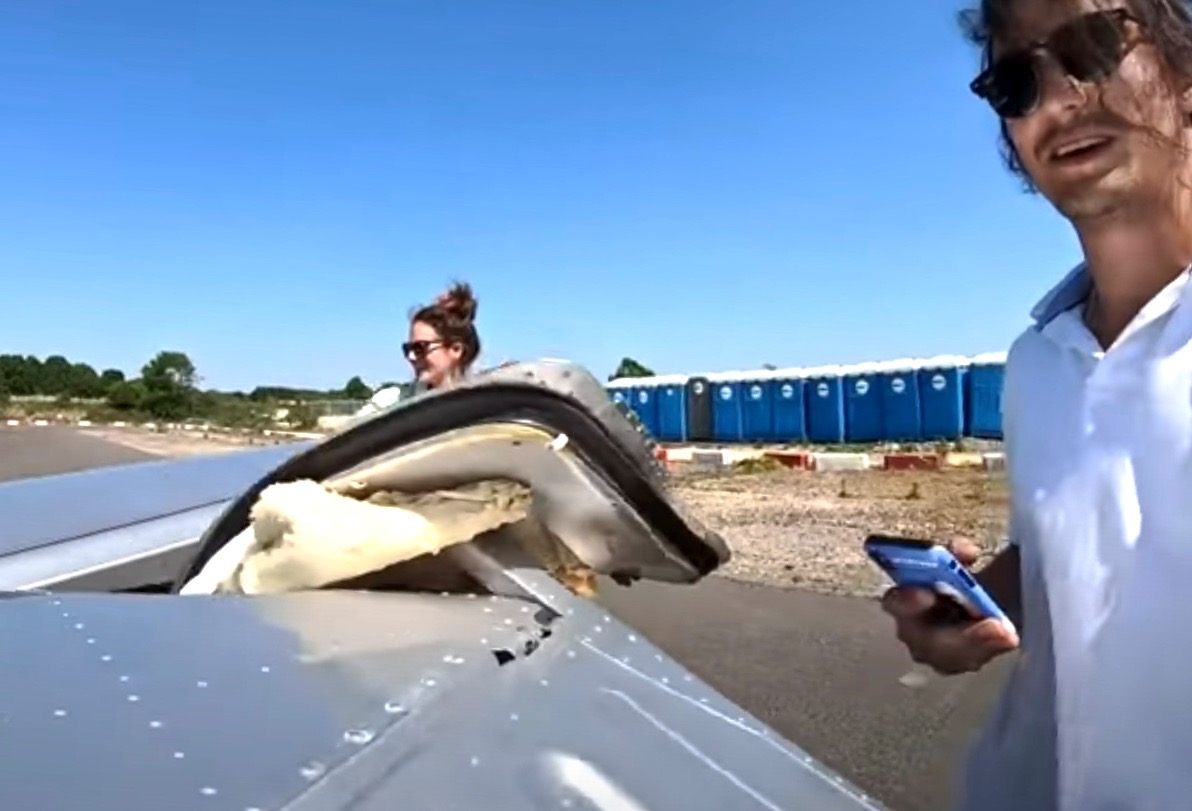

The baggage door could be seen on the tail by the pilot, not sure why the sudden need for a steep turn while keeping the airspeed high. The row of portaloo's at the end finished the video nicely.

Nev, I'd have thought that seeing (and feeling) a door wrapped around your tail-feathers (with the extent of the damage unknown) would be attention-grabbing of the emergency kind. Wouldn't you say?
And I wonder if the fast landing might have had something to do with the limited elevator travel available.
Doubt that anything to do with a control problem, the guy didn't show any control handling checks which most well trained drivers would have, he just panicked. The fast landing I'd due the gear was still up till the last minute and the guy was panicking!
When you suspect structural problems you use slow flight. If you think you may have limited travel (control authority) you go upstairs (safe height)and do a slow flight routine to prove the planes lower speed capability/handling so you can have more confidence in doing a normal landing.. I think the entire tail including rudder moves on a Mooney. They didn't spend much effort even looking out the back.. Coming in at warp speed for a slightly controlled crash they had a bit of luck in surviving, was totally unnecessary. Nev

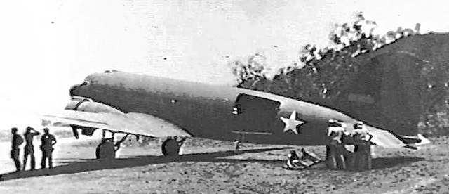

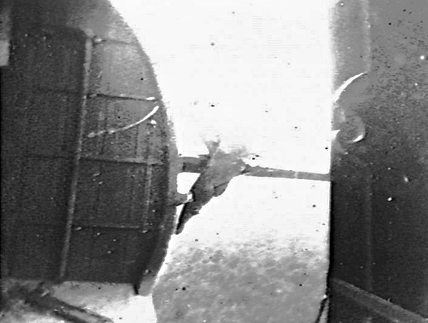

As it happens, I have a particular interest in this incident because it puts me in mind of a war-story told by my late father.
He was aboard an American C47/DC3 helping to push supplies out to the troops re-taking Kokoda in November '42 when they managed to nudge the rear-cargo door into the slipstream (the forward door having been left behind, this other one was 'secured' by ropes).
In a flash, of course, it was off and gaily decorating the port horizontal stabiliser.
Dad was actually serving in an RAAF airfield construction squadron at Wards 'drome, but for extra adventure he liked to volunteer on the biscuit bombers.
He had a camera with him that day (contrary to regs, I believe) and took these snaps.
This is the aircraft (named 'Irene') after it managed to land safely back at Moresby.
(Otherwise, you surely wouldn't be reading this. My siblings and I owe it all to the structural integrity of the Gooney bird ;-)
The errant door can be seen lying on the ground in front of the tailplane. It'd only fallen off during the landing roll.

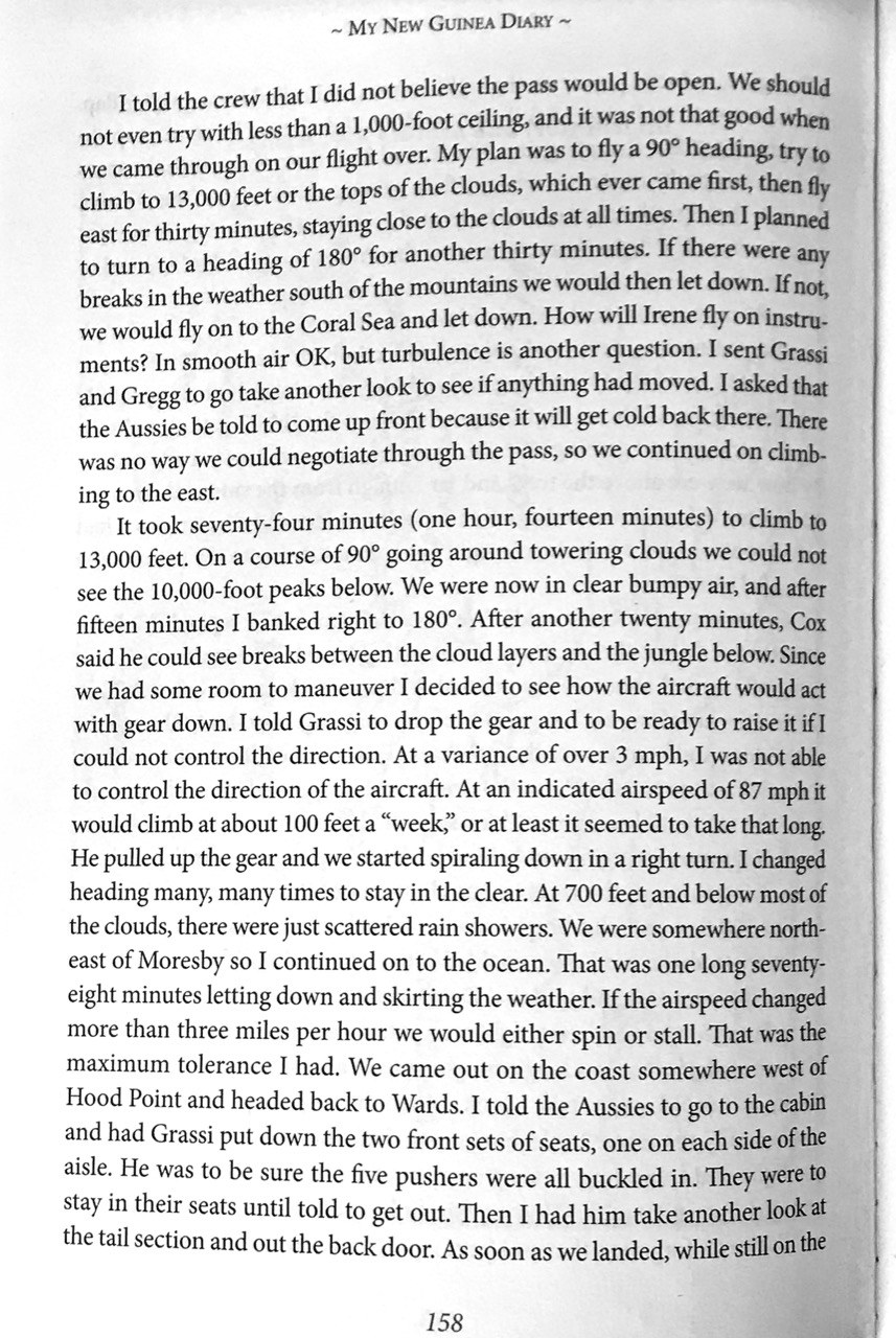

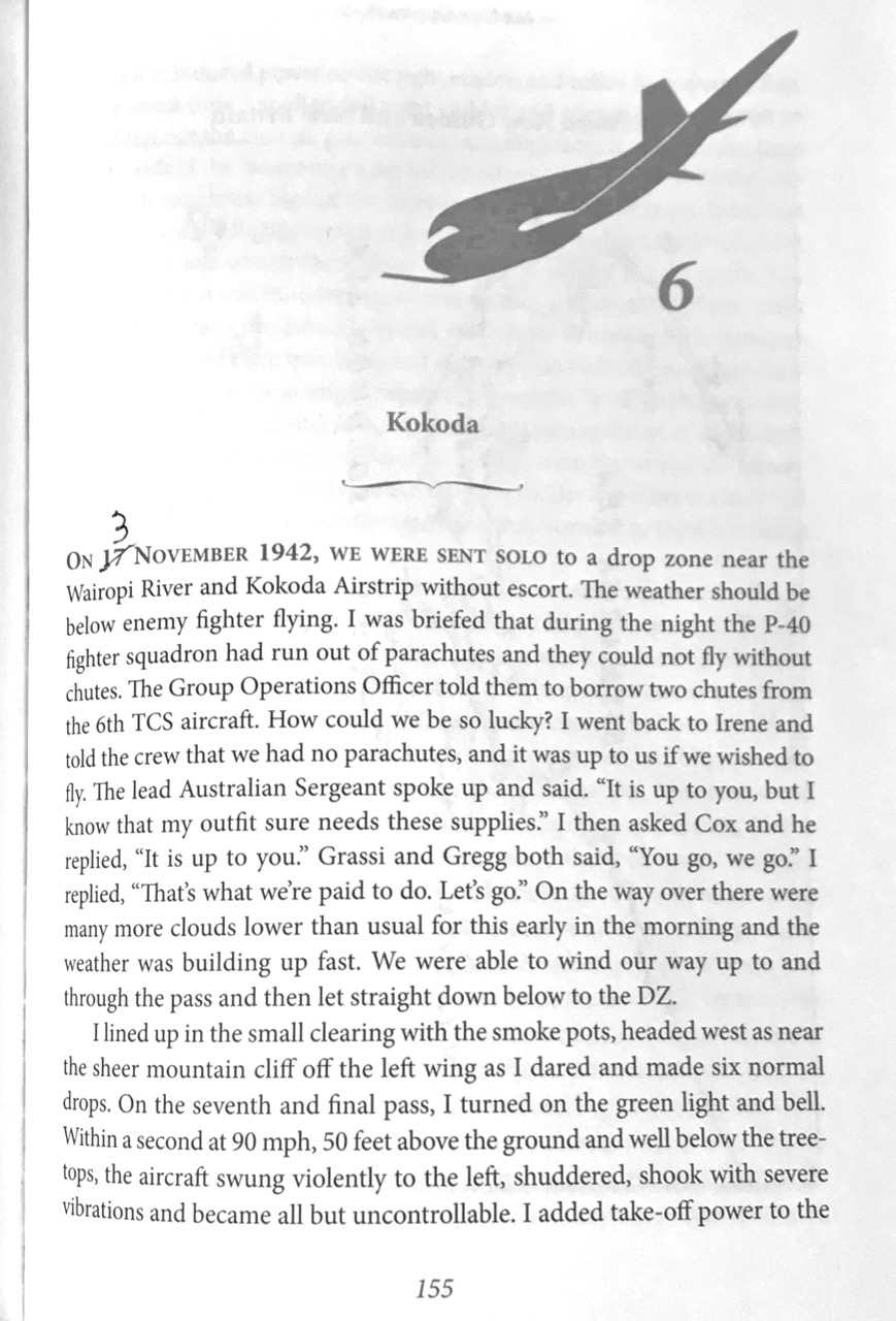

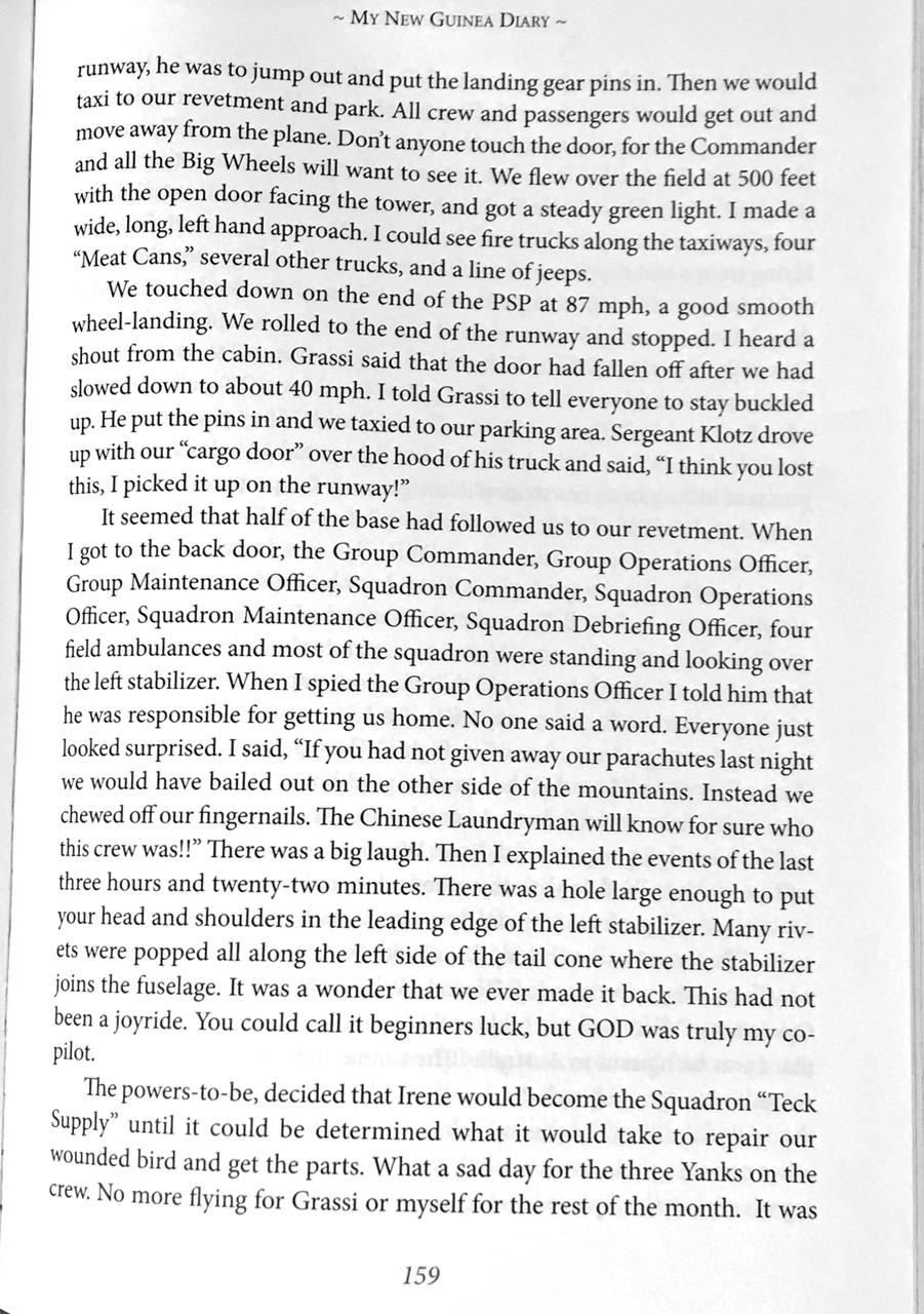

As it happens the pilot of that aircraft, Ernie Ford, many decades on, wrote a book about his war called "My New Guinea Diary"
For anyone interested, the tale above, is told over the following 4 pages:
(I notice that dad, who actually wrote up the incident in his own diary, has corrected the date as written in the book.)

A Good story. Those doors are very substantial as is the whole DC3- C47? Douglas made the best airframes in the world at that stage..Nev

Door was latched not locked outside. Gave everything a good tap & tug in preflight and checked over my shoulder at the inside latch on power checks , all ops normal. The AC only came back from annual ARC yesterday which is playing on my mind.
With the debris on the wing and the new hole in the fuselage I could feel the extra drag (you can see me fighting the yoke with two hands in the video) the AC wanted to roll right and pitch nose down, it was a challenge to keep her level, the trim definitely helped. I tried to keep the air speed above 100kts all the way round until final putting out the gear and last notch of flaps at the last second 10ft above the ground.
