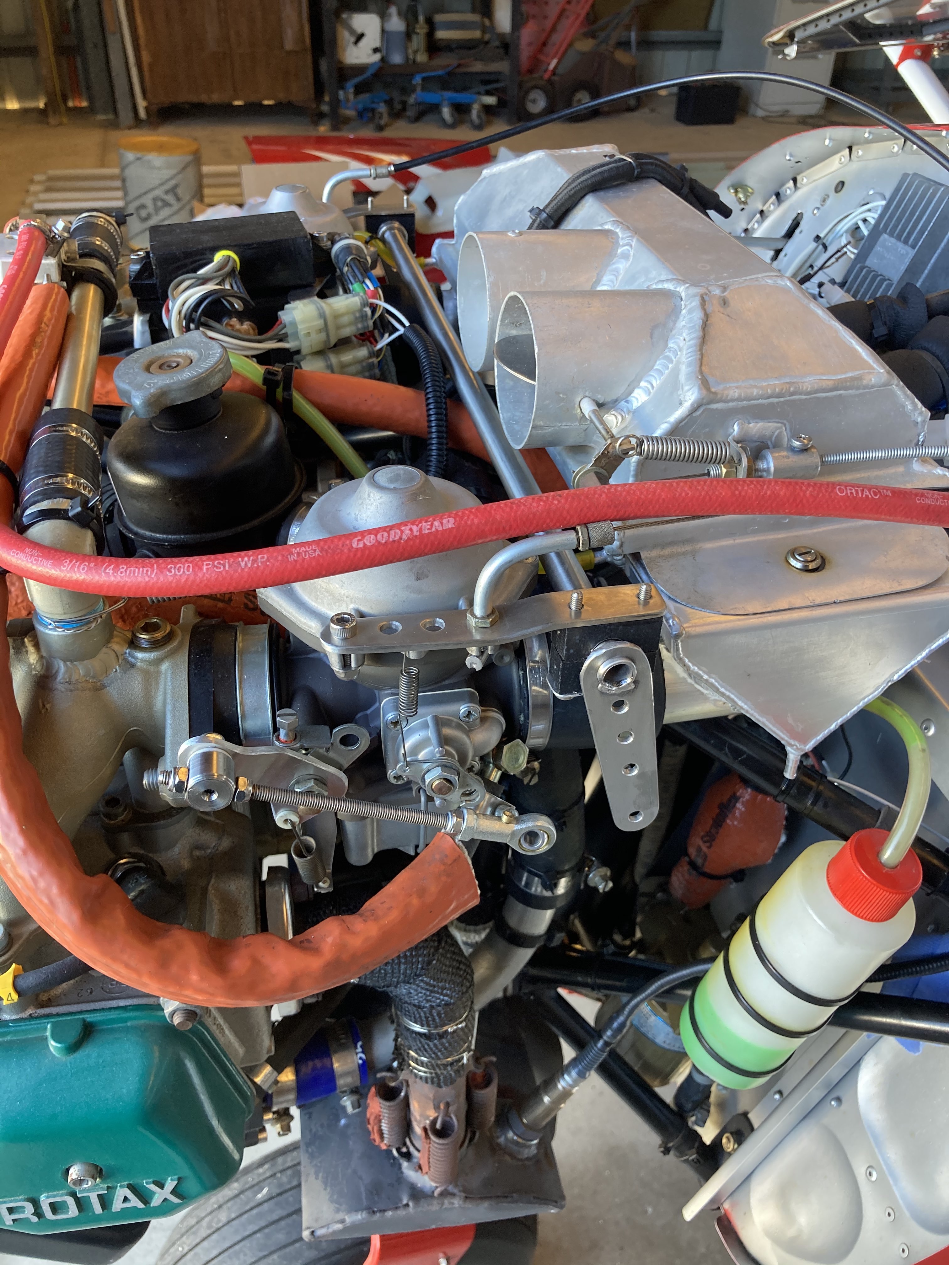

Kyle Communications Posted May 22, 2024 Author Posted May 22, 2024 3 of the 6 are gone already Nev, Two were done last night and one ordered this morning. All paid and I have dropped off to the post office this morning. It doesnt matter what aircraft it is it just bolts to the rotax. The only issue is the person has to organise how they connect to my throttle lever that controls the system. No one has had any issue so far.

Kyle Communications Posted May 22, 2024 Author Posted May 22, 2024 Nev I didnt take your comment like that at all...I know exactly what you said though. Being in business for more than 30 years and designing many products I have been in that position before and its a gamble when ever you do anything like this. I have been lucky though as the 3 things that I have put out there for the aircraft community so far have been very successfull...sometimes I think too successful. The flap bracket I designed for the Savannah I sold more than 50 sets..I still. get calls for them but getting the 63 thou 6061 T6 up here to Brisbane for it is very problematic now....the freight is 2 times the cost of the sheet. The replacement CDI modules for the Rotax I made..which started out as a sort of hobby job for a couple of local friends up here grew legs and turned into a monster with now more than 500 units sent all over the world The Throttle bars are up to around 30 now I think The issue is now getting the time to make all this stuff as I prefer to do it myself to keep the quality as high as possible. being retired now I thought I would have a bit more time to allocate to doing these but it turns out I think I am busier than I was than when I was working and doing all this as well. Just had a order from a guy in NZ this morning who wants 4 CDI...They are the last 4 that I have in stock so have to get to making another batch. No rest for the wicked ! 4

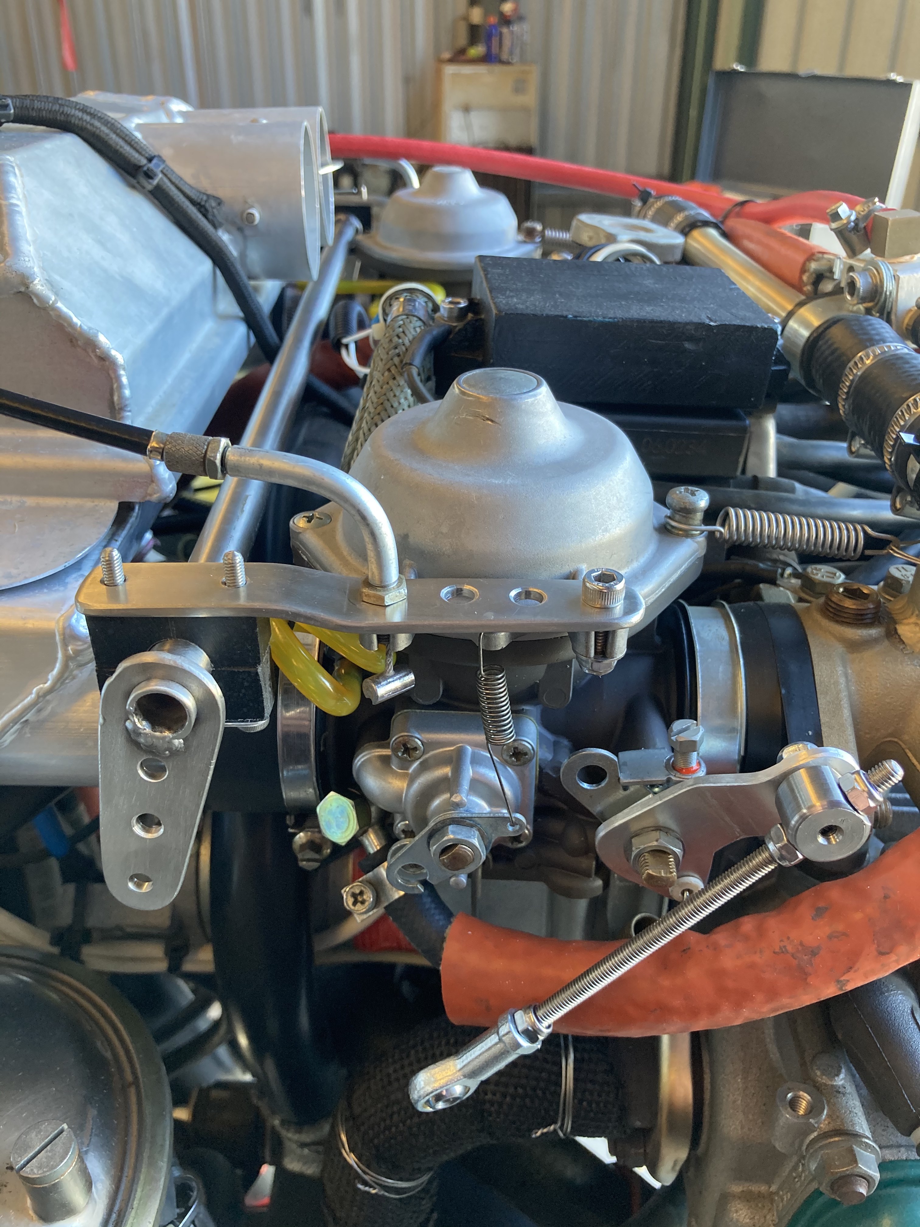

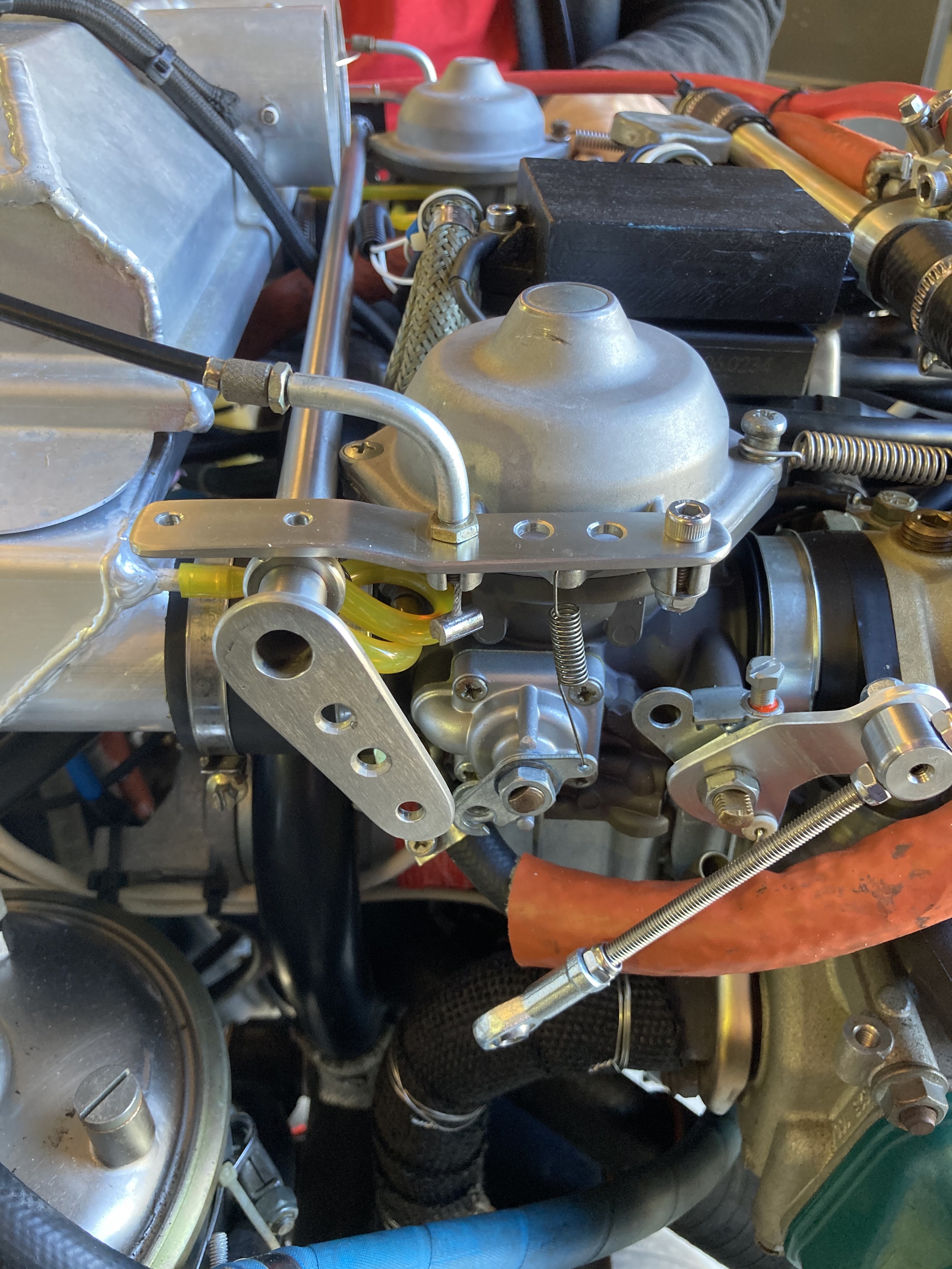

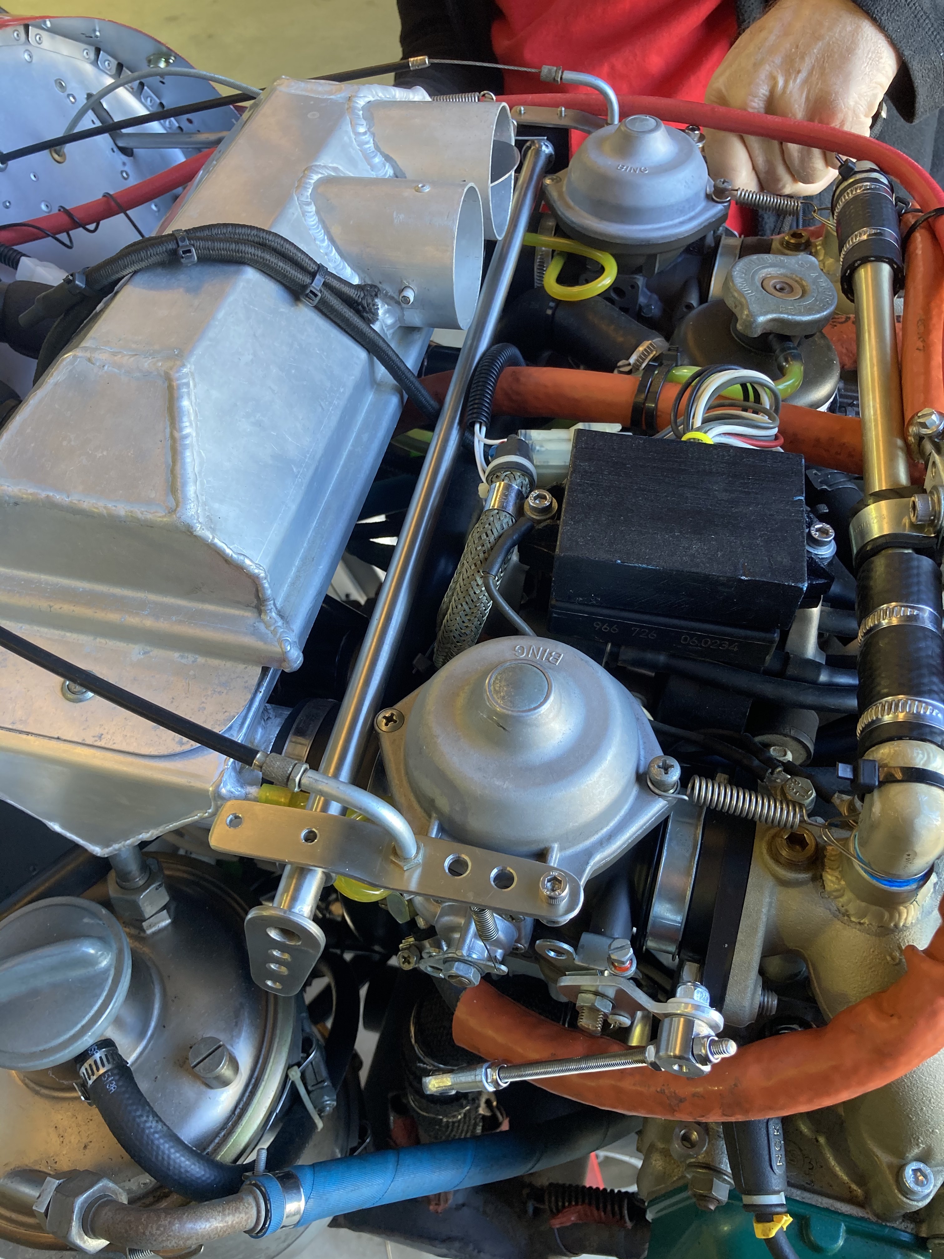

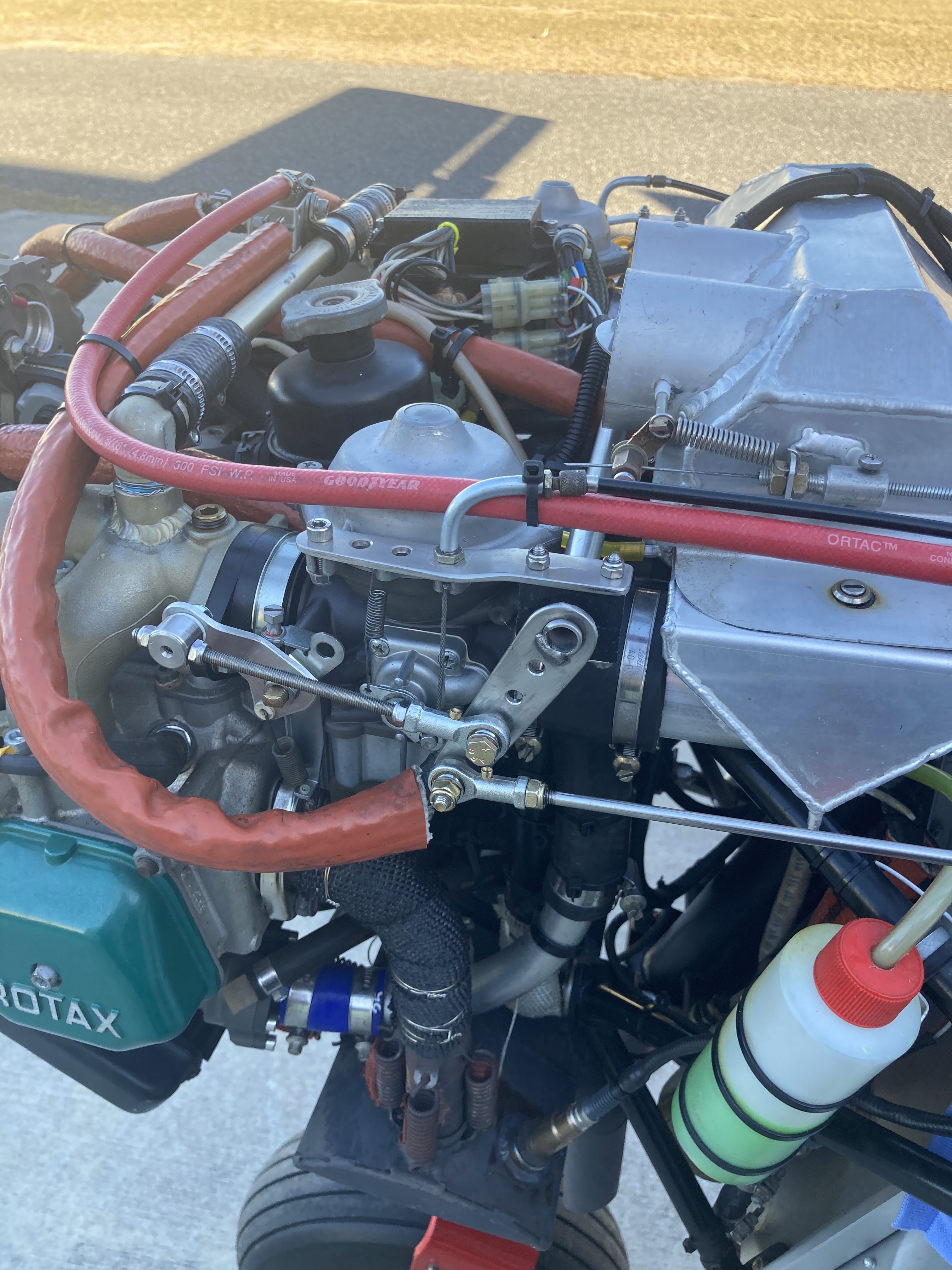

Enrico boto Posted June 18, 2024 Posted June 18, 2024 On 22/07/2020 at 2:32 AM, Kyle Communications said: So how frustrated have you been with the crap throttle and cable system on the savannah?....yeah everyone hates it. Always having to rebalance the carbs and the throttle never tracking correctly with either throttle rod. Well never fear a solution is at hand 🙂 A guy in NZ came up with a new throttle coupling bar system for his savannah. He posted some pics on FB and Danny Leach and I have been looking at it. Danny came up with some further improvement ideas for how to easily mount it all and literally just make it plug and play Pics are placed here and I will upload a quick video to youtube to show the operation of it. We fitted it last sunday and ran the engine and balanced the carbs with a Carbmate. A huge difference now. No slop or uneven carb operation also the carb balance is rock solid. The centred LED of the Carbmate literally does not move now from idle to full power. We were only going to make them up for our small group but there seems to be a big interest in them and so far it looks like we will be making at least 10 sets and thats mostly for Savs but they will work on any rotax engine independent of type of aircraft so we may end up making kits for them. No idea yet on cost but probably not that much. Biggest cost is getting the laser cutting done and some smaller parts that will need to be done on a CNC lathe and the bearing blocks can be made on my CNC mill at home. I was going to get all this done anyway as I have 2 engines to be done and Danny has another engine as well as the one he has just done and a couple of other guys in our group so making enough for 6 or 7 It costs not a lot more really to make a batch or 20 or 30 up. Its just laser time and CNC lathe time. The material which is all stainless 3mm plate and some 1/2 inch stainless tube is relatively cheap..the ball links are not that much each and the stainless threaded rod isnt expensive As a side note you may see a funny looking CDI in the pictures. Thats #2 CDI that was built and tested and still running even though its a 3D printed case for the past 3 years on Danny's Sav... Quick video On 05/08/2020 at 9:57 AM, Paul davenport said: I like your balance tube. Expand Is it possible to buy the system? Expand
