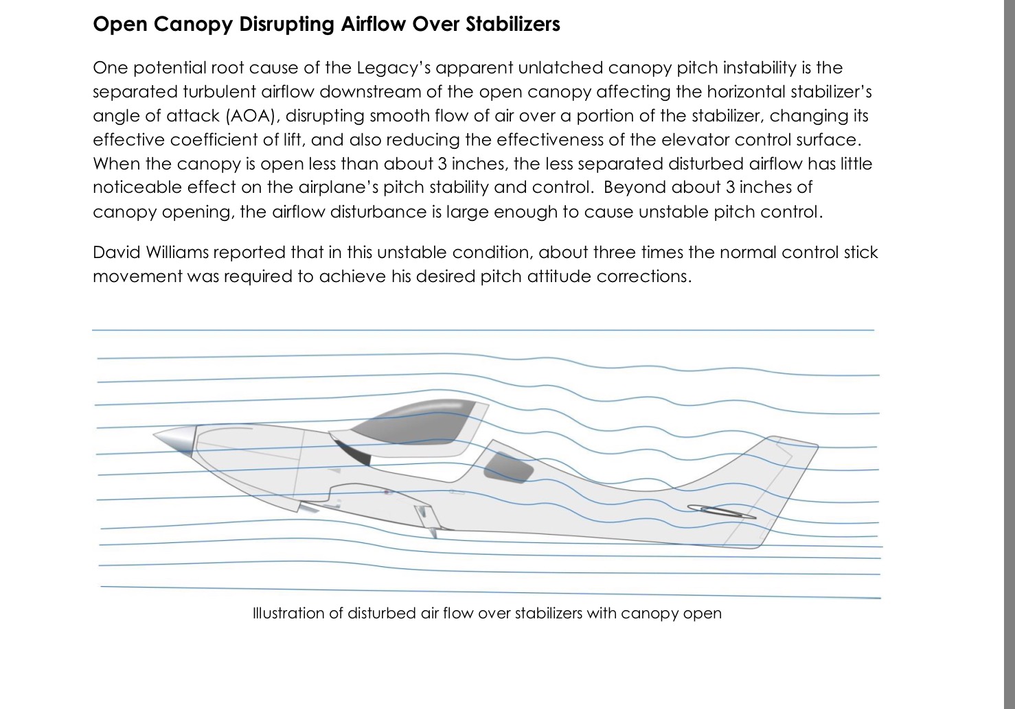

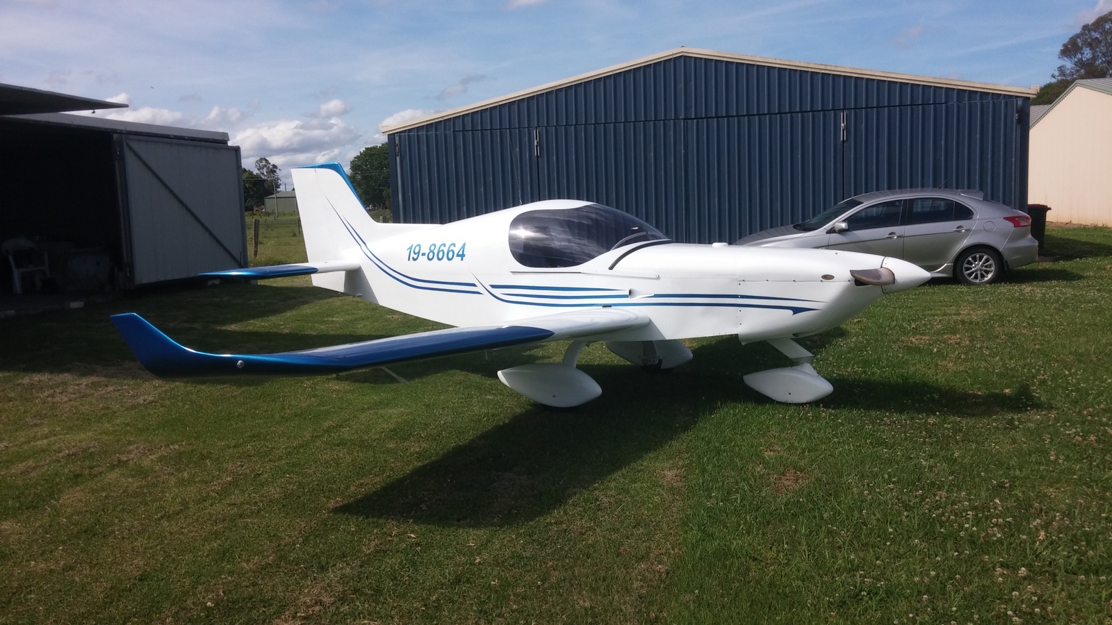

kgwilson Posted August 1, 2020 Posted August 1, 2020 Flightrite said: Better explain that to the families of the deceased Lancair pilots! The Lancair has an internal hinge at about the same forward point on the fuselage as the forward part of the canopy so when it opens air can get underneath easily as the fulcrum is too far back. It is neat and looks nice without any external arms but has these inherent problems. Look at how far forward of the canopy mine is hinged in this photo taken before I installed the fairing. Air forces the canopy down so it stays shut when moving forward without being latched. 2
Flightrite Posted August 2, 2020 Posted August 2, 2020 This says it all! Always liked the Lancair for style but not wirh a tip up canopy and the 3rd wheel at the wrong end. I prefer a slider for cool factor and survivability although obvioisly not guaranteed.

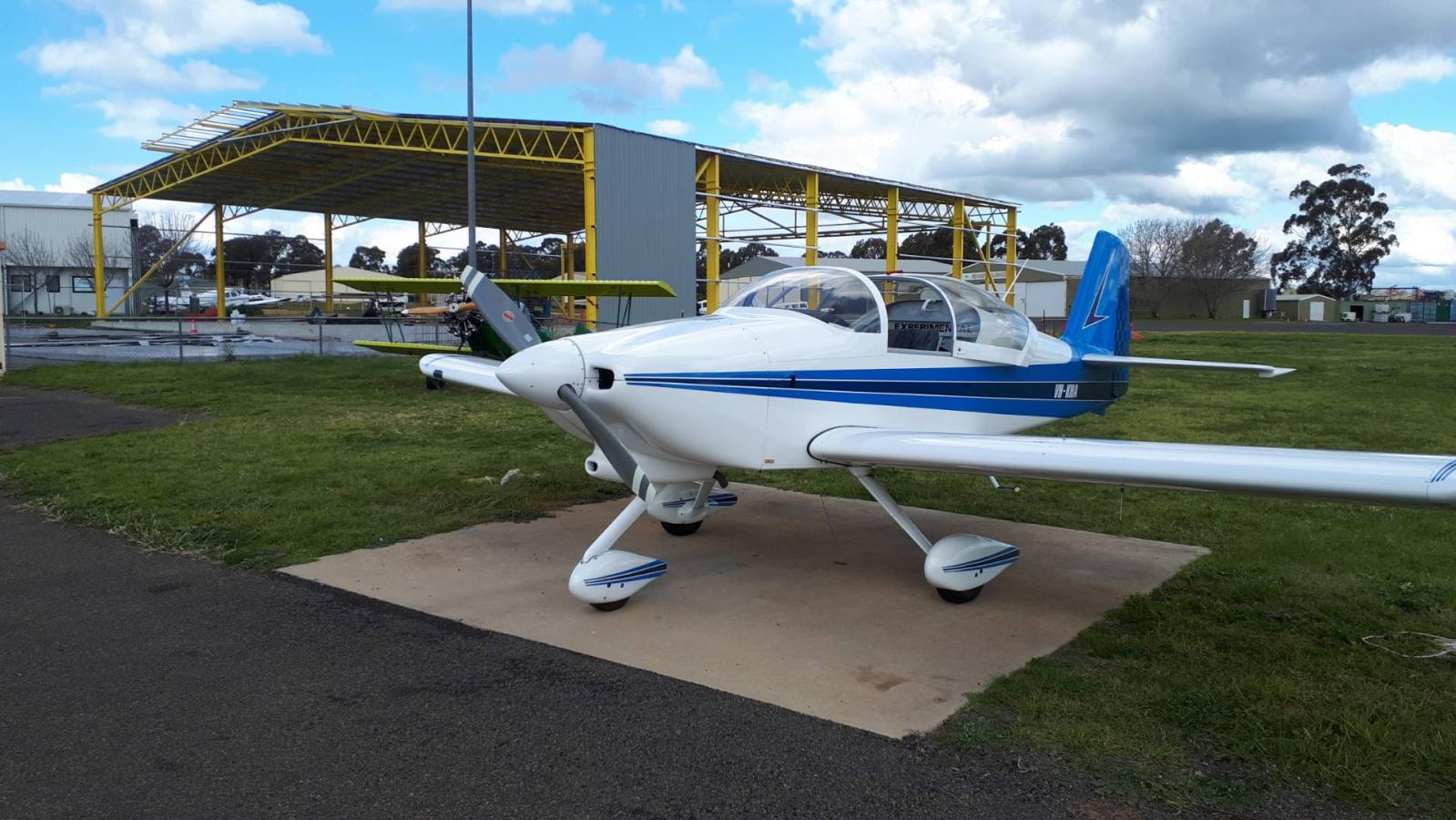

KING Posted August 2, 2020 Posted August 2, 2020 Thruster88 said: I have done a search of the ATSB database for RV aircraft accidents, any serious accident will have been investigated. There are about 500 flying in Australia now so a decent sample size over a long time frame. No serious injury or death that I can see due to the CANOPY, slider or tilt up. The only really safe option is a cessna 172 and keep it in the hangar 24/7. [ATTACH alt=Resized_20200719_133913_9295.jpg]55127[/ATTACH] You’re right with the C172 in the hangar comment. Reminded me of Max Stanley’s quote: The Piper Cub is the safest airplane in the world; it can just barely kill you :) 1
facthunter Posted August 4, 2020 Posted August 4, 2020 Does that comment really make sense though? Anyone who can fly a Cub to it's limits is a pretty competent Pilot.. Nev
Flightrite Posted August 4, 2020 Posted August 4, 2020 KING said: You’re right with the C172 in the hangar comment. Reminded me of Max Stanley’s quote: The Piper Cub is the safest airplane in the world; it can just barely kill you :) Love that Piper Comment, been around as long as the Cub itself?? 1
