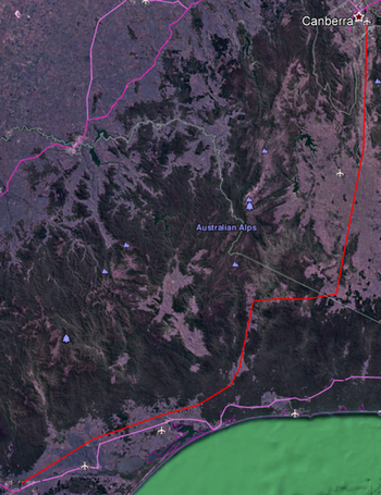

RFguy Posted August 13, 2020 Posted August 13, 2020 When I get a bit of experience there are a couple of routes I want to fly . And the destination is substantially over tiger country (TC). So how to plan if the (single) engine quits. In this case, Canberra to Latrobe Valley. Direct 210nm. (or 8 hours drive) I came up with a route (zig zag) that would put me over RWS as much as possible, along various pastural/primary producer valleys, and never more than 10nm from anywhere that looked like a clearing (without power lines) when over the TC. ..about 250nm. not bad. Weather and other meteorological phenom aside, There is still a bit of a problem with that . Having a 10:1 glide ratio is one thing. But some longer sections of TC , the MSA is still 5500'. Even at 9000' that is a complication. As I see it there are two possibilities, from my extremely limited knowledge : 1) Fly around the TC . OK 330-350nm. 2) For each waypoint, step, one by one, have a continguincy plan , well researched and studied., and for varying WX condix, including that it might take a 180 to get into the wind (or consider alternative ALA for different WX) Seems there is great utility in this case for low stall speed airplanes if you really must land almost anywhere. "discuss" :-) -glen

RFguy Posted August 13, 2020 Author Posted August 13, 2020 Hi Ferris . Yeah the coast is only a little further. below is the mud map. actually down to Delegate, along the Deddick Valley, then down through Buchan isnt too bad , not so high terrain.. I see there is a Class R around Sale. Interesting exercise anyway. Skippy , yeah you live in a really tight envelope. When I have flown (right seat) to Maitland, have gone north , then east to avoid the whole lot.... Do u fly outof The Oaks or Camden ? glen

Yenn Posted August 14, 2020 Posted August 14, 2020 There is no way you will fly direct from Canberra to Latrobe Valley. A large part of that route is in "Designated remote area" Whichever way you go it will be long and convoluted. Start planning by looking at where the remote area is, then the restricted areas you have to steer clear of and the controlled areas or military areas. Then you can pick a route and keep refining it until you are happy with it, but it is not going to be 204 deg, 218 nm.
facthunter Posted August 14, 2020 Posted August 14, 2020 You are OK from Benambra to Latrobe Valley or to Porepunka if you survey it accurately and do a bit of zig zagging... Nev
RFguy Posted August 14, 2020 Author Posted August 14, 2020 Hi Yenn, you'll see I posted what I think is a workable route in this topic. worst case 15nm between possible LZs, mostly 900 to 1500' ASL. essentially down to Delegate, westish along Deddick Valley to where Barry Way hits civilization (if you can call Seldom Seen civilization) , south past Buchan, Nowa Nowa and after that, plenty of choice. Nev, I have driven Omeo - Benambra- Nariel - Corryong quite a bit. As you said " Basically it's weird to trust your life to an infernal combustion engine keeping running, so do that as little as possible. Fly over what you can land on and survive. "
alf jessup Posted August 15, 2020 Posted August 15, 2020 RFguy said: Hi Yenn, you'll see I posted what I think is a workable route in this topic. worst case 15nm between possible LZs, mostly 900 to 1500' ASL. essentially down to Delegate, westish along Deddick Valley to where Barry Way hits civilization (if you can call Seldom Seen civilization) , south past Buchan, Nowa Nowa and after that, plenty of choice. Nev, I have driven Omeo - Benambra- Nariel - Corryong quite a bit. As you said " Basically it's weird to trust your life to an infernal combustion engine keeping running, so do that as little as possible. Fly over what you can land on and survive. " RFguy, I have flown many times over the divide in a Trike and in my Tecnam, depending on what you are flying and what route you are taking & the winds aloft will give you the minutes you spend over no man’s land. Height is your friend, if cloud base limits you you will have longer runs over where the tigers hide. You must know the wind direction as it could be critical if the fan stops, the valley 10 miles down wind might be reachable where the valley 5 miles upwind might not be. It is all weather related, you need probably a minimum of 2500 ft above the terrain to avoid possible mountain wave situations but you can get it higher than that above terrain. I used to fly either 8500 or 9500 depending on the direction you are heading you also must remember you are up there with IFR traffic with 500ft separation so be disciplined with your heights, at those heights it used to give me a far greater gliding range and in the Tecnam I’m usually no more than 3 minutes over no man’s land, mind you I was always aware of wind direction and track, I just stayed within gliding range of a reachable valley. At the end of the day it is a calculated risk if the fan stops, you just have to have a disciplined plan and stick to it. The odds of the engine stopping is minimal, just don’t be blaise and direct track over long areas of Tiger country, crossing the divide has a lot more options than some may think. 1
