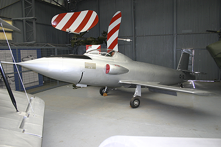

Why go to the trouble of fitting out a Jab for drone work. All we have to do is dust off the plans for the Jindivik, GAF Jindivik - Wikipedia Replace any 20th Century radio control gear with 21st Century stuff and possibly look at weight reduction by using fibreglass or other composites in the construction. Originally the Jindivik had a MTOW of 1451 kg, so there should be some Jenny Craig results possible. Since the idea is to use it mainly as a weapons delivery system, it's going to be a one-way flight, so it doesn't need to be built to last for years. Also, modern turbo jet engines would have to be better than the Rolls-Royce Viper Mk.201 that powered the Jindivik.
But wouldn't you like to fly the Jindivik's sister, the Pika? RAAF Museum: Hangar 180: GAF Pika

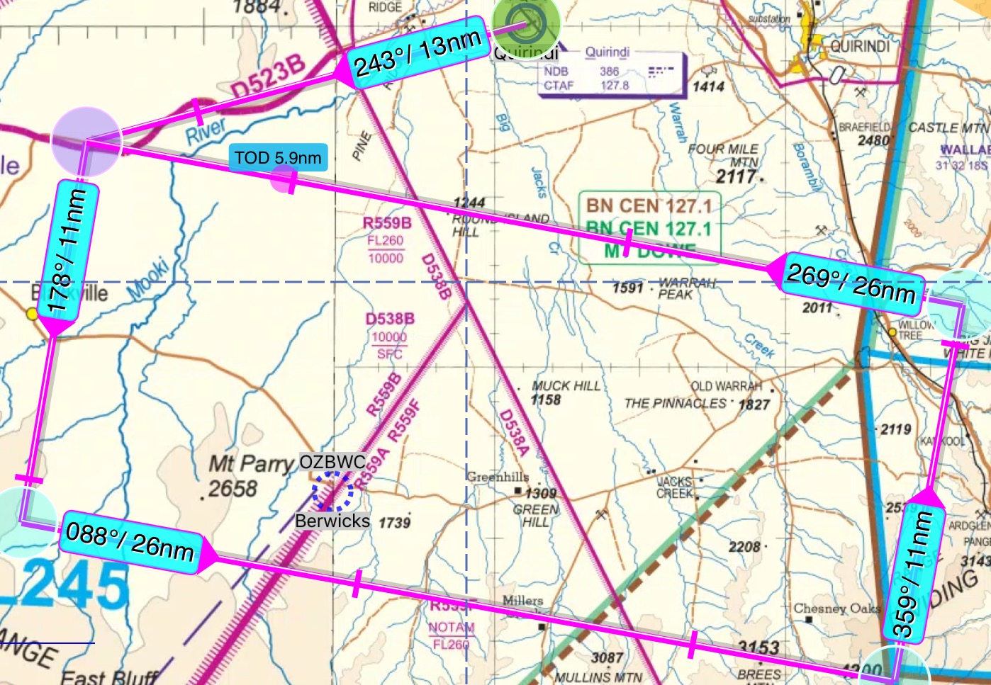

Here's yesterday's flight plan (which was cut short when my ancient iPad lost the 3G signal):
This rectangle follows the 1832 suveyor's lines (as closely as I could get using Google Earth and maps).
As you can see, there's been a 1-2 degree shift, which is barely perceptible given actual flying conditions.
