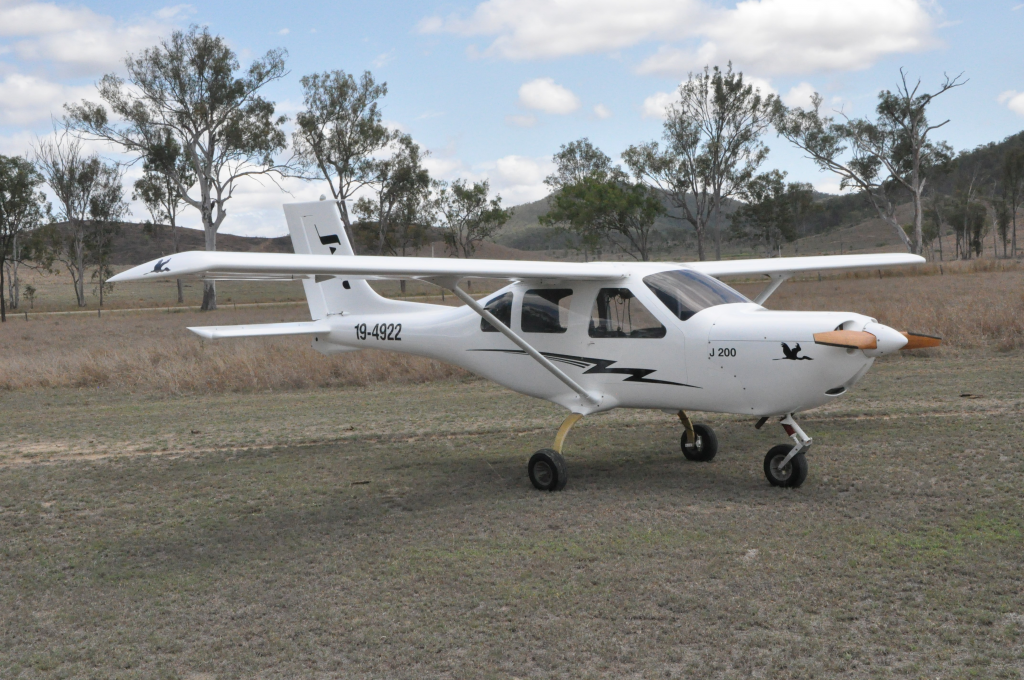

Seems 200 is a good first plane, and 19- ripe for experimental work. (aside from 19- LSA, SK)
Why are all the J200s I can find all 19- ? were they all factory kits ?

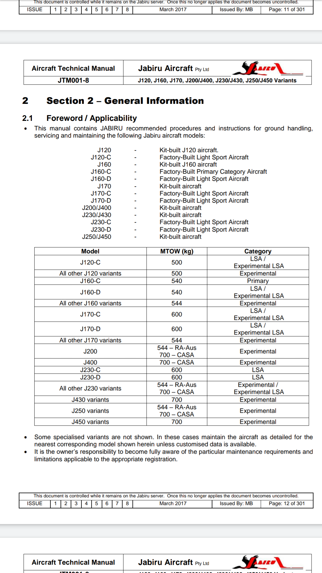

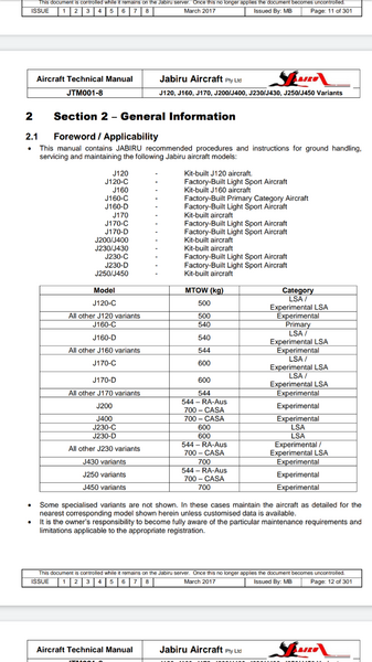

The J200/400 were more aimed at the VH market as they suffer from higher stall (over 45kts) speed and lower useful load of about 195 Kg when built as an RAaus A/c at 544Kg.
So the 230 was produced, more wing area, to get to 45 kts and 600Kg. I do realise that there are some old J400 converted to RAaus and sneaked in at 600kg but they were self certified and may not actually pass the stall speed at Max AUW if ever tested.

I'll end up getting a 24- J120 for starters most likely. affordable and will help me get some feeling for what I really want to do. Seems I cannot get away from having to build a kit, and get tit RAaus authorized and signed off for op in CTA. and 500-1000 hours to build an aircraft I do not have for the stepping stone to modify aircraft for engine instrumentation purposes . "Modify" of course is a variable definition. Spock would not like that.

back to the J200 and the 19-x question.
By the book, if you build a 19-x, once you sell it, the advantages that you had been the builder would seem to be lost, which would limit their appeal to some buyers. Is my interpretation of the situation close to the mark ?
