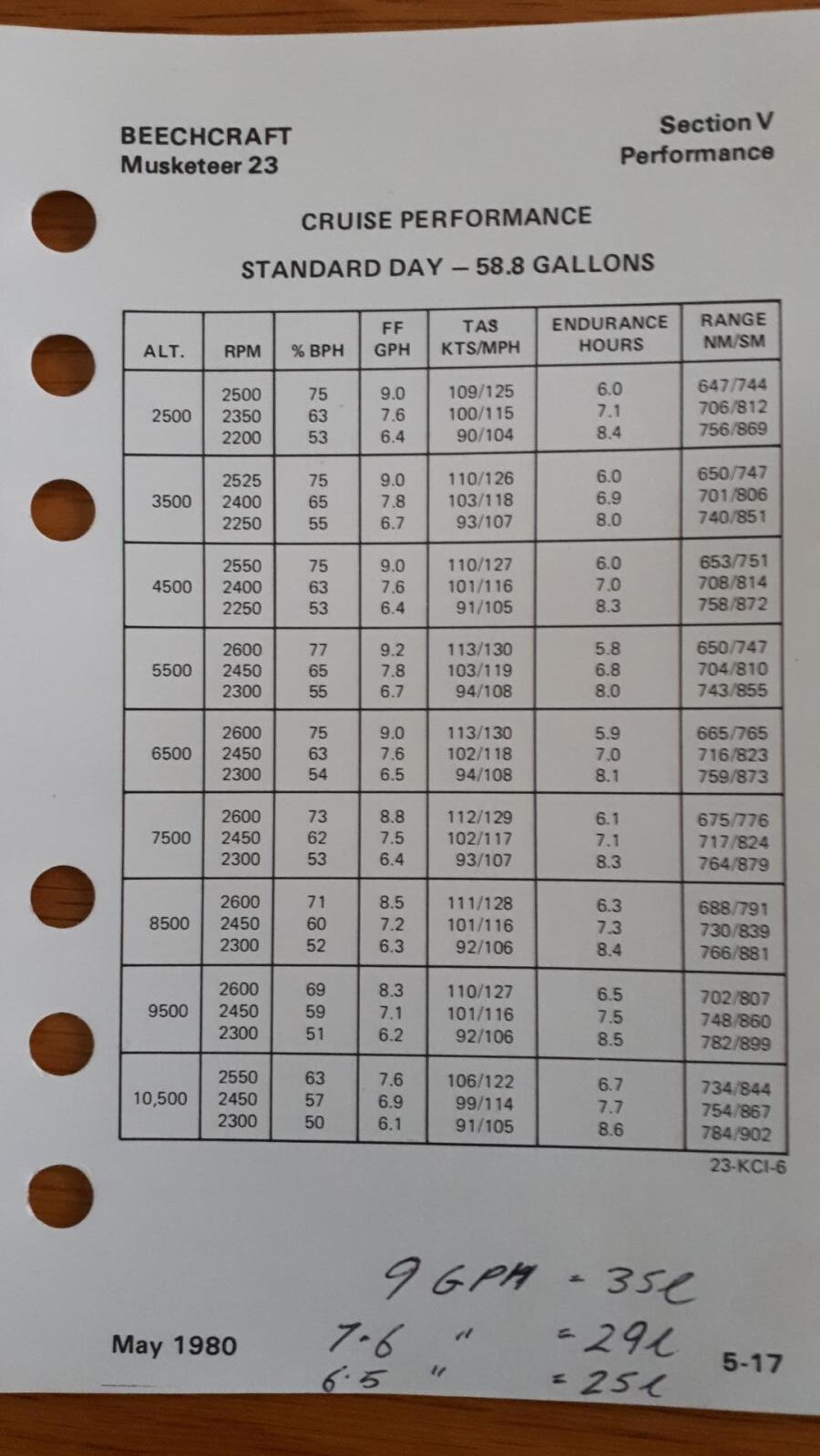

NT5224 Posted August 21, 2020 Posted August 21, 2020 That’s what the bloke said. ‘You should waggle your little red knob better’. He was in his eighties with 60 years of flying everything from fast jets to commercial multi engine in his logs. When he spoke I listened. The question was around achieving peak fuel efficiency in cruise, and by implication he was suggesting I might not be optimising my mixture settings. So I’m interested to know how much a well leaned mixture should save on fuel flow? So ladies and gents. Let’s assume a cruise at about 30 litres per hour, 5000 feet. If mixture is leaned correctly, what reduction in fuel flow might be achieved? Just rough approximation will suffice. 1 litre? 3 litres? Or even more? One more thing. I was always taught that leaning was only necessary over about 5000 ft where the air density becomes significantly lower. This made sense to me because when you lean you are maintaining the optimal fuel/ air ratio, and that ratio begins to change the higher you get. But my experienced friend said that you could adjust mixture at any altitude. Thoughts? Alan

Thruster88 Posted August 21, 2020 Posted August 21, 2020 That’s what the bloke said. ‘You should waggle your little red knob better’. He was in his eighties with 60 years of flying everything from fast jets to commercial multi engine in his logs. When he spoke I listened. The question was around achieving peak fuel efficiency in cruise, and by implication he was suggesting I might not be optimising my mixture settings. So I’m interested to know how much a well leaned mixture should save on fuel flow? So ladies and gents. Let’s assume a cruise at about 30 litres per hour, 5000 feet. If mixture is leaned correctly, what reduction in fuel flow might be achieved? Just rough approximation will suffice. 1 litre? 3 litres? Or even more? One more thing. I was always taught that leaning was only necessary over about 5000 ft where the air density becomes significantly lower. This made sense to me because when you lean you are maintaining the optimal fuel/ air ratio, and that ratio begins to change the higher you get. But my experienced friend said that you could adjust mixture at any altitude. Thoughts? Alan Alan, we will guess that you have a 160hp 0-320 lyc. 30lph agrees with the Musketeer's performance chart for 65% power. It is 160hp and achieves 2350 static rpms with a 74x60 prop. This chart will give you a rough guide to power settings, you may be able to get a more suitable chart from another aircraft(propeller and cruise speed). As others have said, lean any time with 75% power or less. At 65% power you can not hurt this engine with a lean mixture. Lycoming have good operator manuals describing leaning, carb heat etc. 2
