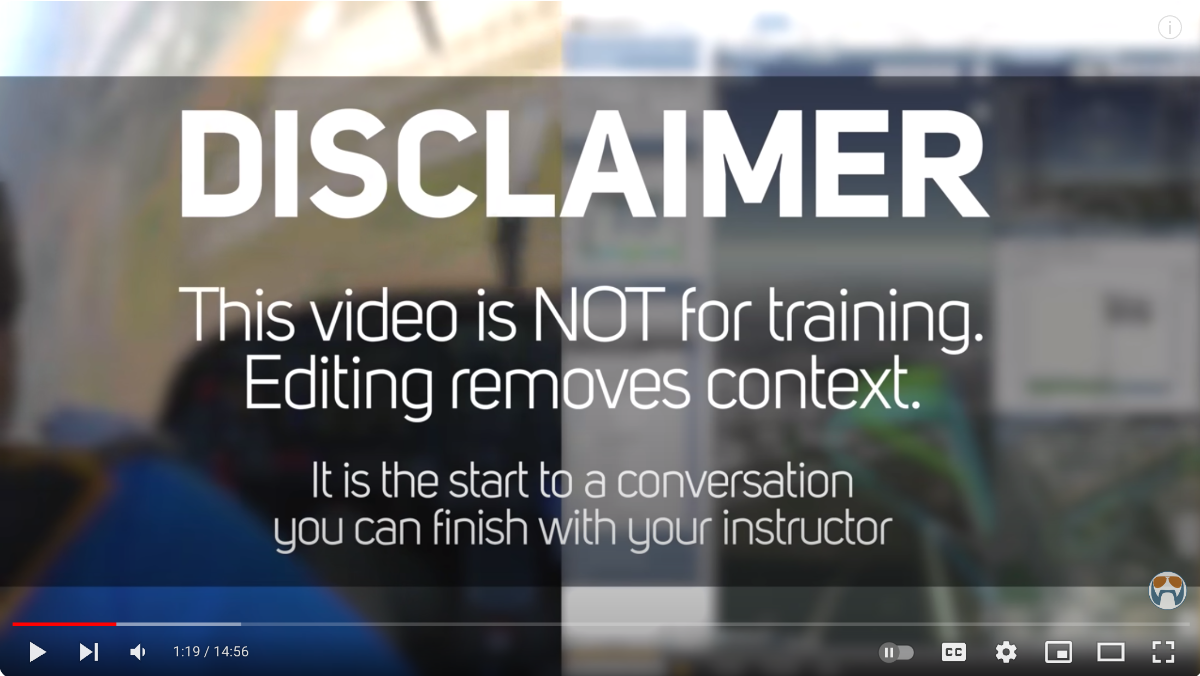

facthunter Posted April 21 Posted April 21 (edited) Go to their last bit of advice. Get in touch with your instructor. What was demonstrated there was very basic and obvious. Generally discussion on line creates more confusion. IT should be called the unforgiving turn, which they sensibly have. Nev Edited April 21 by facthunter 1

turboplanner Posted April 21 Posted April 21 On 20/04/2024 at 3:59 PM, Garfly said: I agree. FlightChops too, emphatically: Too late, the information’s out there and some people will do it now.
