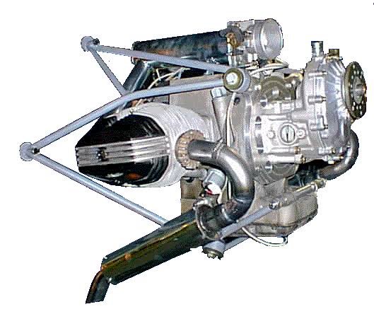

Thruster88 Posted October 5, 2020 Posted October 5, 2020 Another good option is the BMW motorcycle boxer twin with a rotax C gearbox. I have flown a thruster t500 with this engine and it was smooth and similar performance to a 582. 1 2
Wirraway Posted October 7, 2020 Posted October 7, 2020 On 05/10/2020 at 1:08 PM, Thruster88 said: Another good option is the BMW motorcycle boxer twin with a rotax C gearbox. I have flown a thruster t500 with this engine and it was smooth and similar performance to a 582. Can you give any info, please, on how old the engine was when it was installed, reliabiloity, TBO etc, etc. There was an a/c for sale 12 or so months ago with a BMW engine, don't think it was a Thruster though. Thanks
Thruster88 Posted October 7, 2020 Posted October 7, 2020 22 minutes ago, Wirraway said: Can you give any info, please, on how old the engine was when it was installed, reliabiloity, TBO etc, etc. There was an a/c for sale 12 or so months ago with a BMW engine, don't think it was a Thruster though. Thanks It was along time ago 2000? and i have no knowledge of its history. Unfortunately it was damaged shortly after I flew it and shipped off to Tony Hayes for repair. I don't know what became of it. My feeling is it would be a good thing re reliability. It would not be legal for a Thruster, not sure if approval can be achieved. 1

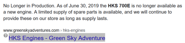

pluessy Posted December 28, 2020 Posted December 28, 2020 FYI, Pete Plumb (O-100 creator) has passed away a few months ago. The O-100 project might continue if there is a suitable buyer for the IP and tooling/processes. 1/2 VW output ranges from 28hp (840cm3) to 45hp (1200cm3) and weigh arounf 39kg (single magneto, direct drive, without electric start and alternator) to 47kg (direct drive, dual ingition, starter & alternator) So, if you are looking for an alternative for the 1/2 VW, there is very little out there in that hp range and weight. HKS 700E (55-60hp), Verner JCV-360 (35hp), Hexadyne P60 (60hp), Jabiru 1600 (56hp) and a few more have all gone down the gurgler. The Kiwi design Aviator HFA seems at a standstill since 2015. The few options in the 4-stroke 25-40hp range are converted industrial V-twins, either direct drive or with re-drive. There are a couple available complete from Europe, primarily designed for powered chutes and hovercrafts.
spacesailor Posted December 28, 2020 Posted December 28, 2020 I have heard (maybe just a rumour ) that the HKS 700E motor was recalled for a defect. Don't shoot the messenger !. spacesailor
