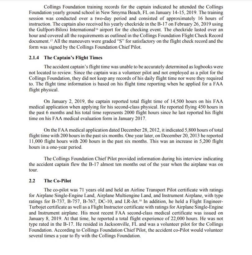

old man emu Posted December 26, 2020 Posted December 26, 2020 The NTSB report on this fatal off runway excursion has just been released. 1
onetrack Posted December 26, 2020 Posted December 26, 2020 Did anyone read the full NTSB report and pick up on the odd part, as regards the Captains hours, in section 2.1.4? Juan Browne skipped over this, and maybe he shouldn't have. "Oversight by the FAA", sure explains a lot. They left out "Lack of".
