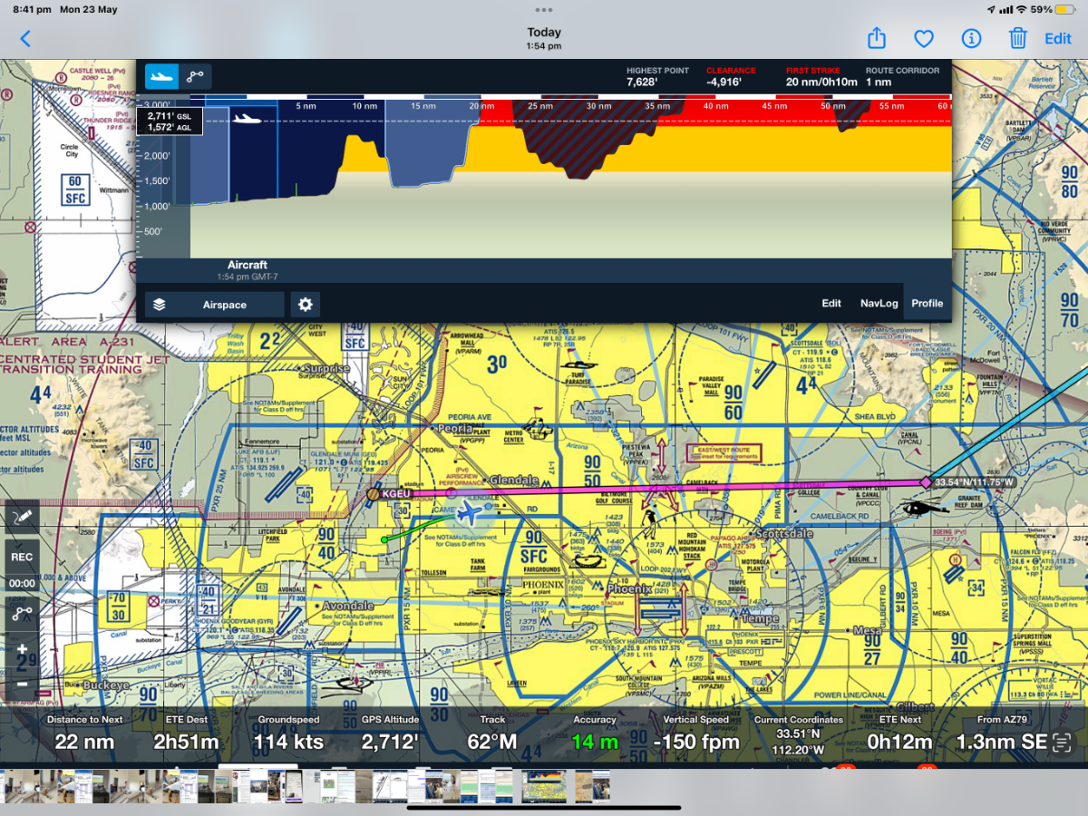

I had my first prop stop a week or so ago. Caused by a combination of factors. Took off from a towered airport with Phoenix airspace nearby. First problem. After take off I couldn’t hear controller. Something had happened to volume. Wasn’t my Bose A20>…. As I was cleared for an easterly departure I turned east. No nav screens in aircraft so I was relying on iPad. No aircraft displayed on the iPad. Had no idea what airspace I was in. Finally figured that ForeFlight open in both iPad and iPhone gives priority to one only. Avplan in Australia I’d not experienced this. Turned off the iphone. Found my aircraft in what a glance said was Phoenix airspace. I took a screen shot as you see so I’d have evidence of exactly what happened. I worried all the way to Moriarty about the “phone call” until later realising I wasn’t in their space…screenshots… good!
These two things, missing tower call and navigation problem rattled me. Recovered and full tanks of fuel for a 3 hour flight with tail wind to New Mexico and ground speed of some 125kn. . Left tank only with rotax line return to left tank and my side of aircraft so get the weight sorted. Turned tanks at 30 minute intervals as recommended.
Next problem… late departure due to getting wings on aircraft (inexperience) meant a really rough ride and speed drops down as low as 70kn and dust devils to avoid and light rain following behind and I missed tank change. Ended up pumping fuel out of the left tank.
Prop stopped over some pretty nasty ground west of Albuquerque. I must have spent a full 5 seconds pushing the throttle backward and forward looking for rpm change. Too long in my opinion now… anyway, turned off right tank and on left tank. About 20 seconds later I had power. To leave right on would just suck air. Pipistrel,forum mentioned this and I knew it. Then, to make sure the problem wasn’t elsewhere and I’d need an emergency landing I repeated. Prop,stopped and 20 seconds later I’m confirmed with problem and a full left tank to proceed.
